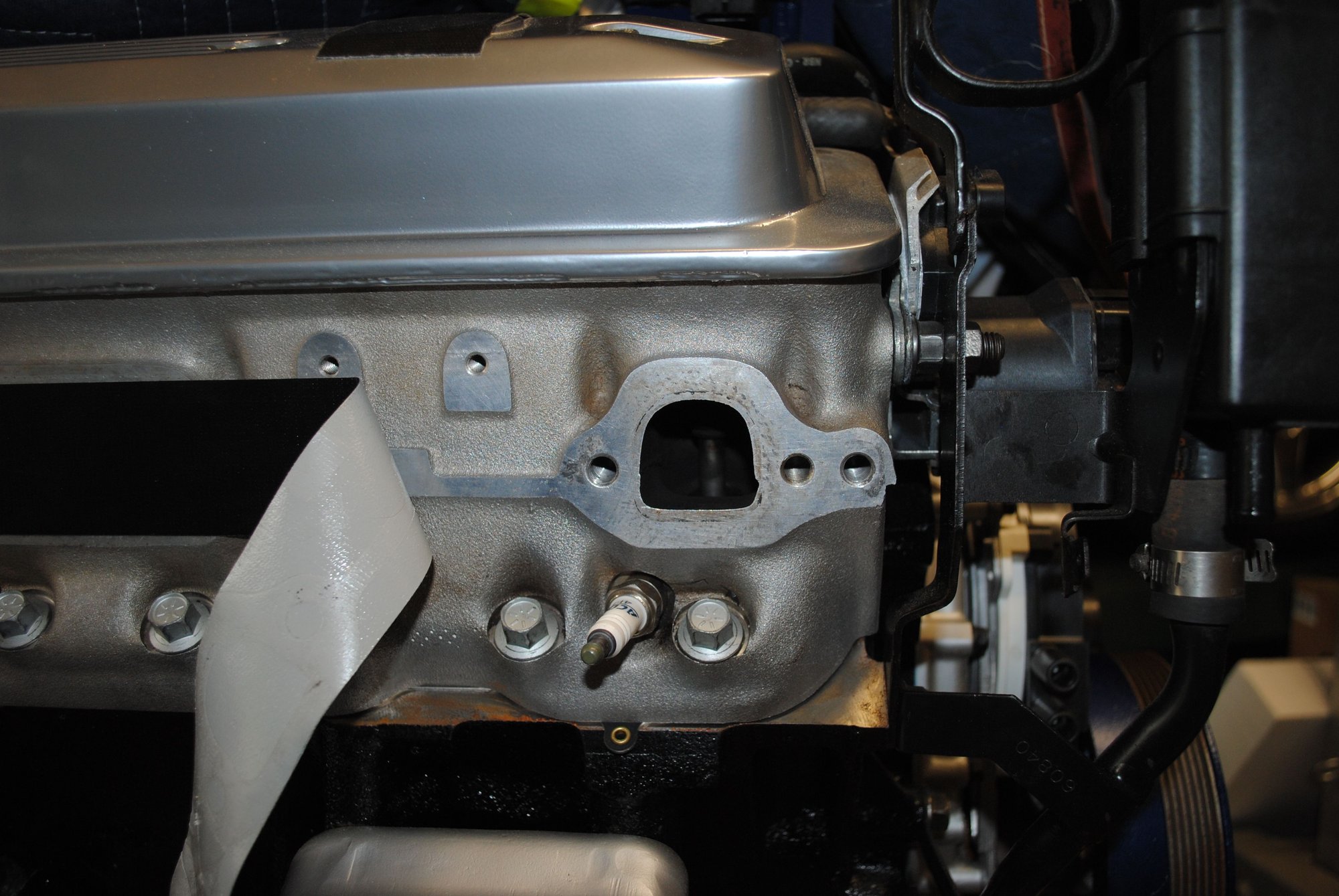

This photo is for Dyno Don:
I'm just making sure his headers fit my LT1 aluminum "D" port heads. Yes they will bolt up, but I'm just making sure the outside (#2,1,7, and 8) ports are not too different.

The best header design is one that has the opening larger than the port in the head.
This way it will stop any reversion back into the cylinder.
The 29DA3Berl gasket fits the header flange perfect and the LT1 head also.
