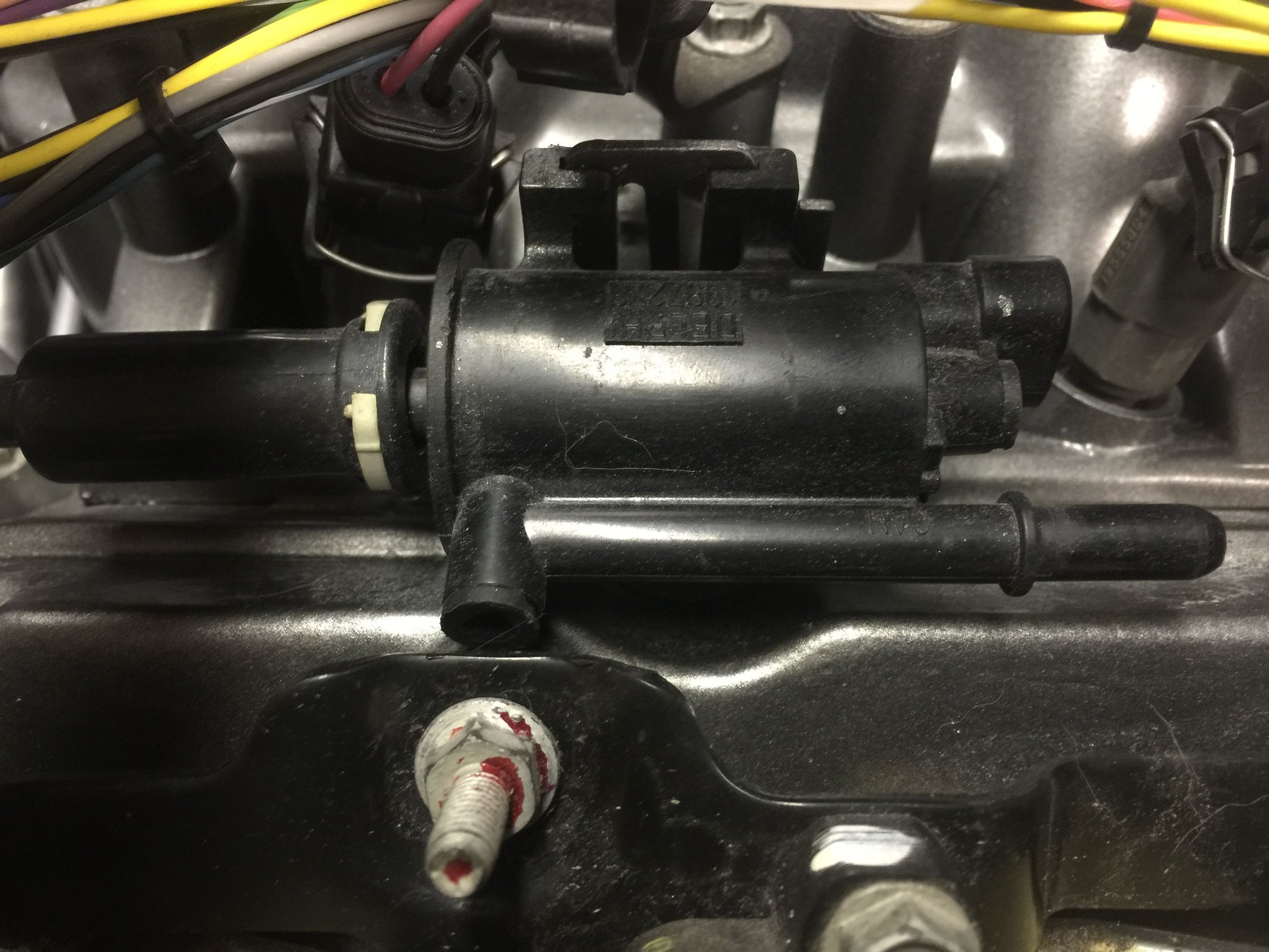

Does this piece stay or go? LS1 swap...
There isn't a wire for it in my painless harness so I'm assuming it serves no purpose, correct? Can I remove it and plug the intake? Or does it need to stay?

Its the Purge solenoid for the charcoal canister. Emissions stuff.

I've got mine setup to use it (not using a painless harness), it's called a purge solenoid valve. If you have the charcoal canister setup to be used, it needs to run to this valve, so it's not receiving vacuum all the time. If not, ditch the valve.
That's why I don't remember it, it got chucked in the trash lol.

Thanks for the help... I yanked it off since I won't be using a charcoal canister

Stupid question probably, but if you remove it, do you need to place a cap of some sort where it connect to the intake?
