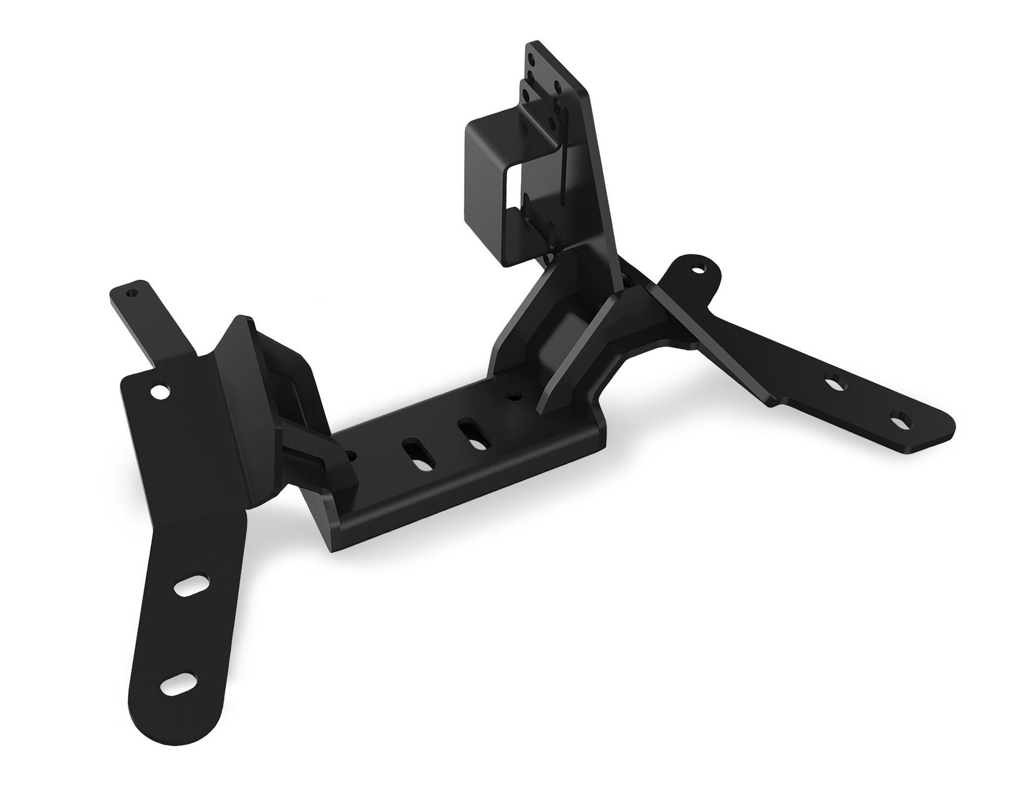

Has anyone used Hooker's LS/T56 swap crossmember?
https://www.holley.com/products/exha...ts/71222005HKR
I'd like to see some installed pictures.
This particular part number is designed for the swap mentioned and also "to accomplish an LT1/LT4 T56 transmission swap behind a Gen 1 SBC engine."
Which is not exactly what I'm doing but should work nonetheless. Sort of.
Clearance around the exhaust is what I'm most interested in.

Here is the development thread that was posted here. Toddoky is the engineer for Holley who designed the system
https://www.thirdgen.org/forums/ltx-...roduce-lt.html
Bad used Hookers engine mounts that the trans crossmember is designed for.
If you are using a different engine mount setup, then it may not work.
I know Qwktrp tried to use it as a stand alone and had a issue with the torque arm mount hitting the reverse lockout solenoid.
https://www.thirdgen.org/forums/ltx-...ml#post6000127
In the development thread that was posted about the whole Holley system, they did successfully use that crossmember on a car with an L98 that they swapped in a T56.
https://www.thirdgen.org/forums/ltx-...ml#post5999662

Thanks for that Jay. I think I've gone through those looking for bits of information.
I've also been in conversation with Toddoky about this adaptation and he has contributed to a couple of my threads and answered a few questions.
He jumps in at the end of this thread. Post #554.
https://www.thirdgen.org/forums/exha...xhaust-12.html
Maybe you'll find something useful there for your project.
As it is, I'm adapting outside of their described application in that I'm installing a differently cased 4L60. It's measurements are very close to that of a TH400 or 200R4.
I was ready to pull the trigger on this however what I've found is that my current y-pipe has 100% interference with the crossmember at it's lowest point.
Now it's a question of what I'm going to do about it. Personally I'd rather keep my exhaust and build my own crossmember to suit but it's sort of like six of one, a half dozen of the other. I need a new exhaust system in it's entirety. It's just that, like you, I have a few other "irons in the fire". For now, I'm going to limp around using the crossmember adapter that I've built. It's not designed to take any abuse but it will allow me to be mobile. That may open options for me regarding what I'll do next.

This what I'm up against.
The picture below shows where my "new" transmission mount is going to be . (Moved from the transmission case to the extension housing). My y-pipe is smack in the middle of the crossmember.
At one time, I was managing a small chassis shop . This sort of thing was routine for us. Unfortunately, I've since left that and I don't have the resources available any longer. The y-pipe you see in the pic below (although old and beat up now) and the crossmember were all produced in the shop. I'd hate to cut the pipe up because as a system with headers, y-pipe, cat back and crossmember it's a drop in replacement for anyone looking for an upgrade.
Circled in red is where the rear transmission mount is going to be located.

I think the only people that have had fitment issues with the crossmember have been using the BMR tubular K member for their LS swap with a T56. This moves the motor back about 1/2 inch and the Hooker crossmember hits the transmission case. As long as your motor is within 1/4 inch or so of stock, you should have issues with the crossmember hitting the transmission. It does look like your exhaust will need to be modified though based on where you're saying the mount will be.
Old Feb 28, 2017 | 11:43 AM
skinny z's Avatar
Joined: Dec 2005
Posts: 9,920
Likes: 885
From: 53.0907° N, 113.4695° W
Re: Hooker Crossmember Questions
Talking with Toddoky, he's provided the exact dimensions for the LT1 and LS1 T56's as well as that of the TH400/200R4 which is similar to but not exactly as mine. I can leave my OEM mounts in place on the Gen 1 small block and deal with the fitment from there. I'm off by an inch and a bit and the crossmember would have to have the trans mount holes slotted. But, as you saw, the pipe is the deal breaker here.
