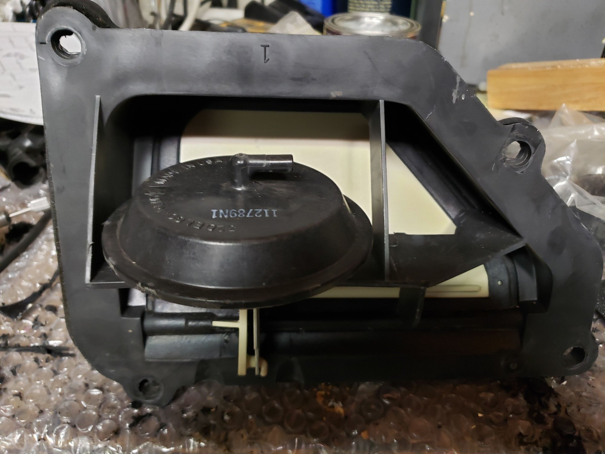

On the upper right side the old air re-circulation door was mounted with 4 screws it a trapezoidal shape this let the cabin air back into the blower fan and blocked off the cowl vent when on recirc. you need to install a block off plate to seal the cowl off from the cabin. I made mine out of 3/16 aluminum and reused the gasket off of the old recir door. In this picture I'm holding it upside down. If you look at my pictures I have it covered in sound deadener and my PCM is mounted to it

Is this the area you are talking about?

I see what you are saying now. Good catch!

Looks like I will have to take the dash back out to put a patch over that cowl gap (shout out to 355SS). I also cannot get the fuse block to bolt in with the dash in place. My man hands are too large and there are too many wires weighing it down.
I dug through the old HVAC set-up and I cannot find that feature that matches what I need to patch. I looked at the stuff under the dash as well as the giant HVAC/blower fan that resides on the firewall.
355SS, you wouldn't have a picture of that OEM feature would you?

Found it. Should be an easy patch.

I was going to look for it last night but had too many things gong on. i used the gasket as a template and then reused it to seal up the plate I made

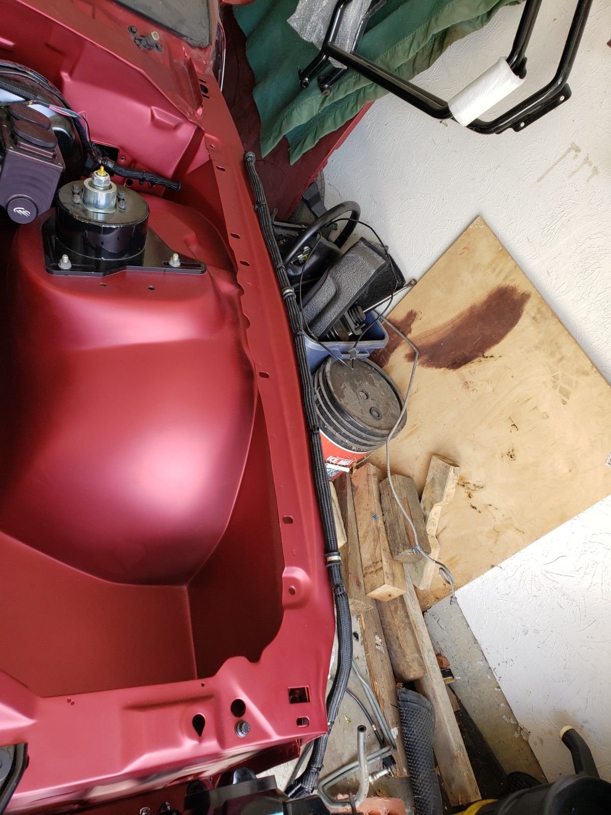

I bought a spare headlight chassis harness and stole most of the wires out of it to extend my harness. I finally have it routed to the C100 and just need to plug it in once I take the dash out and get the fuse block installed (along with the C100 from the inside. I was going to run it through the fender frame rail but decided to go the way DSE went.
This was a PITA to cut, solder and heat shrink, but it was worth it in the end.
I will run the fan signal wires, and relocated windshield fluid pump wires down the other fender.
The ridge in the fender will cover this perfectly.
Fan fuses tucked under the bumper rail in case I never need to get at them. The two loose wires are for the fender lamp.

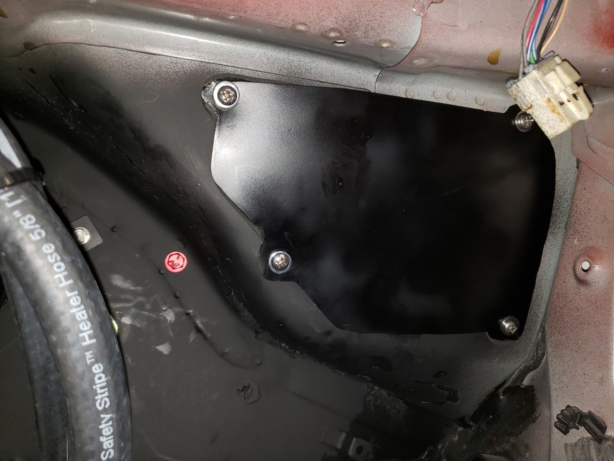

Rerouted the windshield washer fluid lines and wires and also made my patch panel per 355SS's guidance. I owe him an oat soda.

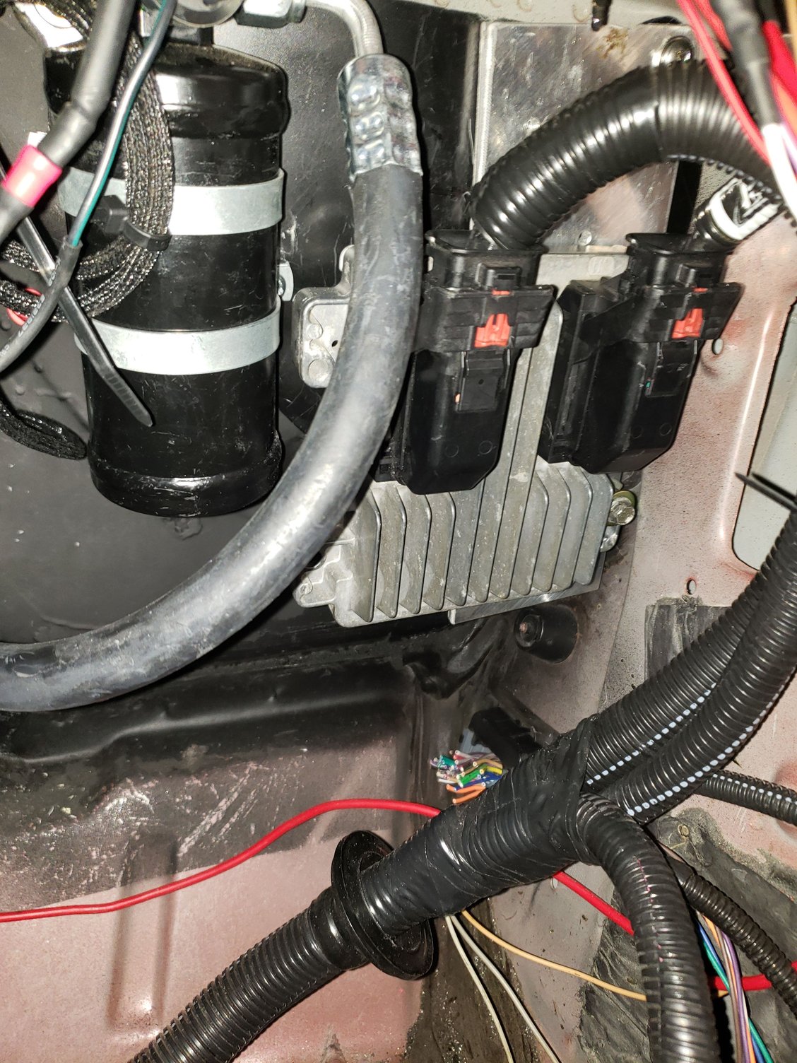

Well the dash is back out and the patch panel is in place. I also fabbed up my AC lines and I'll get them crimped this week. I could not get my #10 AC fittings into the #10 Parker AC line​​​​. I bought everything from Vintage Air but their #10 hose has an 1/2" ID. I need 5/8" for #10. Anyone have anything similar?
Patch panel reusing the OEM gasket.
Dryer put in place.
Under dash AC lines.

Couple more updates here. I was able to get my AC lines crimped at a local semi refrigeration service facility. I forgot how rigid AC hoses are. I got them installed under the dash but it was a royal PITA. The lines under the dash along with the engine bay connections are causing the firewall to bow a little and distorting the top line on my bulkhead. I'll have to see if I can relieve that some because I don't like the way it looks. If I had to do it all over again I would have ran the AC lines through the fender and or through the wheelhouse.
I also figured out how to run my RPM cutoff switch for the AC compressor. Sanden says the SD7's can run to 9k RPM, but typical front accessories ratios hit that RPM when the engine is around 4 to 5k. I looked at many different window switches for nitrous control and they all had their limitations. I snooped around on Holley and found that they recommend the NOS RPM controller. So I ended up going with that. I will be able to wire the AC switch from the VA unit to the NOS controller, and then the controller to the trinary switch. The nice thing about the NOS controller is that I can take the tach signal right from the E38 ECM and wire it directly to it.
I've also been laying out my battery wiring. I will be running 1/0 gage from the battery to under the dash and 2gage to the starter from a junction. I will run another 2ga from the alternator back to the battery, all wired with an engine kill switch.
I made a few brackets for the DSE battery box. I have it mounted in place but will clean this area out and get some dynamat in there.

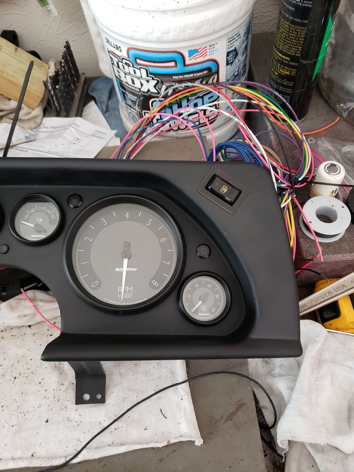

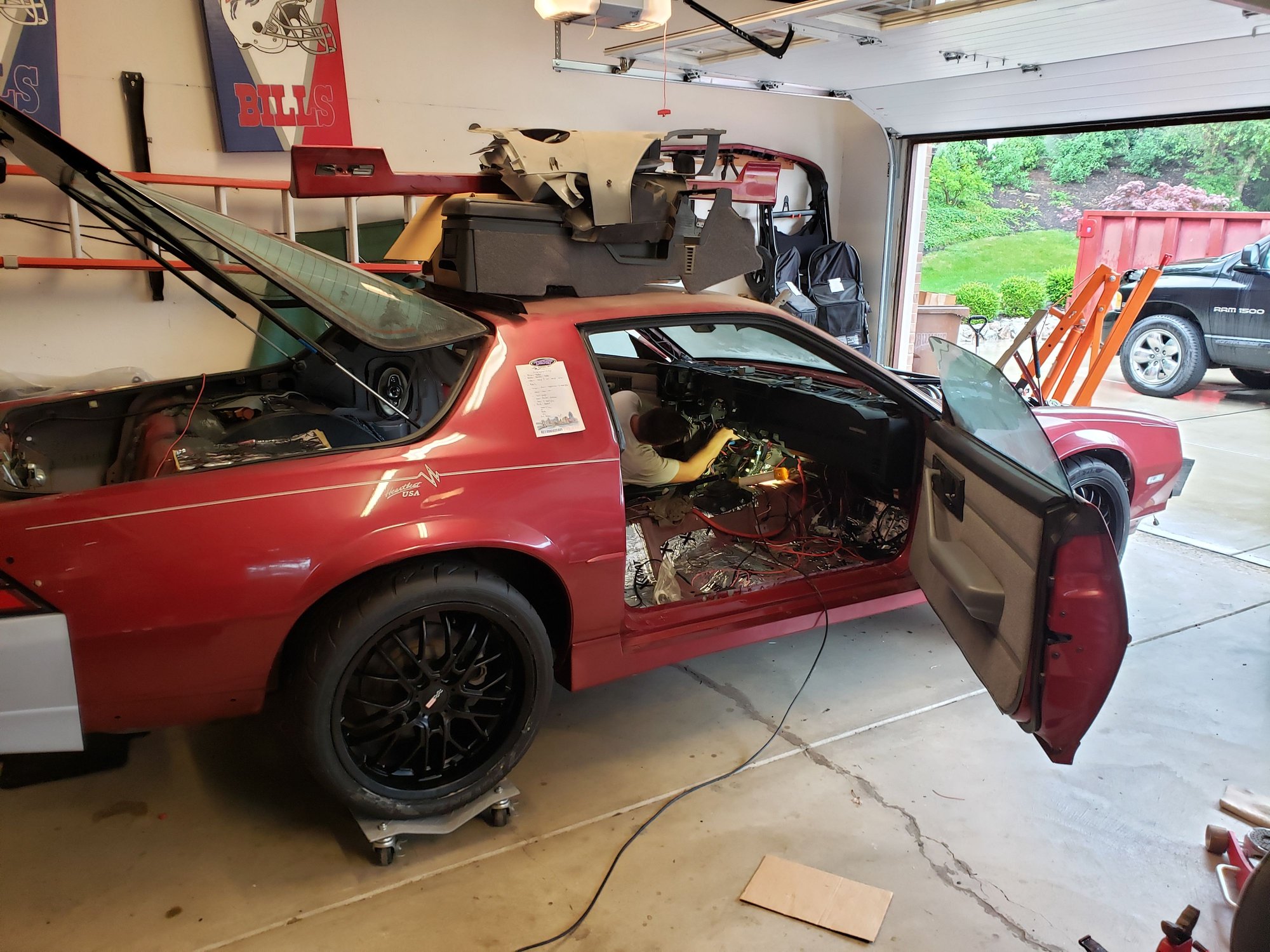

The dash is finally in and my wiring is much more organized and well thought out. I did break off one of my VA ducts during the install but I refuse to take the dash out again to fix it. I think I can get my arms in there to get it back in place.

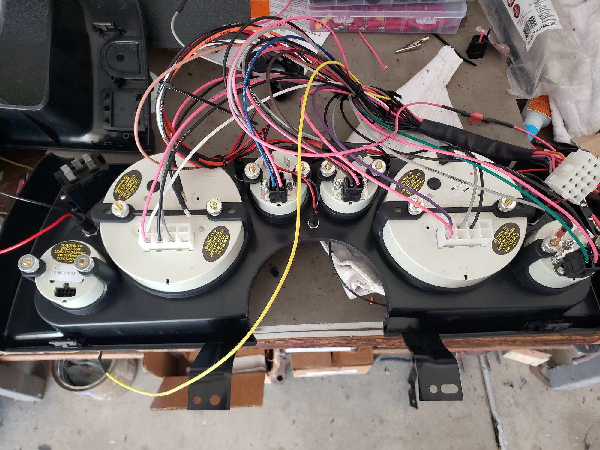

I have been spending a lot of time wiring up my gages and tapping into the gage cluster power and ground circuits. I have also tapped into the turn signal and bright indicators as well. After doing all of this I realized I never ran power back to the fuse block and or ignition switch. Oops. I should be able to tap into the A4 and G5 C100 wires under the dash and route them to a junction.
Made a bracket that ties into the OEM HVAC mounts. I used LS1 Solutions to flash me a basic LS3 tube on an E38 ECM. This should allow me to fire the car and get it to the dyno.
Not sure why classic industries placed the mount for the rear defrost at this funky angle, but it works and is sturdy. I made a tiny little ABS bezel to clean up the cut I had to make.
Rear view of the switch mount

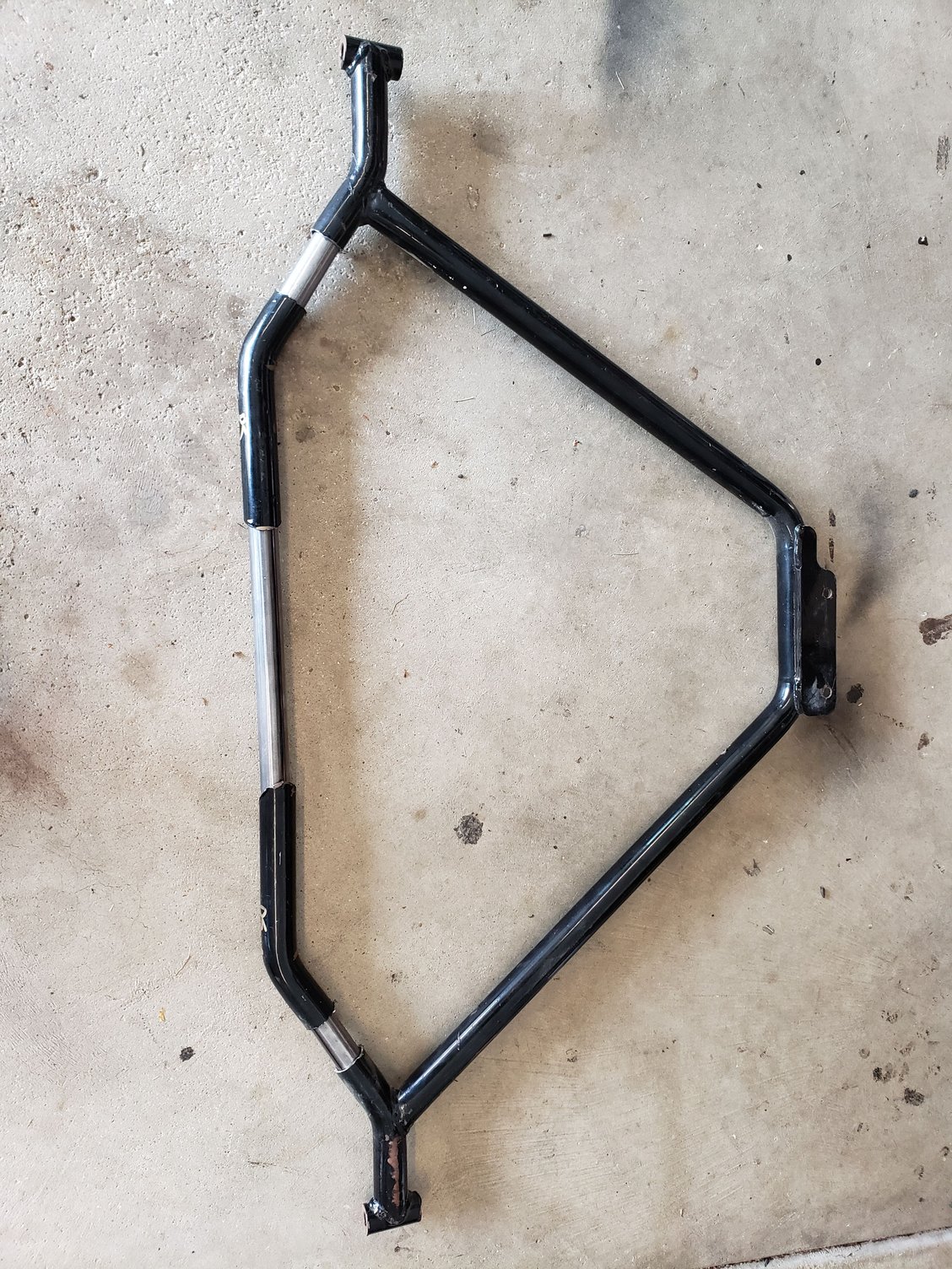

Another issue I ran into was my Edelbrock TBI strut tower brace. QA1 now owns the manufacturing of it and is identical to the Edelbrock unit. My FAST intake is too close to the firewall and I could not run my MAP sensor back there. I was forced to put it at the front of the intake but the STB comes into contact with it. I have two of these STB's so I took my old one and cut the front bar and pieced some tubing in place to telescope out the front bar. I started welding it up but my welder is garbage and I will take it someplace where they can tig it.
Interference, and shimming it changed the mounting geometry too much.
For the test fit I used my 20 year old STB to cut it and telescope out the front to take it past the intake manifold.
The sliders will be replaced with 1.25" tubing and will look seamless after powdercoating.
Although I have a lead on an older TPI Edelbrock 3 pt brace which may work and be cheaper than working on this TBI one. The TBI one is a better built unit being fully welded. I already have the mount holes drilled through the strut towers (from 20 years ago) so I am reluctant to go with the DSE unit and have to drill more holes, making it look horrid.

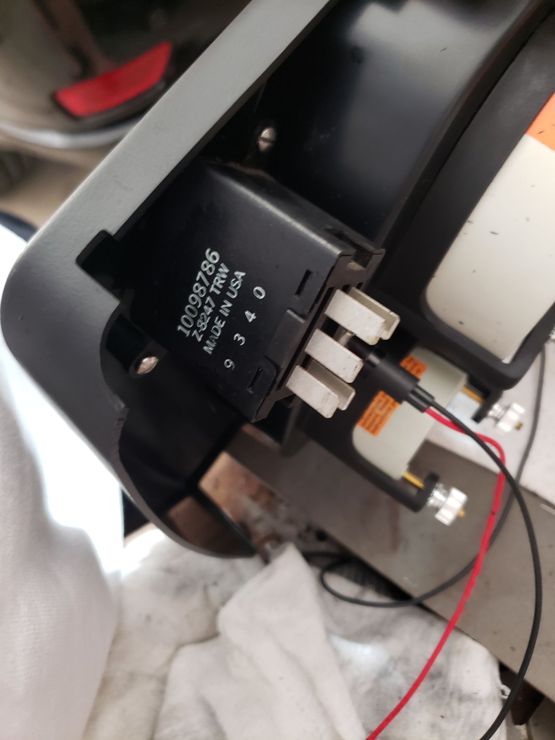

The last time I made an update I was trying to modify an old Edelbrock 3pt STB to clear my manifold/Throttle body. Lets just say I gave up garage welding with 110 and sold it. Luckily, a fellow TGO member was selling an Edelbrock TPI 3pt STB, which I honestly didn't think ever existed. I was worried that it wouldn't match up with the holes already drilled for the TBI version but it lined up perfectly. In hindsight, I would have welded up the old mounting holes and went with the new DSE 3 pt brace. None the less, I am happy how it turned out.
I also paused on the dash and gage installation as I had a "snafu" with an generic 3 way light switch that burned up the interior lights circuit in my dash harness. This required me to pull everything back apart and separate every single circuit in the dash wiring. I cleaned out and unpinned all the unused portions and replaced the burnt circuit. I ended up taking the steering column and harness and mocking it up in my basement to trace every circuit. I "borrowed" a low amp 12v battery from my kids toys to power the assembly so I could properly plan for 12v leads, grounds and 12v key on leads. I ended up going with a 3rd gen firebird light switch and rewiring it to the Camaro harness. This took a ton of trial and error since there aren't wiring diagrams anywhere for the firebird light switch. In the end, it works, albeit on my test bed, just like the factory. I changed my turn signal relay to a no load relay for the new LED markers but they still don't want to blink. I am starting to think an aftermarket gage cluster was a bad idea. I'll stick with it though because I am so close. I just don't want anymore dash fires. Thank god I installed the battery cutoff switch.
Firebird switch with a homemade ABS bezel.

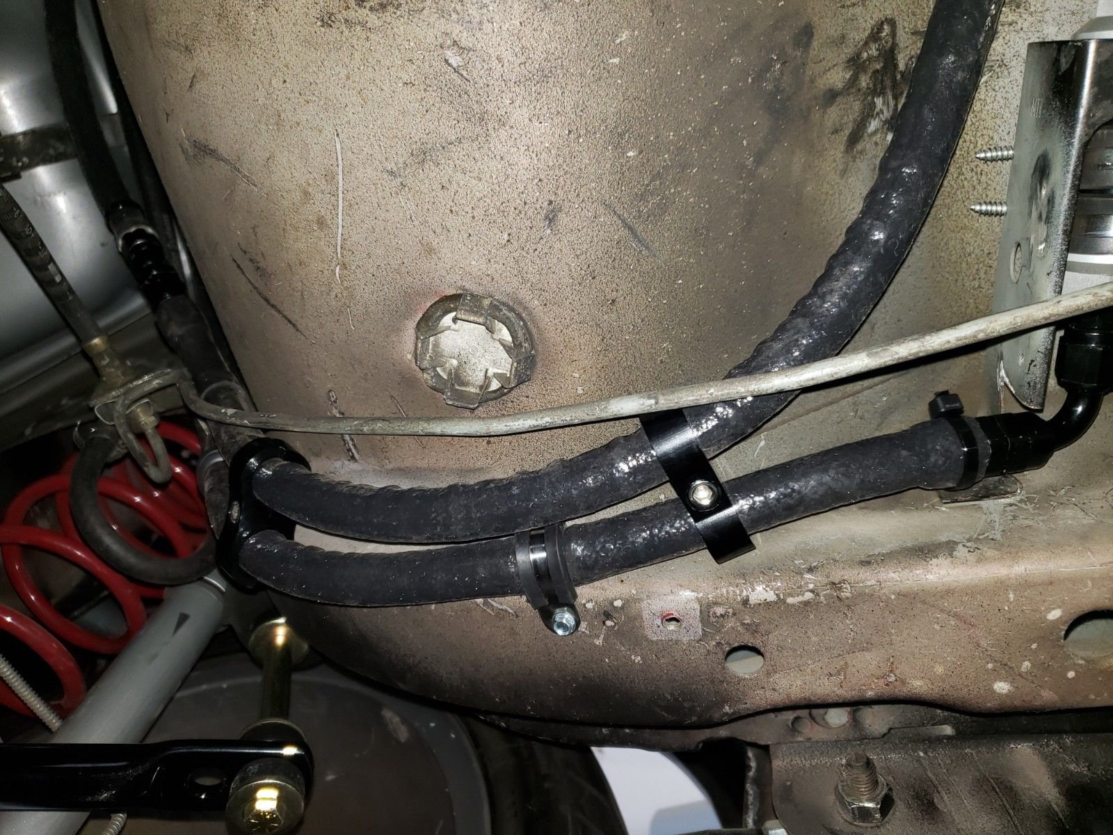

I am back under the car now installing the fuel and brake lines. I am using Raceflux lines and their fiberglass heat sheath covering. Very easy to work with and supposedly the same performance as PTFE. I will have pictures of that later. I installed the Founders panhard rod relocation kit which for the most part fit "ok" albeit with a little massaging on the driver side level. I had to grind off a little Sheetmetal overlap for the brace mount to sit flush. I was disappointed that the kit didn't come with a new panhard rod, so for now I will reuse the ugly 20+ year old spohn unit. All of this will be replaced with a fabricated 9" at some point so I am more focused on getting it drivable and only using parts that will transfer over. I also realized I lost the rear sway bar so I have the DSE rear bar kit on order. I am also about to put in a stock LS1 driveshaft (again will be replaced with a proper shaft come 9" time) and founders torque arm.
This is the small area I had to grind off to get the body side mount of the upper panhard rod to sit flat.
Cut, and hit with some primer.

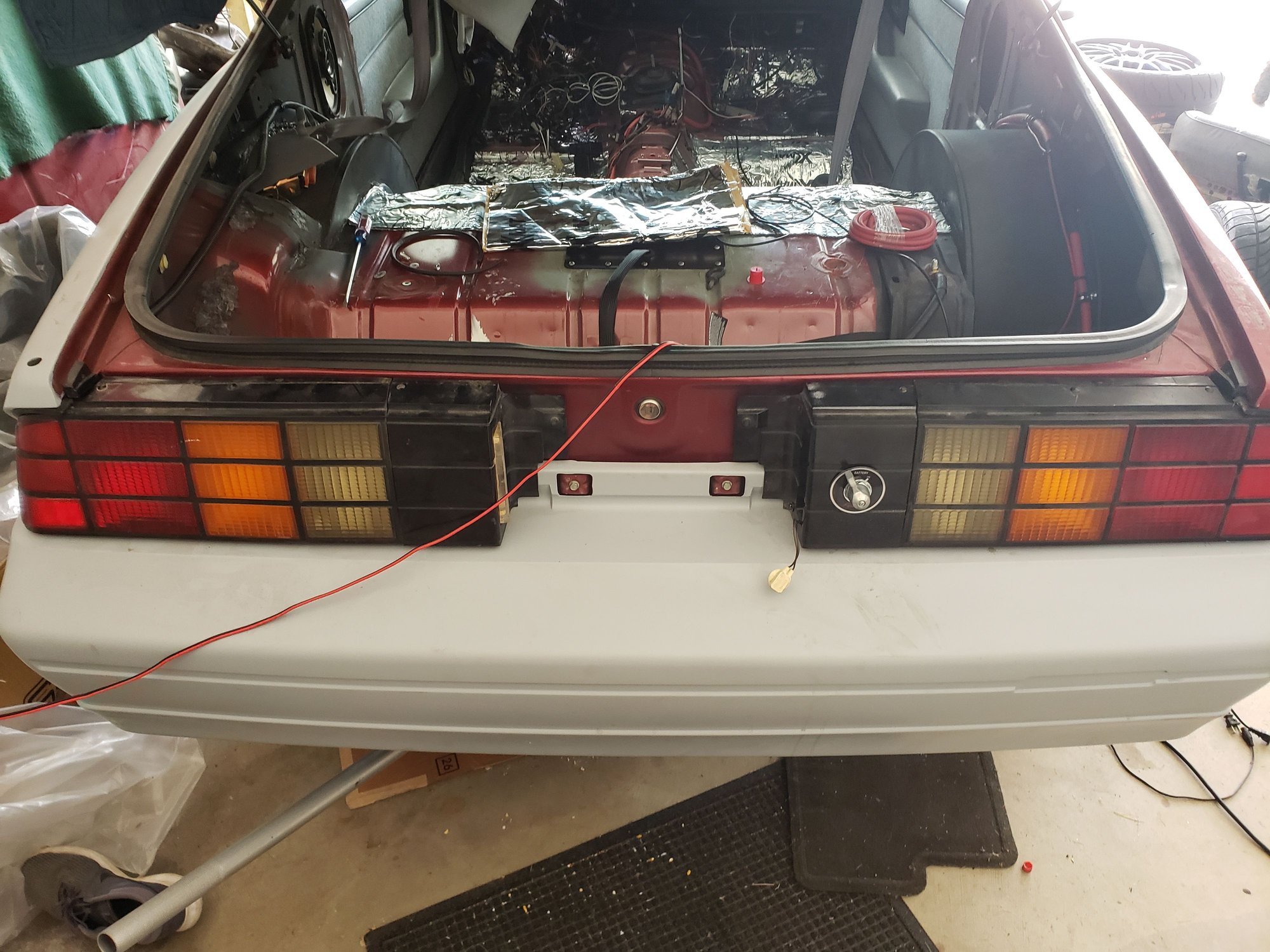

Checked a few more things off my list. Got the tank heat shield installed along with the DSE rear sway bar. Also realized I had to swap yokes on the LS1 driveshaft for the the Magnum spline count.
I am also in the process of installing the Founders torque arm. It is a really nice piece, but it isn't without criticism. I initially bought it because it had solid reviews and was a decent amount cheaper than the UMI version. I also was willing to gamble since long term I am not sure what torque arm I will be running when the 9" eventually makes its way into the car.
Cons:
  • No instructions, but I figured it out, but was really looking for some general set-up guidelines.
  • No hardware: This was a pain, so I ordered the UMI/BMR torque arm hardware kit only to realize that the founders system uses the OEM sized hardware. Namely, the larger 9/16 bolts won't work. I had to order 14MM X 2 X 190mm hardware to replace my long gone stock bolts. This should be plenty strong and if I break these bolts I have larger problems.
Pros:
  • Very good welds and overall construction
  • Includes Energy Suspension Torque Arm Bushing (The UMI does not).
  • Brackets fit perfectly over the soon to be broken 10bolt.
Holley Universal Vent, had to neck it down from the Aeromotive 3/8" vent to the Holley 5/16". I'll have to find a 3/8 vent.
You vs the yoke she told you not to worry about.
DSE Sway Bar installed, heat shield in, and repurposed ugly sportline springs and Spohn panhard rod. All will change once the 10bolt dies. Which will be at mile 1.

Well this is my standard 2 month update. The founders torque arm is in and the pinion angle set. My -6 fuel lines are run as well as my brake lines. I ended up using redhorse performance AN brake lines. They were a bit pricey but I loved the flexibility to route them around my tubular front end. I started using OEM replacement lines from Inline Tube and they just didn't fit around all my aftermarket stuff. I jacked all my fuel lines in fiberglass heat shield from RaceFlux. After using five or so brands of AN fittings I really like the RaceFlux line. Their lines are very flexible and shipping is free regardless of the order size.
I have been working like a madman trying to get this thing ready for Hot Rod Power Tour so I am a little light on pictures. I decided to run a staggered tire size until I find the right balance that this car will want. I opted for Bridgestone RE71R tires, 265/35/19 up front and 305/30/19 rear. With my tubs I will easily be able to narrow my long term rear end to tuck the rears in more. I need to get more pics of the fit, but with the car on its own weight I am very happy with the stance.
I thought I had a better pic but I don't. Fenders clear my wiring nicely.
Coming together
Slapped some grid taillights in along with my battery kill switch
I will blow the whole car apart for final paint once it is on the road tuned, and dialed in.
