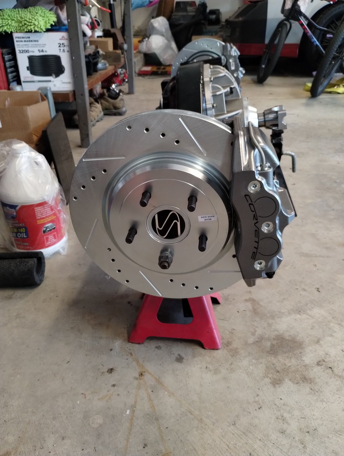

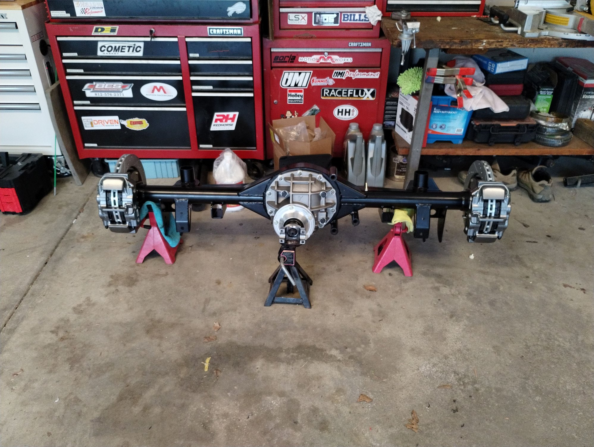

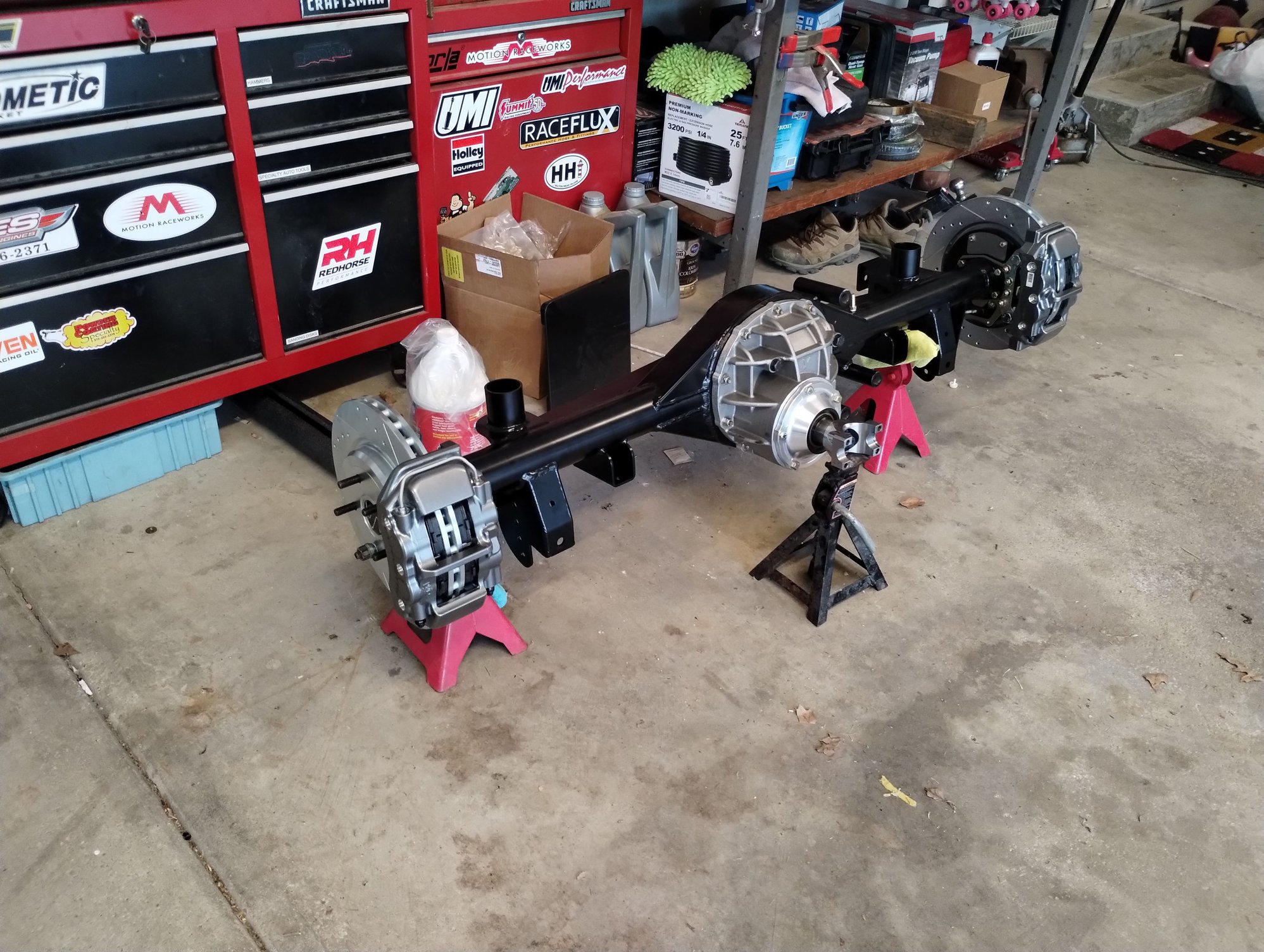

New rear has been assembled and is ready to go in. I had to have the axle flanges machined down and also hasd to drill an access hole through the flange but other than that both the trick chassis and Kore3 parts played nice together. I put this thing on a scale and without fluid or calipers it came in at 190lbs. I'll weigh the 10 bolt for curiosity sake. Here's a few pictures, the brake bleeders and cross over has been corrected since I took these pics. GM sells these C6 Z06 replacement calipers with the brake parts in the same location regardless of which side they will go on. These rear brakes seem comically large.
