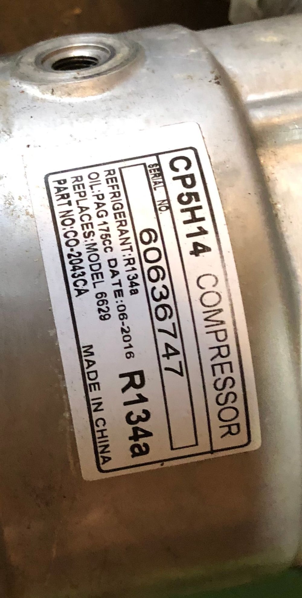

My Sanden compressor locked up and snapped my drive belt. I replaced the belt, but now I need to buy a new A/C compressor. I bought mine off of ebay. I used the A/C in my car for about 3 hours total. I bought my compressor from ebay, and I think I got scammed.

dont screw around with imitation Sanden compressors or remans, or "Sanden style"...
get an OEM Sanden. I went through two remans before learning my lesson and getting an OEM.
you can still get them on Ebay, but just make sure it's a genuine Sanden.

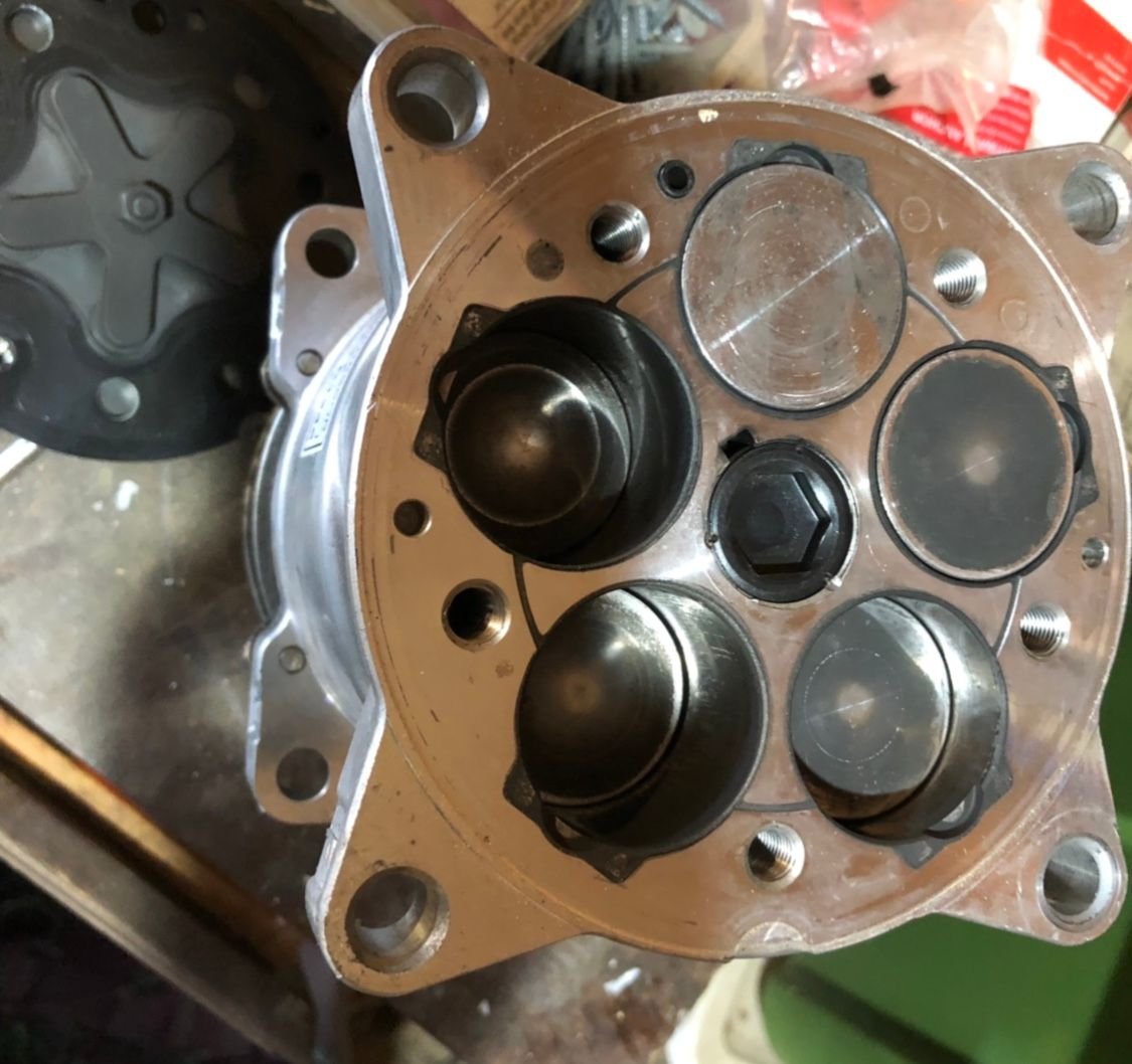

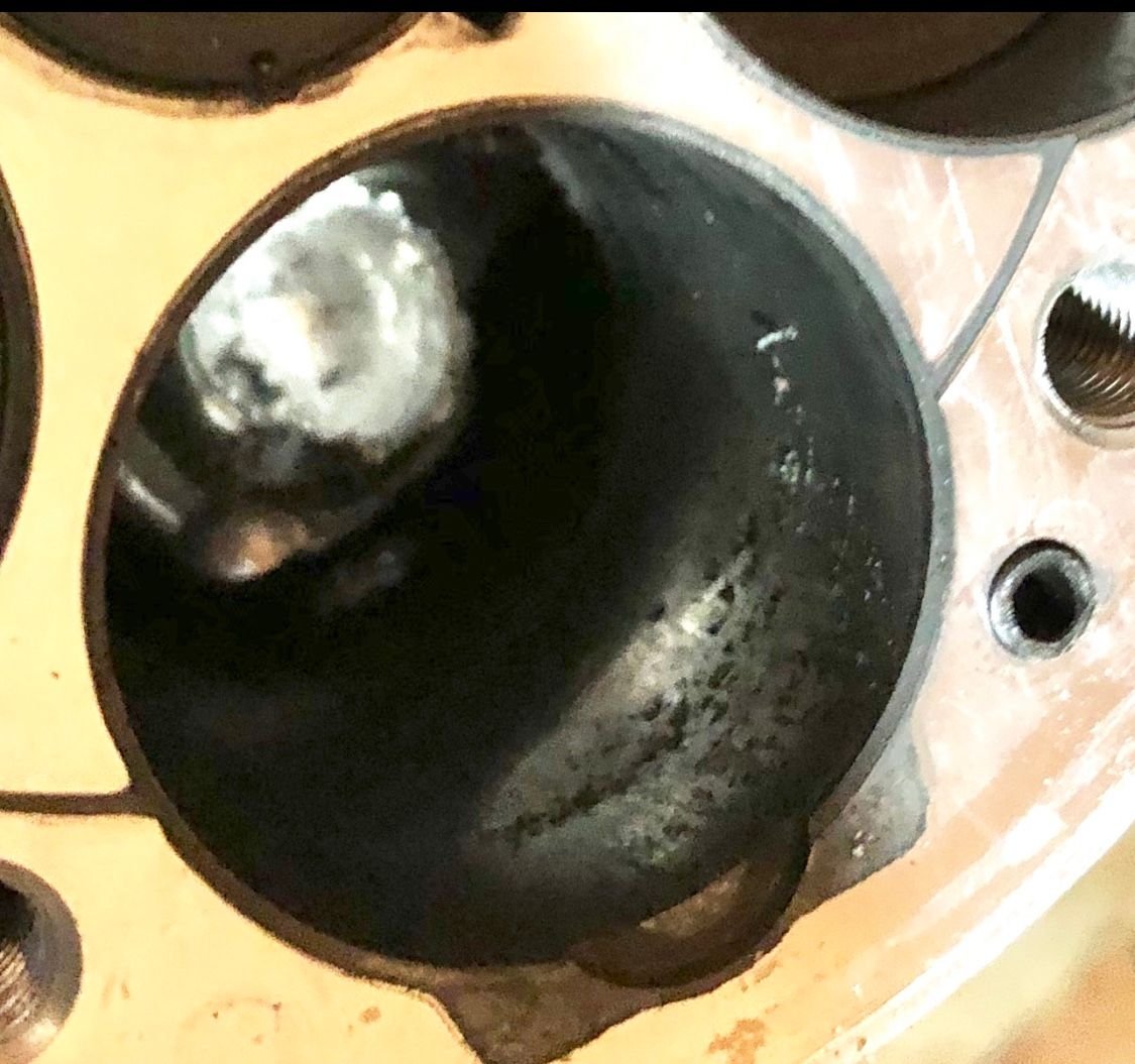

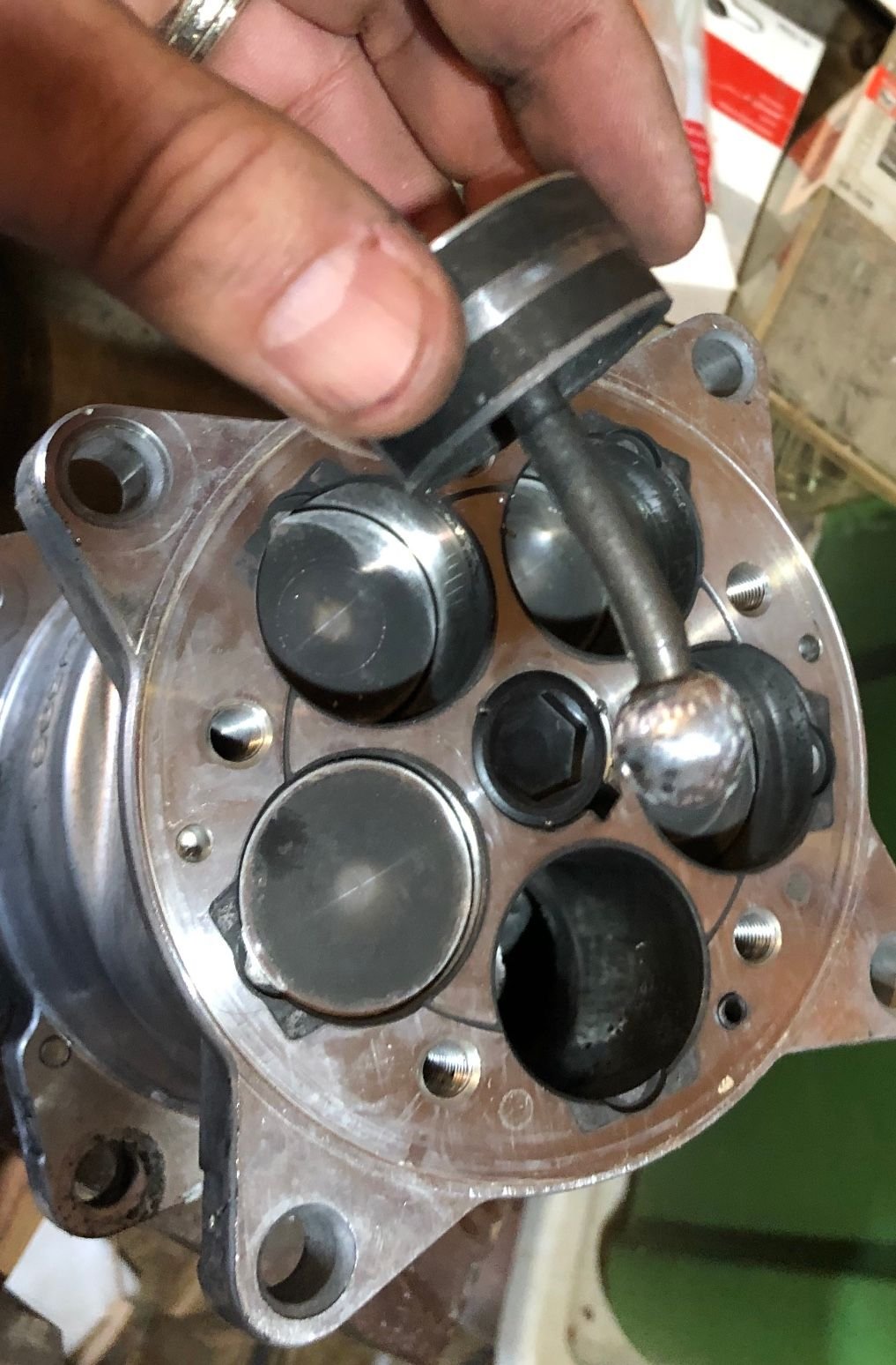

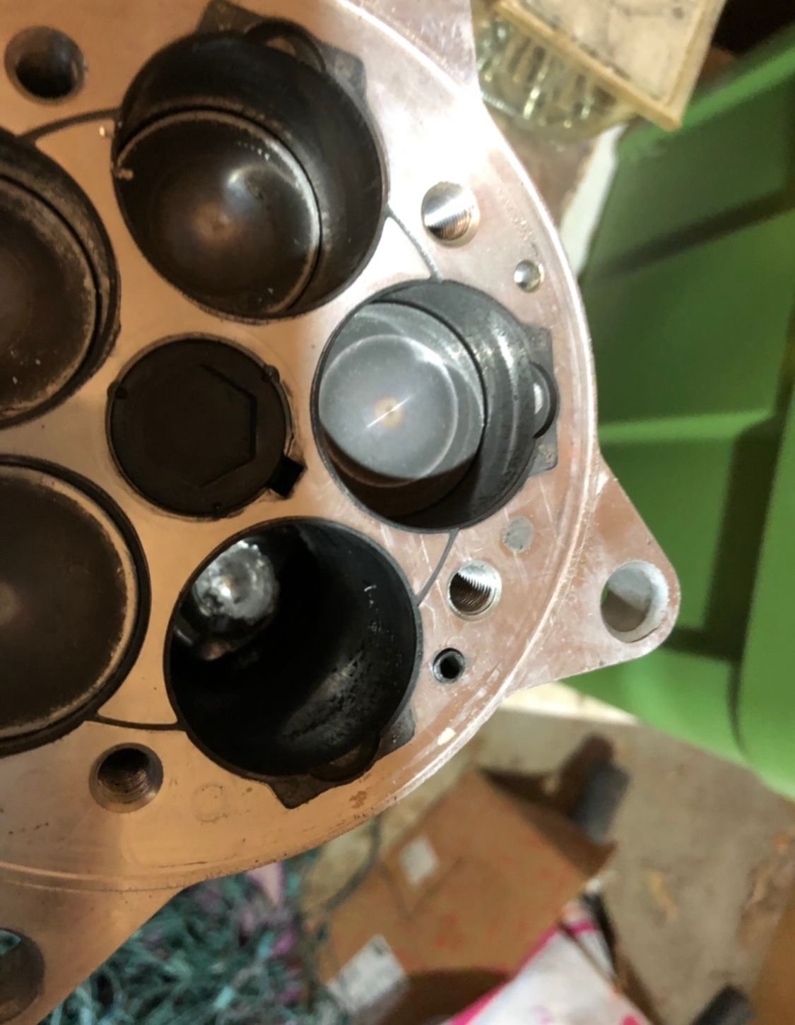

Old Nov 18, 2018 | 12:52 PM
johnw999's Avatar
Joined: Jul 2006
Posts: 580
Likes: 32
Re: Sanden A/C compressor
I think I figured out why my A/C compressor failed. The Sanden comes prefilled with oil. This cheap copy from China was bone dry when I opened it up.
