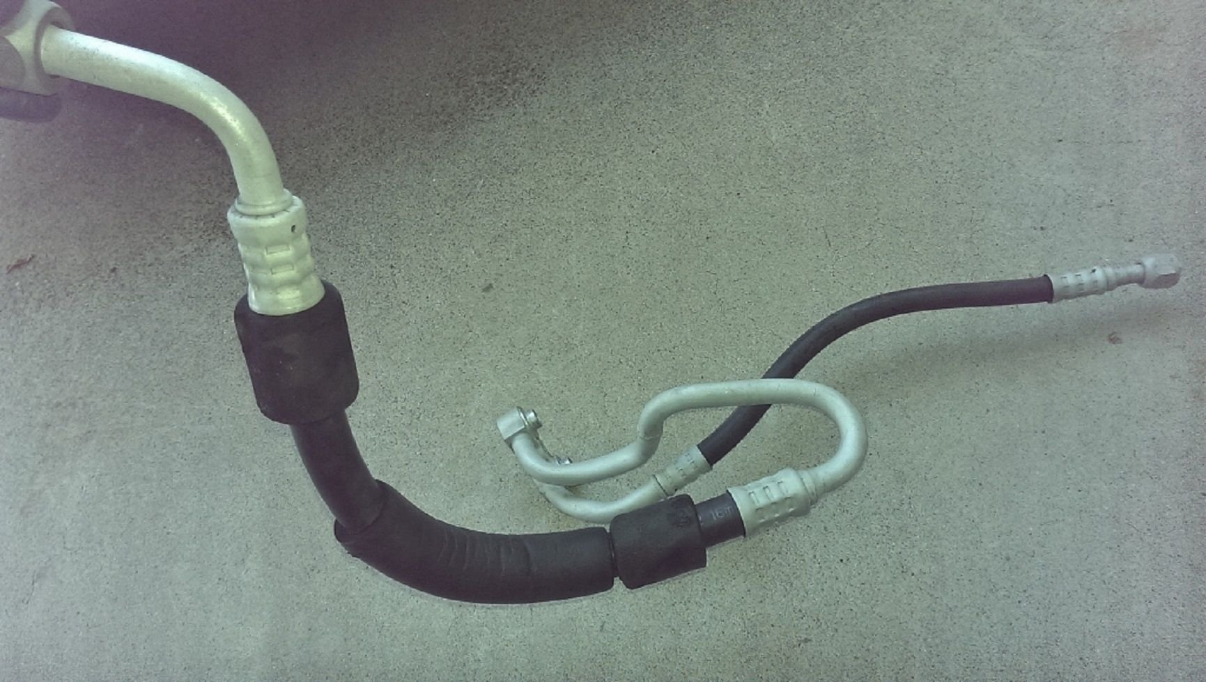

Dont know if this helps any, but i modified the stock piece.I wouldnt mind trying the hawks part or similar w/ custom made lines to boot.
