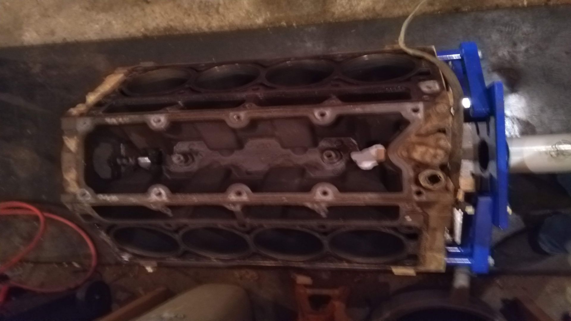

Engine before going to shop, sorry for the image quality old phone at the time.
