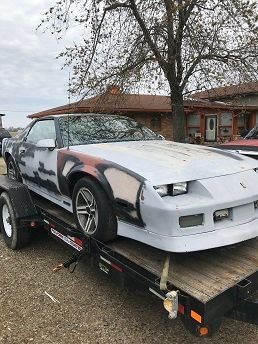

Hello All:
I'm a new member and new to third gen camaros. I bought an 87 Iroc-Z and am looking to document the restoration. My goals are:
  • LS1 and T56 swap
    • I've been reading posts on this site for a while now, and I've gotten a ton of good info from the stickies, so thank you to everybody that wrote those.
  • Supercharger
    • It seems like a lot of people on here are fans of Procharger kits, so I was thinking of going that route unless there are better options available
  • 12-Bolt rear end
    • Based on reading this seems like the common choice for cars making considerable horsepower\
My goal as of right now is something around 600-700 horsepower. I am looking to build a good handling street car that doesn't shake itself apart when I stomp on the gas.
Now here are my questions for now (I'm sure there will be MANY more):
  • Do I need to do anything besides what is listed above to stiffen up the body? I'd read that people have installed 2 sets of SFCs (Spohns and Alstons). Is this a common thing that people do or is this overkill? Again, from reading it sounds like I need SFCs, a wonderbar, a strut tower brace, and potentially a 6-point roll cage to stiffen up the unibody.
  • What other aspects of the car do I need to be worried about breaking with a supercharged engine?
  • What parts are worth investing in to maximize the reliability of the engine? I'm looking to invest in a F Body LS1 and T56 complete takeout assembly so I'd like to freshen up the setup when I get it.
  • Are there any transmission upgrades to beef up a T56? Coming from Cummins engines there were a million companies that beefed up Dodge transmissions to hold power. Is it the same thing with these engines and trans?
  • As far as suspension, are there portions worth upgrading? I see Hawk's sells a bunch of different tubular A-arms, LCA relocation brackets, etc. Are these parts needed for a street car or are they mostly reserved for strip cars?
  • K member: if I don't want to keep the A/C (I don't. It's a T Top car that won't leave the garage unless the weather is nice) can I use the stock K member or is it worth the money to get a tubular K member from Hawk's?
  • What engine, fuel, air upgrades are needed to run a supercharger to achieve my horsepower goal? Injectors, fuel pump, etc.
Thanks in advance for any help on this. I'm looking forward to documenting this. Pics of Day 1 are below. I'm all ears for any and all advice on this. Thanks again!

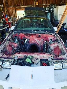

Some progress has been made on the 87. A buddy and I were able to get the interior pretty much completely ripped out a couple weekends ago. Everything was pretty well destroyed and needed to be tossed. I kept the plastics for the most part but all the carpet is goneski.
Progress on yanking the engine is a little more painstaking. We have all of the parts taken off under the hood and should be able to pull the block out this weekend or next.
Before I keep going, I was wondering if anybody knew if there are any parts/accessories off the original engine that were worth keeping as long as they aren’t junk to begin with?

Depending upon what engine mounts you do, the stock clamshells can be used on the LS with adapter plates.
The power steering hoses will hook up to the LS power steering pump with some minor bending.
Other than that, not much else will be useful.
You might consider unbolting the K-member from the frame and lifting the body off of the engine/transmission/K-member. The LS will go on the K-member much easier that way. Doesn't make much difference if you're going with a tubular K-member, but if you're going with a tubular K-member, you might as well drop out the factory K-member now...

I appreciate the heads up! What I'm hearing is that basically nothing is useful. Good to know because we were NOT gentle removing parts lol
As far as the engine removal goes, we are officially done with the drivetrain! We pulled the transmission crossmember off and pulled everything out over the front bumper. Having a skidsteer and cherry picker made it much easier.
