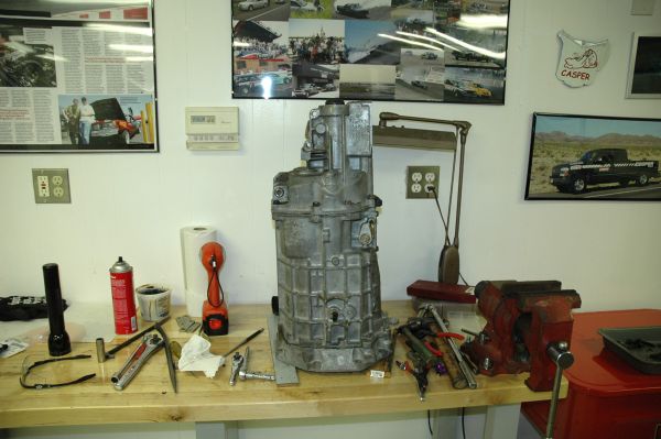

So, car is in the shop getting tore into:

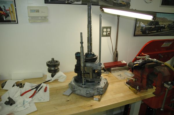

List of things to do to it:
Basically - rebuild T56, change out diff, add adjustable springs (Ground Control) , etc

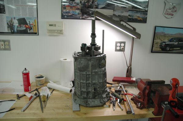

T56 apart -
Torsen diff - went open - getting mini-spool

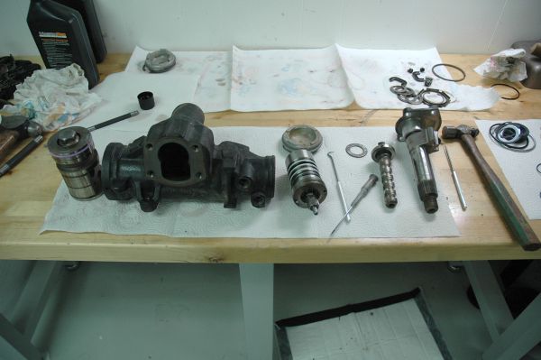

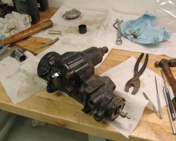

New spring rates, steering box fix , hope to make it handle better.

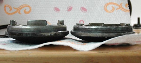

Originally Posted by Norm Peterson
A mini-spool isn't going to do you any favors in street or autocross driving. Don't know about drifting, but maybe CrazyHawaiian will drop in with some useful information (he's been drifting for a few years, last I knew in a 3rd gen).
Norm
I've been around CrazyHawaiian before, on his board, etc. I've been around drifting for over 5 yrs now
I've also been the mini spool route before ( www.BubbaDrift.com ). I don't want to put much money into the 10 bolt, and don't want to spend the money for a different rear right now.
But i agree, for most people a mini-spool is not the way to go.

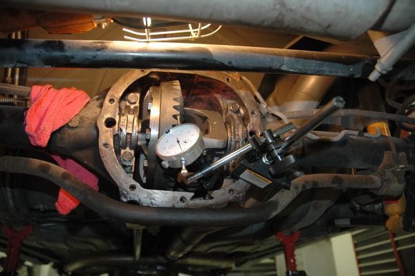

update, things going slowly - life gets in the way (and the rearend rebuild was more of a pain in the *** than expected).

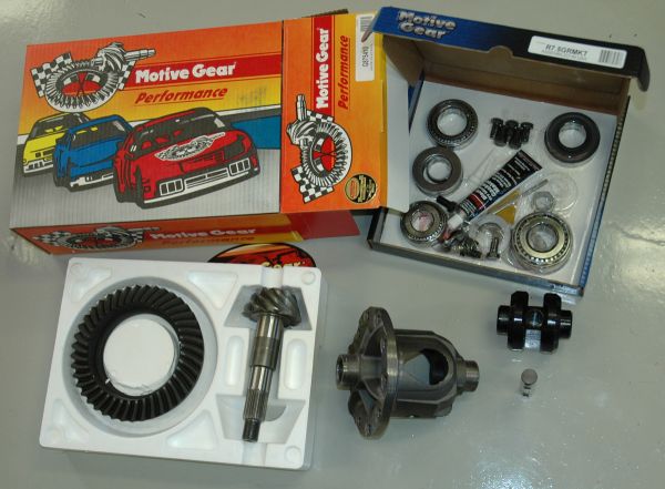

rearend parts and rebuild (mini-spool - cheap way of locking the diff)

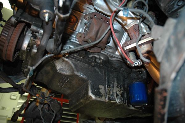

Dropped front subframe to change the motomounts (shot, engine rocking and exhaust hitting the floorboard) and changing the oil pan gasket which was leaking and making a mess

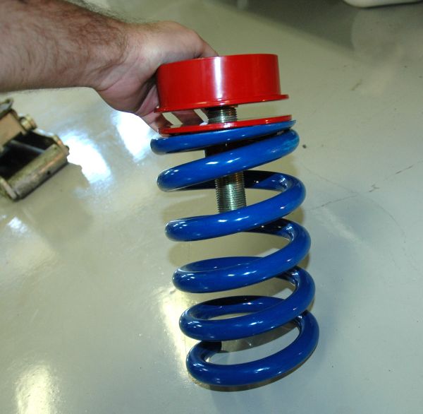

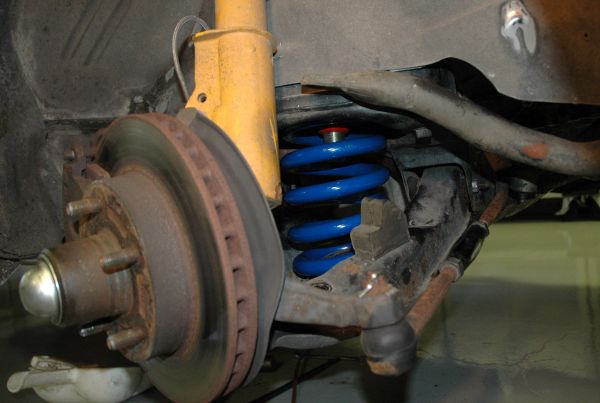

Weight Jacker - Ground control setup, increased spring rates and can adjust the height -
installed -

rear springs and ground control adjuster (stiffer and go lower), rearend is hanging and the spring is not seated -

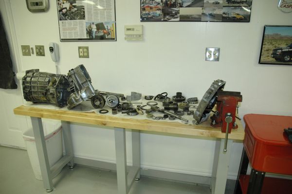

T56 parts cleaned up, getting ready to build the trans -
Family slowing me down in the garage -
Need to get more done, still a lot of projects to go
disagree, cheapest way is to weld the satelites in the diff, i did that and the car is still streetable and you can use to it how it works, true tires will get uesed faster but drifting with 100% locked is superb
except that the diff i had was a torsen and you can't weld those up, so minispool was my cheapest option

Thanks for the good pics of the Ground Control weight jacks. I have been considering a set for my car. Was it any easier to install the fronts than a regular spring?
Oh God yes - front springs are easy to change now: adjust it to the shortest setting, place it and the spring in place, place control arm bolts (or ball joint depending on how you took it apart) and then adjust height.
Changing spring rates and height is nice and easy now

Anyway, here are a few pics. More to come when it gets off of the jacks, we lowered it, cut the bumpstops some, etc.
photos of some of the work-
T56 going together

Steering box rebuild -
Difference in stops that control the amount of angle ( IROC stops on left, Monte Carlo stops on right)
Stops and spacer rings (stops for one direction, spacer rings for adjusting stops in the other direction)
assembled and adjusted box-

Update -
Was planning on going drifting at mineral wells on 4/26/09 - but traced a bad vibration down to an unbalanced flywheel (resurfaced one). So the Camaro sits until i order and install a new clutch setup, not very thrilled about that.
Lost a little angle when lowering it i think, put a 1/2 in spacer upfront (with new studs) to help wheel fitment and pick up a couple more degrees of steering. No more angle without changeing the frame rails or other more serious changes.
Photos of the ride height with new Ground Control spring setup -
steering angle measurements and photo of the tire contacting the frame rail before i added stops
