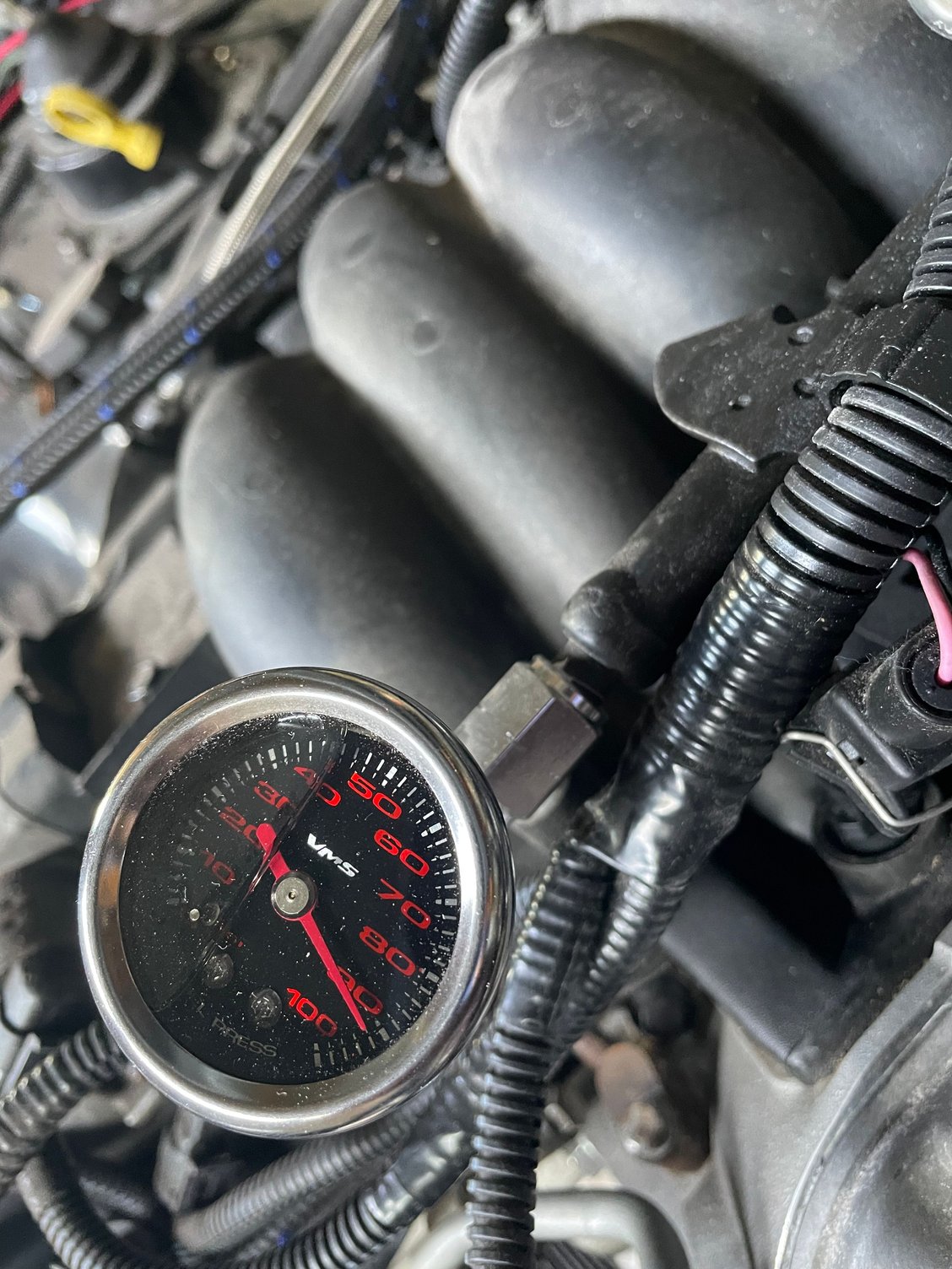

I’m trying to finish up my ls-1 swap and although I can get the engine running I put a fuel pressure gauge on the fuel rail just to see what it’s at. Oddly, the 100psi gauge is pegged at 100 which is confusing to me.
Here is a little background on the fuel system I am running:
4th gen tank
corvette filter/regulator in the same location the stock filter is normally.
stock ls1 fuel rail up at the intake with regulator .
it should run around 58 psi but the gauge as stated above is pegged at 100
Any thoughts ?

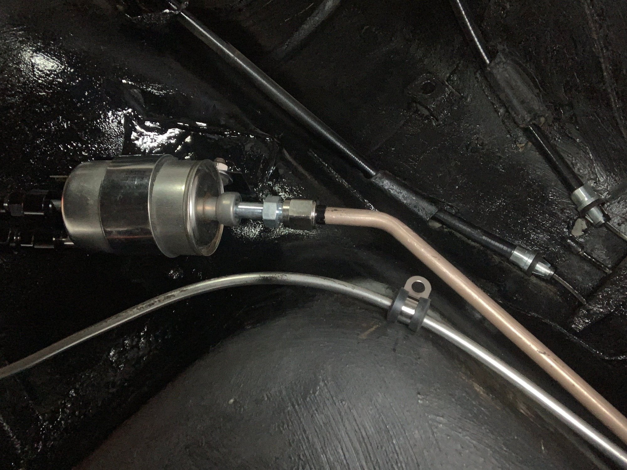

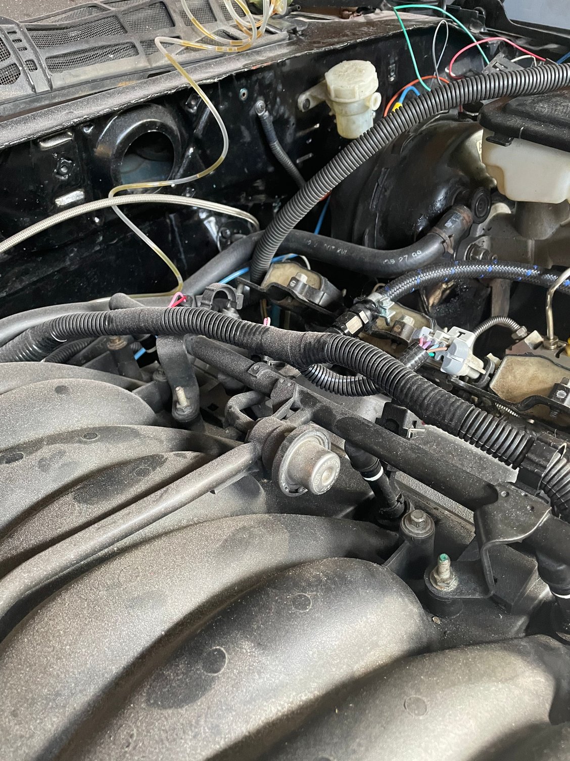

The fuel rail regulator is the stock one
the gauge is located here
and then this is the corvette filter/regulator

Our replies crossed in cyberspace. Thanks for the pictures, that's helpful.
No pressure regulator in engine bay to worry about as far as I can see. I think that canister is just the fuel pulse damper. That leaves you with just the C5 filter/regulator and the 4th gen in-tank regulator. You're going to have to remove one or the other.
Looks like the general orientation of the C5 filter/regulator is correct. But I don't know which of your soft lines is the return vs. feed. Seems you marked one with a piece of tape to know which is which. You can easily verify again by pulling the lines and seeing which one flows fuel with a short key-on.
