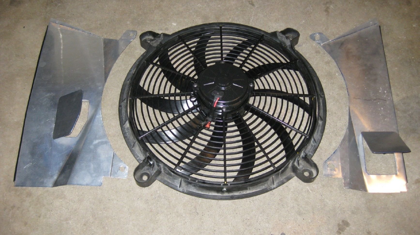

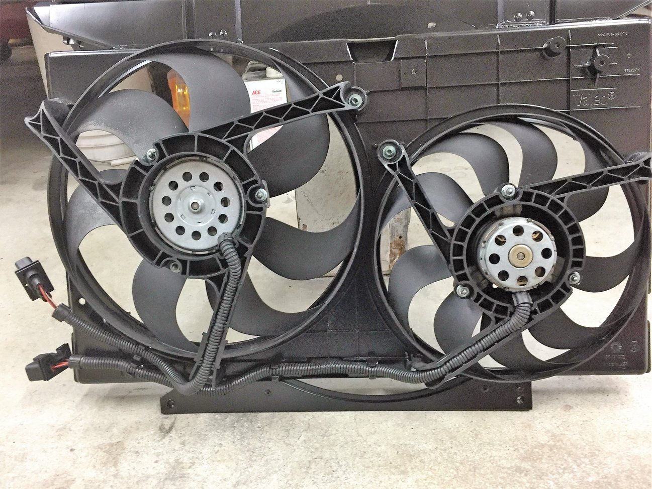

I trimmed the upper and lower brackets and bonded them to the GTO dual fans. I’ve since sold this one with the stock radiator to another 3rd gen owner, but it work great and wired easily to the e40 ECU. What is more interesting is that the fan assembly from a VW Beetle and the GTO are identical, even the same manufacturer. So, yes, there is a use for the original single fan parts.

I used it to mount a Spal fan, so i could bolt it up and look stock-ish.
