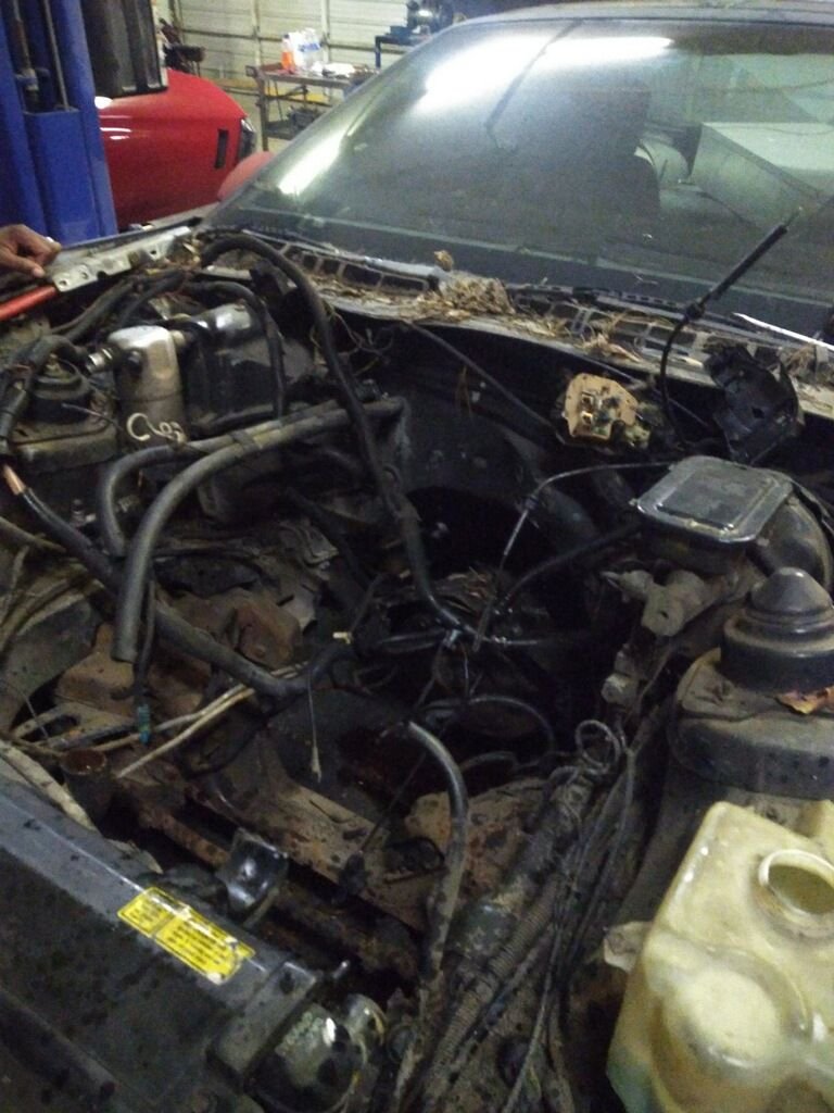

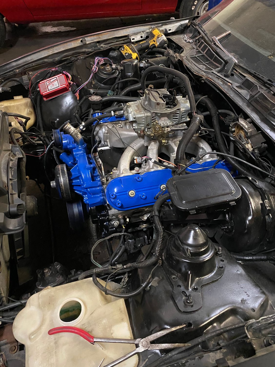

Hello everybody I Have a few questions about removing wires that are not needed from my 86 Trans Am I installed a LQ4 from a 2003 Yukon Denali it is also carbureted. Well I should say was Carbureted I now have a holly sniper EFI not yet installed
But my main question was how to clean up the engine bay and remove wire harnesses I no longer need?

Everyone's swap is different so my best advice is to read the stickies above on wiring. You'll will be able to determine what circuits are no longer needed for your specific swap. Basically, you will reuse a lot of the wiring from the C100 firewall block, and you'll likely get rid of most of the engine control wires that route through the fender.

Anyway, the first thing I'd do is figure out which components you AREN'T going to use (injectors, rear O2 sensors, etc.), mark them, then strip off the wire loom and take them out.
Pocket has a few really great threads about customizing LS/ LT wiring harnesses to fit our cars.
Last of all, why in God's name do you want to use a Sniper kit when the LS engines come with superior fuel injection from the factory?
Everyone I've ever met who had a Sniper had problems with it.
I'd go to the junkyard, grab the intake/ injectors/ harness/ PCM off of a wrecked Silverado before I'd ever spend a penny on a Sniper, but that's just me.

Here are the threads that people generally reference, in the order they were created. My notes will save you gobs of reading, just jump to the relevant posts.
Sep 2009: How to prep a 3rd gen harness
https://www.thirdgen.org/forums/ltx-...p-3rd-gen.html
Part I of the wiring guide. Stripping and prepping stock 3rd gen harness for integration with an LS engine swap. Key posts #1-3, 25. The rest is Q&A.
Oct 2009: LS1 harness start to finish
https://www.thirdgen.org/forums/ltx-...rt-finish.html
Part II of the wiring guide. Building a custom LS1 harness. Key posts #1-7, 17. The rest is Q&A.
Nov 2009: Additional swap information
https://www.thirdgen.org/forums/ltx-...formation.html
Pinouts of C100 and C207 for various years. Simplified wiring diagrams of LS1 engine subsystems.
Mar 2010: LS1 harness revisited
https://www.thirdgen.org/forums/ltx-...revisited.html
An abridged overview of a "plug & play" harness from beginning to end. Example based on LS1/T56 swap into 89 GTA. Key posts #1, 2.
May 2010: Connector ID, PN and interchanges
https://www.thirdgen.org/forums/ltx-...erchanges.html
Photos and part numbers of some electrical connectors common to LS1 swaps. Suggested tools in post #60.

And this is the mac daddy thread for electrical connectors with LS swaps,
https://www.thirdgen.org/forums/ltx-...lectrical.html
This is how most of us do it that work on our own cars, we get hands on with it. Took me a long time to realize that all the planning and talk in the world won't get you as far as holding stuff in your hands. Go to something you don't need and take out the wires. Repeat until you're down to just stuff you still need. That's mostly just wiring for dash gauges and starter motor, maybe some other things.
