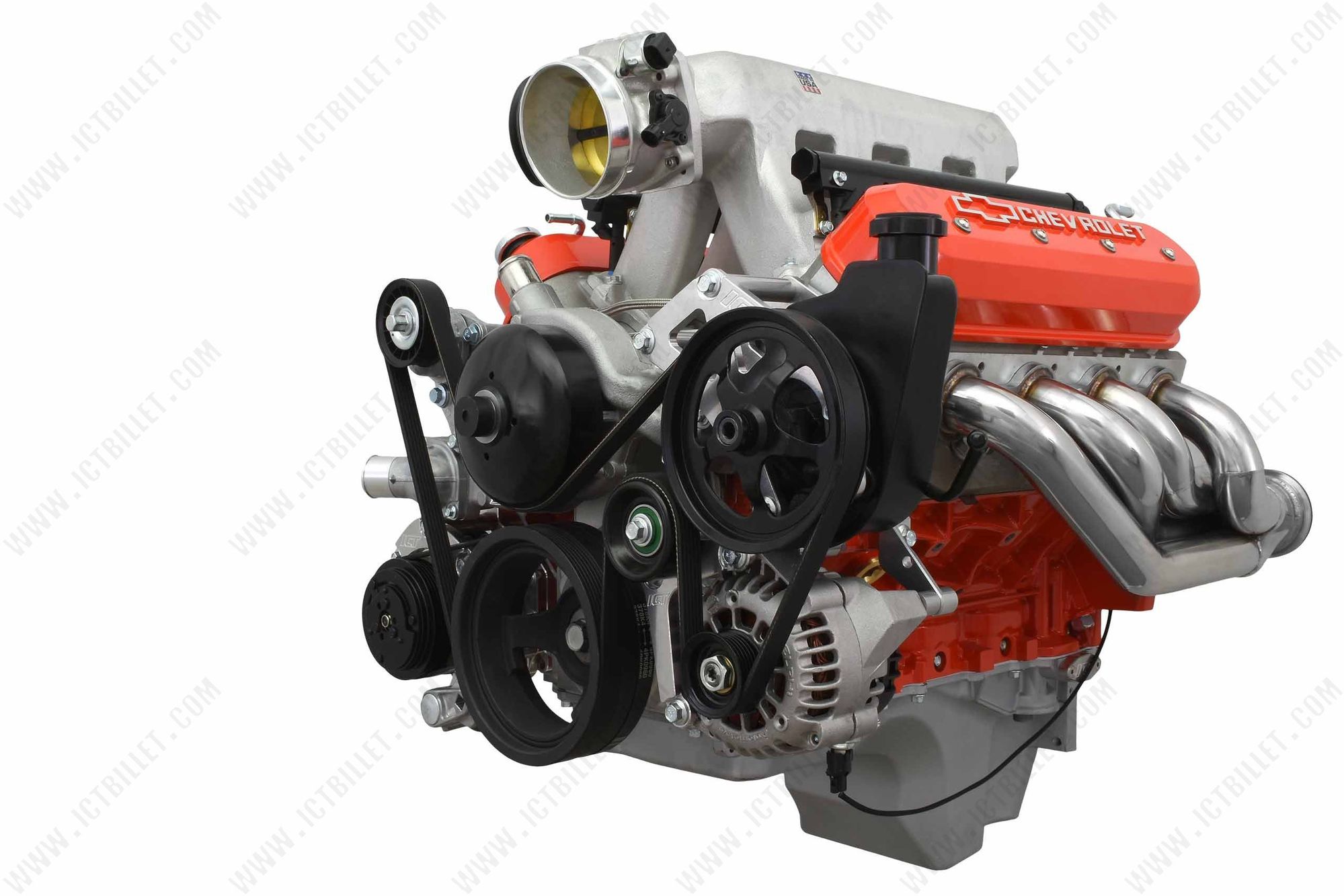

ICT FEAD question
Not sure if anyone has any experience with this perticular kit.
I'm using an aluminum 5.3 block, truck balancer, L99 water pump (because it has the driver side outlet). This accessory drive will fit the balancer and water pump, I'm just curious if the alternator location will whack the steering box?
https://www.ictbillet.com/saginaw-po...lternator.html

Re: ICT FEAD question
The alt will clear the steering box. You may have to remove the triangular K-member to frame rail brace though
That is the 98-02 fbody alt location, just shifted forward 3/4"
Just throwing it out there, but the speed engineering bracket can use all the same accessories, but keeps the PS in the stock 3rd gen location. Stock 3rd gen PS hose will fit. One less piece to have to make
