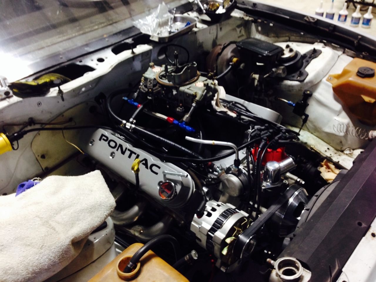

I don't really think it'll be 'easier' than EFI, just different, and with different headaches. We did an LS swap on our C Prepared Firebird. I figured I'd be frugal and use the carb that was on the 305 and a distributor, saving some parts buying. A distributor will require a Wegner front drive kit, which is NOT cheap. It also uses a Ford-type distributor, since it's front-mounted, so really no savings in the parts list.
After we got the car back together, we discovered that the carburetor was so worn out, it was leaking, both air and fuel, badly, and just really needed replacing, so no cost savings in the carb department. The car runs GREAT, it's a 310 LS1, but would probably fire and idle smoother with EFI. We're committed now, and have worked out all the kinks, but the road to track-worthy was not smooth.
The Holley single plane does mount the carburetor closer to the engine, but even with that and a drop base on the air filter we needed a 2" cowl hood. We're working now to seal the air filter to the hood so we can get cooler air from the cowl, but that's another project.
