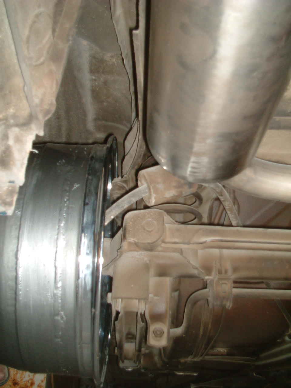

Hello guys
after a long wait ,today the machine shop phoned me and told that they are ready but when I went for them only 1 was finished, by the way hope the other one will be ready soon too!
went home with 1 rim and painted the job on the inner side with Hamerite to prevent from corrosion when you inflate the tire (sometimes in air compressors there is water because no maintanance is given)
and on the outerside with silver paint to match the rim so when you look through the 5 spoke you see a good and clean job!
Attached Thumbnails TODAY'S 3 DIFFERNT UPGRADES ,18'S ,IROC GRILL, NEW 145 MPH CLUSTER-10-inch-wide-1.jpg   TODAY'S 3 DIFFERNT UPGRADES ,18'S ,IROC GRILL, NEW 145 MPH CLUSTER-10-inch-wide-4.jpg

Here are also attached some pics of the 10 inch rim on the car without tire till tomorrow!! and you can also see my last mod of the stainless steel true dual exhaust with free flow cans on each side !!

Today as promised I went to the tire shop and I baught 1 rear Toyo 295/35/18 for the ready done widened 10 inch iroc rim
I also attached some pics of the rim with the tire ,where there is no clearance from the inner fender and some hammering is needed !
with a iece of hard wood and a good mallet in 5 mins the job is already done, just push the lower corner a 0.25" inwards,
from the tire to the lower control arn there is about 5/8 of an inch and everything is ok!
after I went on the road I also notised that there was a noise from the inner fender and went again to the garage and jacked the car and found a piece pf metal from the fender that was polished, it was a part of the fender a bit higher from the lower front corner that was interfiering!
another time wood and mallet and everything done!
to be sure the 3rd time I had a passenger behind my seat and no noises at all!!
left wheel and fender is done! right wheel from the machine shop and another tire and the staggered combo is done !!
hope it was helpfull!

clearance pics!!TODAY'S 3 DIFFERNT UPGRADES ,18'S ,IROC GRILL, NEW 145 MPH CLUSTER-clearance-2.jpg
TODAY'S 3 DIFFERNT UPGRADES ,18'S ,IROC GRILL, NEW 145 MPH CLUSTER-clearance-1.jpg

Here is a another pic of my car with the ready widened rim and tire on the left! still waiting for the right one from the machine shop!!
what you think?
