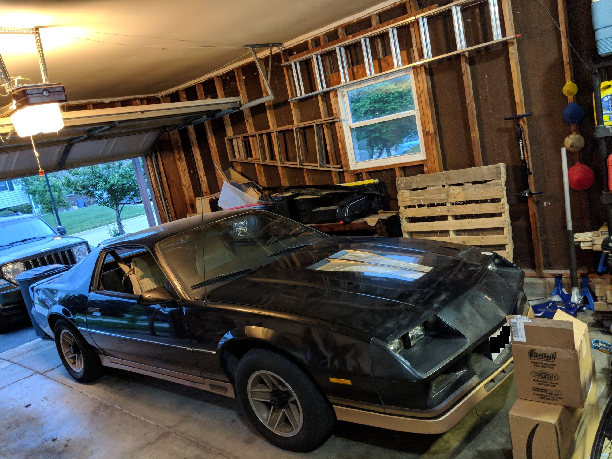

Lots of updates so one post/pic at a time else I'm going crazy trying to keep it straight. First, it barely huffed and puffed off the trailer. Didn't even have one of the plug wires connected. Carb was full of ****. Rebuild time:​​​​​​​
Old Feb 25, 2019 | 07:19 PM
DevX83z's Avatar
Joined: Dec 2017
Posts: 32
From: C-bus, Ohio
Car: 1983 z28 H.O.
Engine: L69
Re: DevX83z - 1983 z28 HO
Got that out of the way and felt like I'd fly off the road. Found a broken swaybar link. Replaced both, and the bushings for it to the frame. New tie rod ends, centerlink, struts, 235's for Cooper Cobra's for rubber and an alignment. No pics, but now it goes where I tell it.
Next started to get some slipping... so.. clutch time! In a garage on jack stands....
