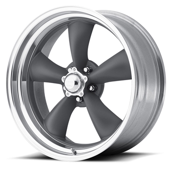

No updates on the car yet. Just been thinking about what kind of route I want to take with it in terms of appearance. I don't need much more than basic performance as it's just a casual driver. I still have my Mustang, and I work for a place that allows me to take exotic cars out at my leisure, so I can get my go-fast fix when I need it I've always been a fan of stock appearances, but with a bit more attitude. So for now, I'd like to lower the car about an inch, remove the tint, and replace the tired front nose. Next year, assuming I haven't run in to any expensive issues of course, I plan on picking up either a set of these Torque Thrusts in 17's, or a set of the Hawks 17in GTA's. There's also a member on here (don't remember his name) who has a very subtle GFX package that goes on to the factory GFX. Essentially small dark grey ground spoilers that just make the car look a bit wider at the bottom. I'll try to find a pic and add it in. There's also a rear spoiler that's essentially the stock one, but taller, and I love the look. I think it only looks right once the car has the right stance though, so that'll also be later on.
