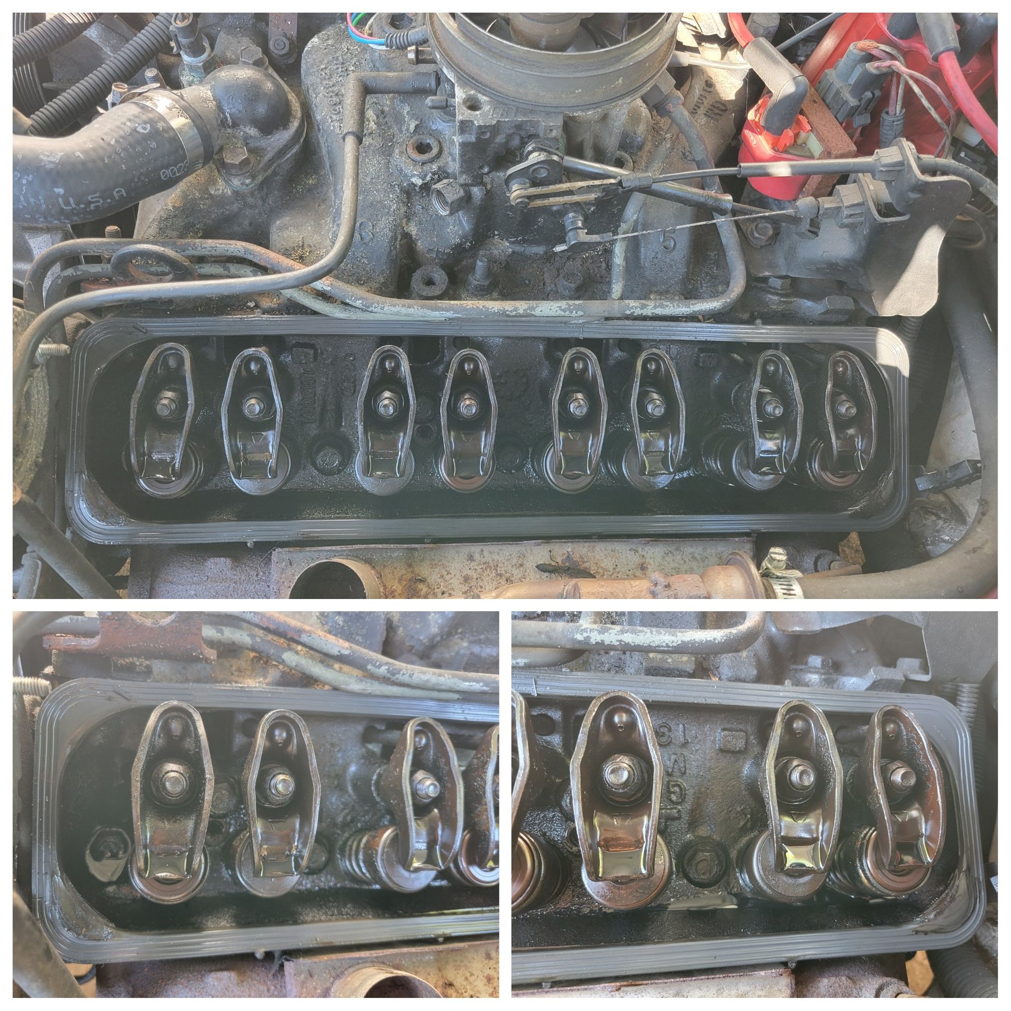

Have you had a valve cover off yet? There’s oil drain holes in the head and if there’s sludge it can clog them up and leave oil standing in the head and it eventually leaks down through the valve. I had this issue on my last small block. Probably not your fix but worth a shot.
Google “clogged oil drain back holes” and I’m sure stuff will pop up

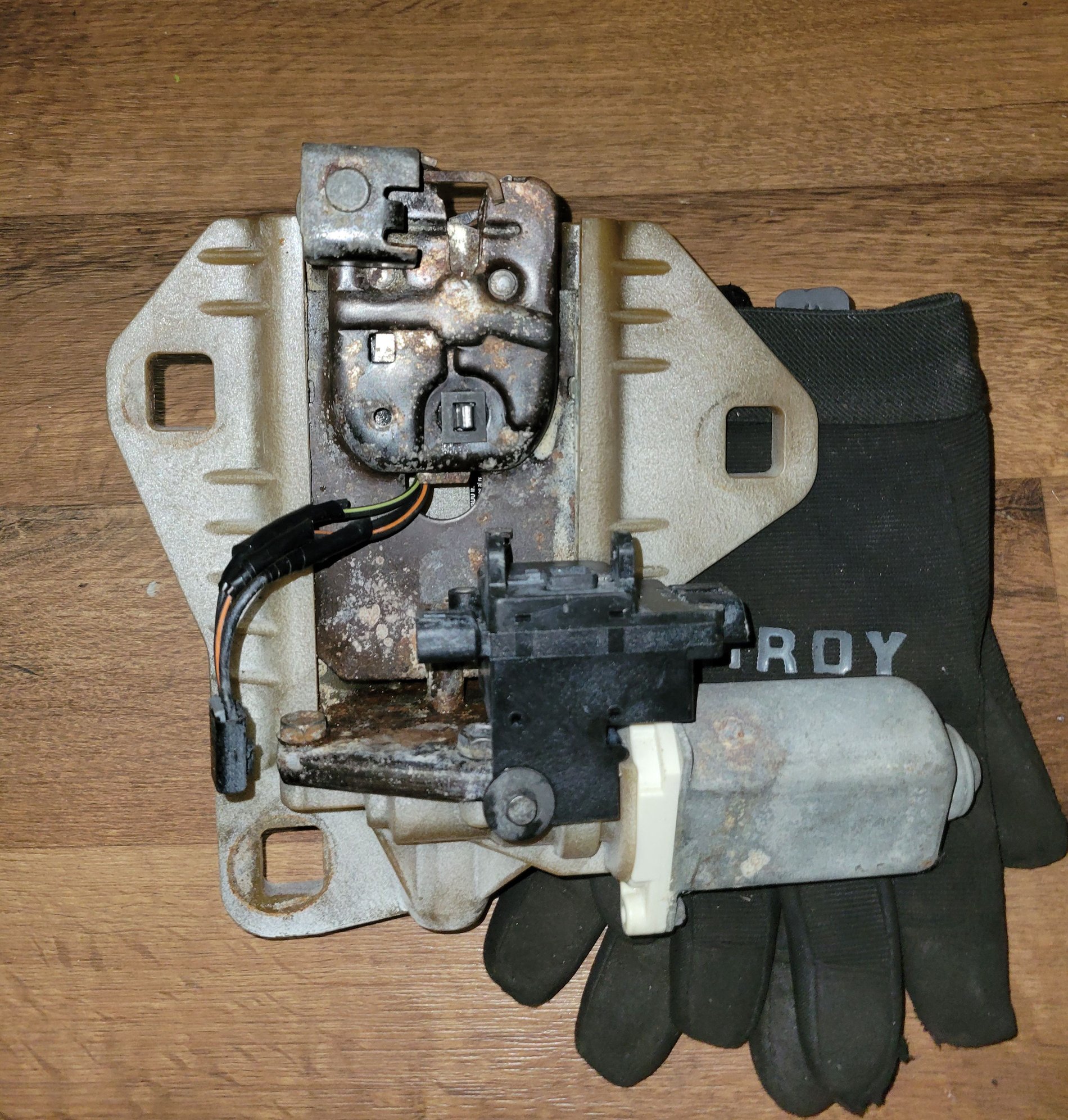

Pulled the whole assembly this morning degreased/cleaned a little and disassembled into 3 parts, motor, solenoid thing, mounting plate w/ lifting latch. I cleaned the solenoid thing with plastics safe electronics cleaner. As shown in the pic I was shocked to find some bare wires, but I tapped them while troubleshooting last night.
the reason I'm highly confused is because all replacement motors come with this giant plastic housing that doesn't look like my original. Unless all you do is remove the plastic housing, and just use the actual motor? I really wish someone would chime in because I keep going into these crisis's blind and I'd hate to buy a new motor, remove the housing and F the whole thing up.

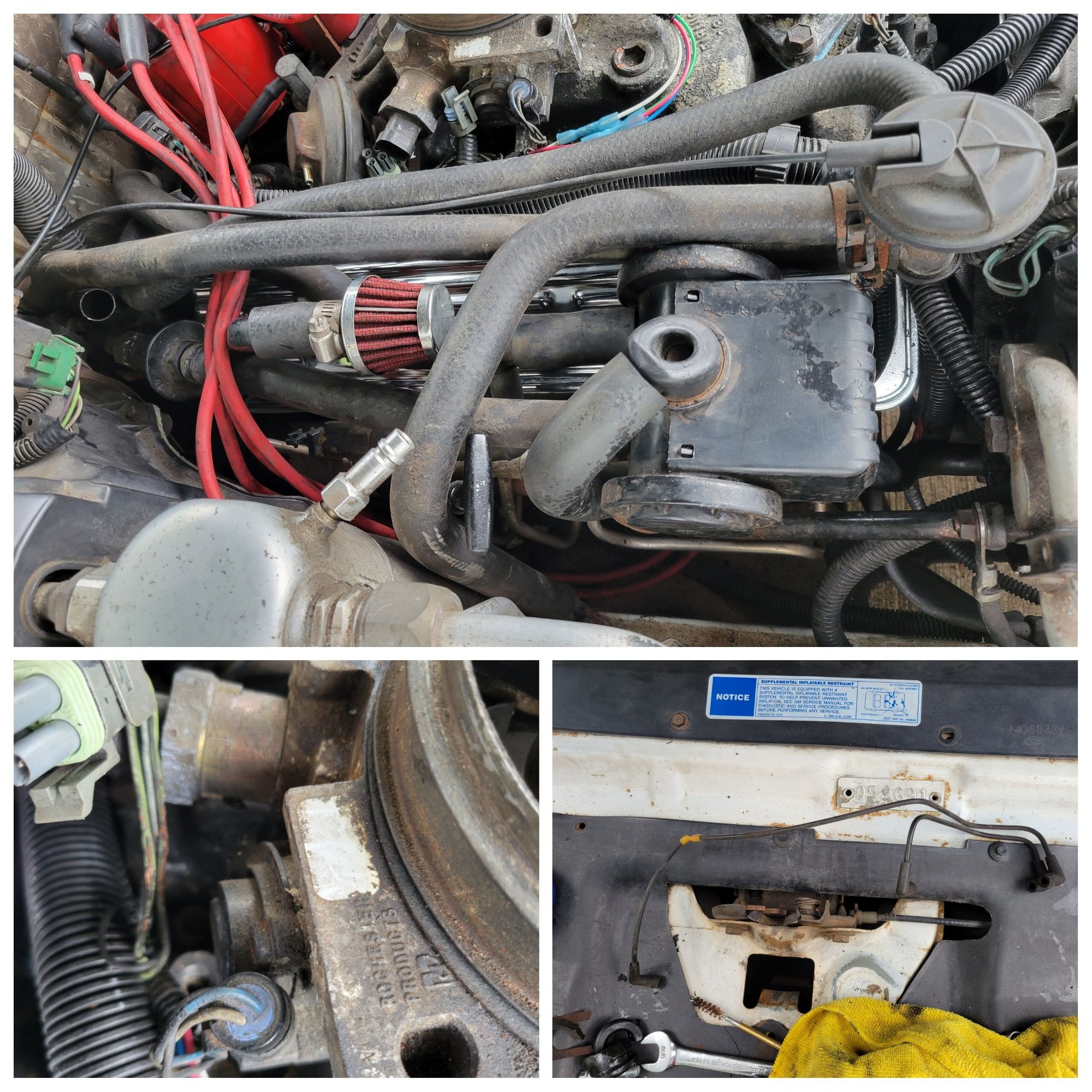

Just like that I worked myself into a JAM. Looking at the GMSM I went in the trunk, pulled the "extended relay" and the terminals had corrosion all over so I sprayed with the CRC and gave it a lite wire brushing. Long story short... loss battery voltage at the Red Wire. GMSM says Bat Voltage on CKT 138 (Red w/ Wht Stripe Wire) from Lid Fuse at all times... lid fuse is not blown, neither is ACC fuse.
Question: The Hatch Release for a 1990, with the 91-92 pulldown assembly are there 2 relays or 1?!? I only find what defined as Extended Relay and the schematic has both a Hatch Release Relay & Extended Relay. If there's 2... where's the other one?!?!?
Kicker: I used a Bench PSU..12V... jumper'ed the Pos/Gnd terminal on the Old Motor and BY GOSH it works. So I'm going to return this one I ordered, and put the whole thing back together. If I can get Battery Voltage back on CKT 138 Red w/ Wht Stripe I can start troubleshooting from sq1 THE RIGHT WAY...

I got Battery Voltage back!!!! It should be CLEARLY noted lol in the GMSM that CKT 138 is a SHARED power source with the trunk light bub as the PRIMARY source. A few post back I mentioned clipping off the pigtail for that light bulb because it had frayed and bare wire spots, not realizing its true importance. As soon as I clipped off the bad area of wire and reinstalled that light bulb pigtail BOOM 12.76V back at the pull down harness connector .
So while I'm back at sq1, and happy about it in my opinion it leaves 2 options. First up being the switch in the car, since its job is to supply the ground path and it's confirmed battery voltage is present. Second is a 50/50 split on the Relay or the Connector Switch Assembly, since when 12V is applied manually to the motor... the old motor works. The relay is $6 I'll get one to be safe but the odd thing is I have 12V coming into and going out of the Connector Switch Assembly leading me to think if the relay is always energized with battery voltage present all that's missing is the ground path provided by the switch to complete the circuit? My goodness troubleshooting this should be easier.

Knowing me, I dove right in and ran right into a problem. What "Oil Drain back holes"? Those giant holes between ea set of studs? Is the standing oil shown in the bottom pics a problem?
Old Sep 1, 2022 | 11:25 AM
  #48
92RS-HeritageEd's Avatar
Joined: May 2015
Posts: 674
Likes: 23
From: Ohio
Car: 92 RS / 90 IROC-Z
Engine: 305 / 350
Axle/Gears: Non-Posi / Posi - Both GU2 - 2.73
Re: My First 92RS - The Revival
With not a peep from anyone on TGO, I found in a YT vid theses "Drain back holes" are 2 per head 1 at front & 1 at rear. Neither of which was clogged on the driver side. I checked visually & with a small brush. So I grabbed these new Chrome VC's off the shelf and slapped the driver side on. 1 issue, I destroyed the grommet the PCV valve goes in trying to get it out the old cover.
