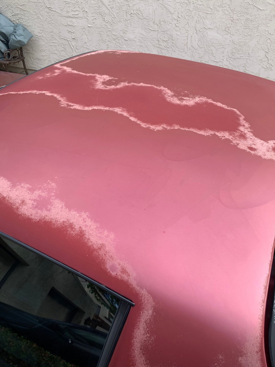

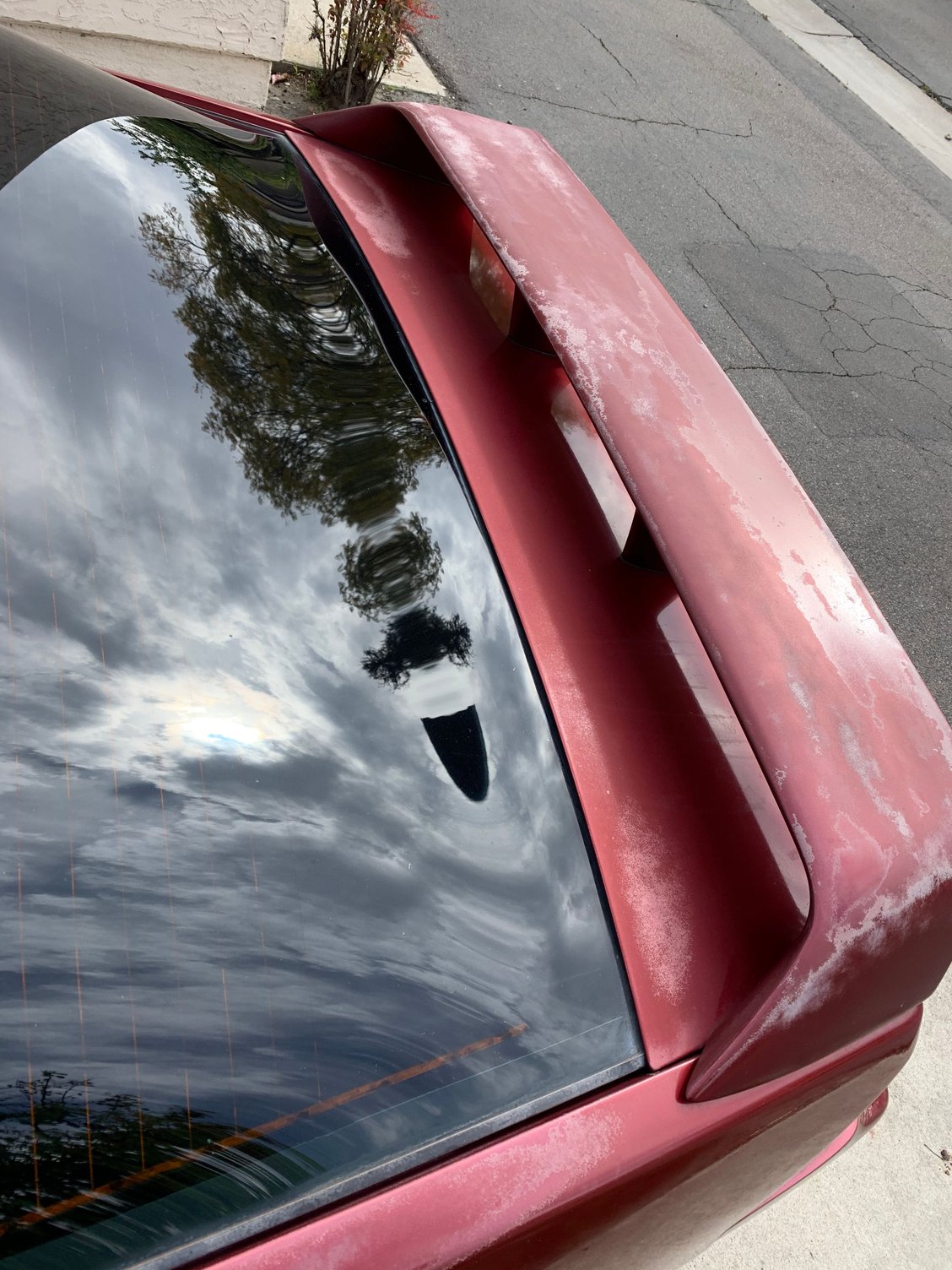

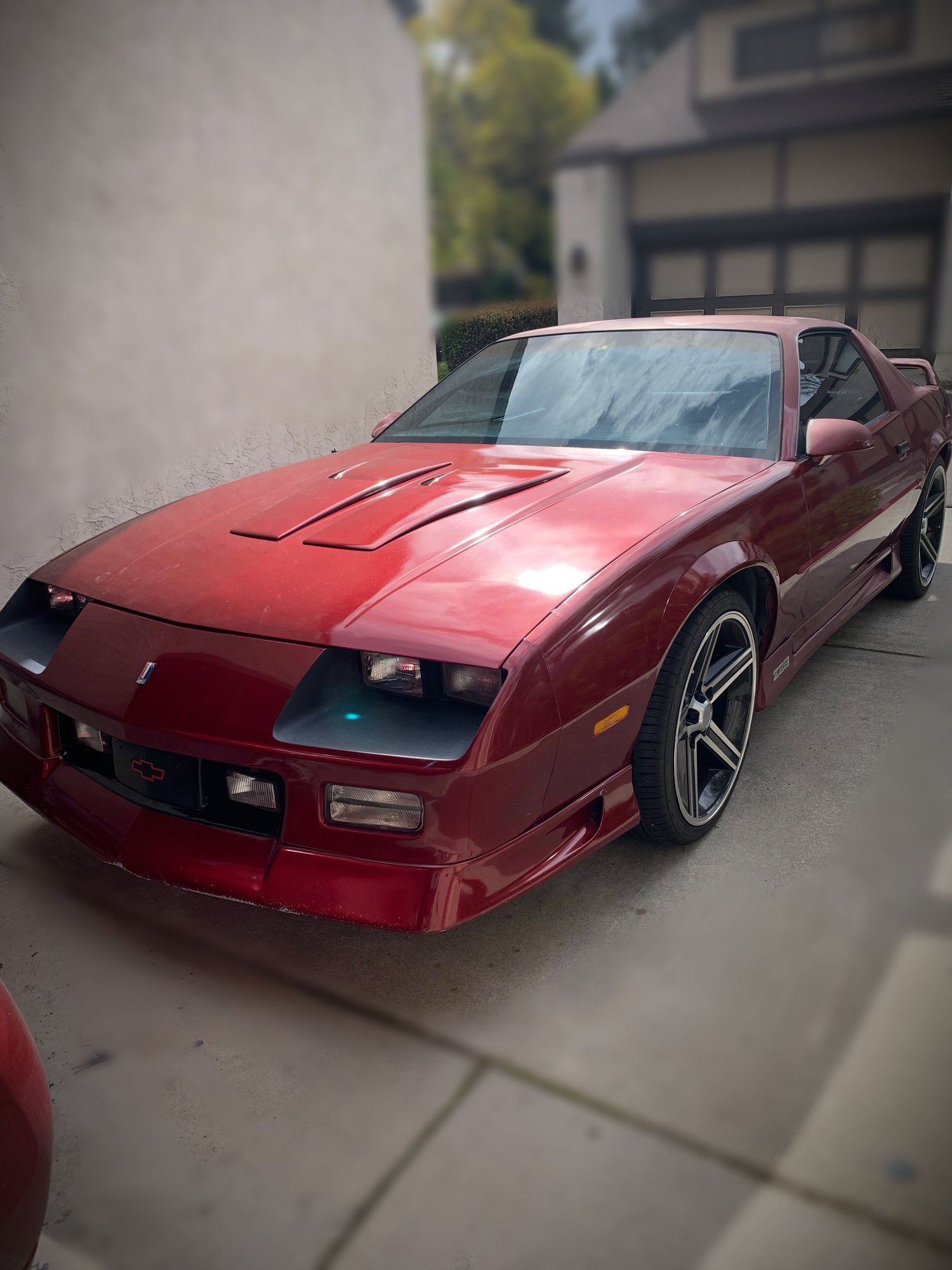

As you can see from the pics, the front end of the car is in pretty good shape. Unfortunately, the rooftop and the end the clear coat is gone and the paint is faded. I want to keep it the original color and have it done right. There is no rust of the car anywhere. The bad part is when I looked for the code sticker for the car, it’s gone. So I’ll have to try and match the color as best as I can.

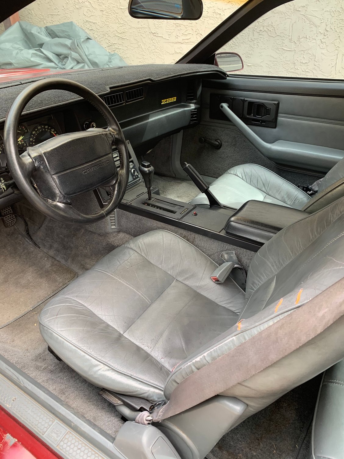

The interior is in pretty good shape. Rips on the seats but it doesn’t bother me so they’ll stay. At some point I’ll get them fixed up. Right now my main focus is the mechanics side like the engine and transmission, which it’s the 5.7.

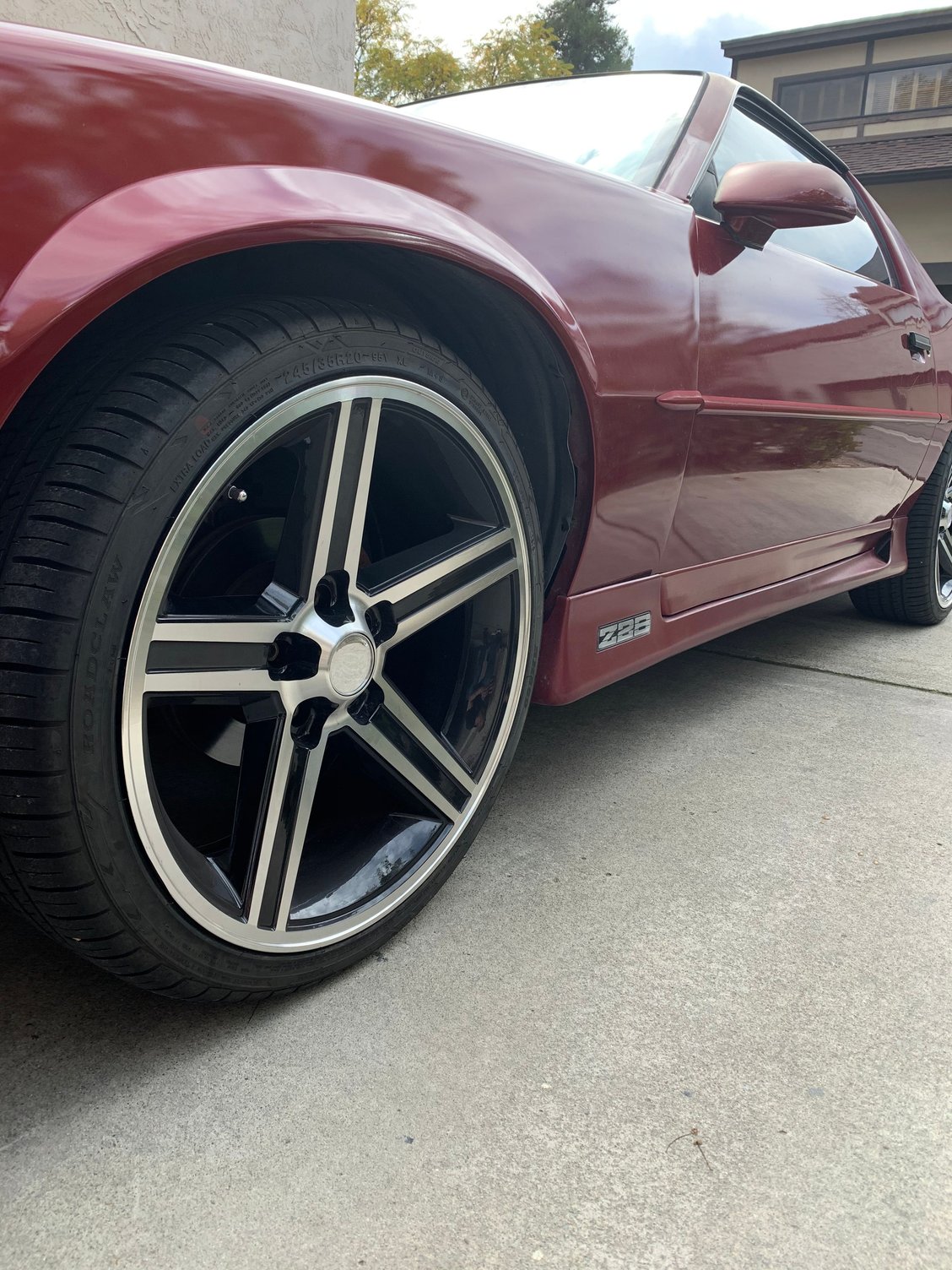

I love IROC wheels, but these are 20in rims that the car came with and Im not quite sold on them yet. Luckily, the last owner gave me the original rims with some good tires as wells maybe I’ll just switch back to stock.
