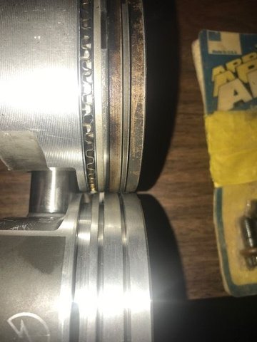

Thanks for spotting that.
I have just now checked and its a tough one to "measure" until I actually put them on rods and measure the deck heights.
Instead, I took one the of rod and forged pistons on that came with the engine and used it to check all four corners of the block about a month ago. I was the usual .025" down the holes. This is piston on one of those rods compared to the new Hyper piston.
I took that known forged piston and slid the wrist pin out of the new Hyper one until I could match them perfectly, wrist pin to wrist pin. That's got to be correct?!? Right?
The pic may not display it that well but I also used a straight edge to be sure and the flat top portions of the pistons match very well bang on.
Not sure what the differing spec numbers mean, however there's no way wrist pin to wrist pin there's .a 012 difference in these.
Sure glad it was noted though and sure glad I checked and I will keep an eye when I assemble it.

It looks as though you could use Vernier calipers to measure from the pin bore to the piston crown. That would nail it down to the hundredth.
That said, even if they are a lower compression height you obviously know you still have options to achieve the piston to head clearance you're after.

Pretty much did that and the only difference I see is the top ring land on the Hyper is a little lower than the top ring on the forged piston. They are exactly the same height so I'm not sure what that spec means in the first place. I'll know when I pop a couple in on the rods but see no reason for concern yet. I know what .012 is and they are flat portions of both pistins are the same from the wrist pin.

I concede defeat on the Hyper Piston height. Took the two pistons into the shop tonight and had a much better, closer look. .012 feeler strip works.
I can either live with improving the quench from the stock .063 to just .052 OR have the decks machined .012 a side and get the .040 I prefer.. I'll decide when its first mocked up.
