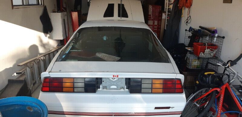

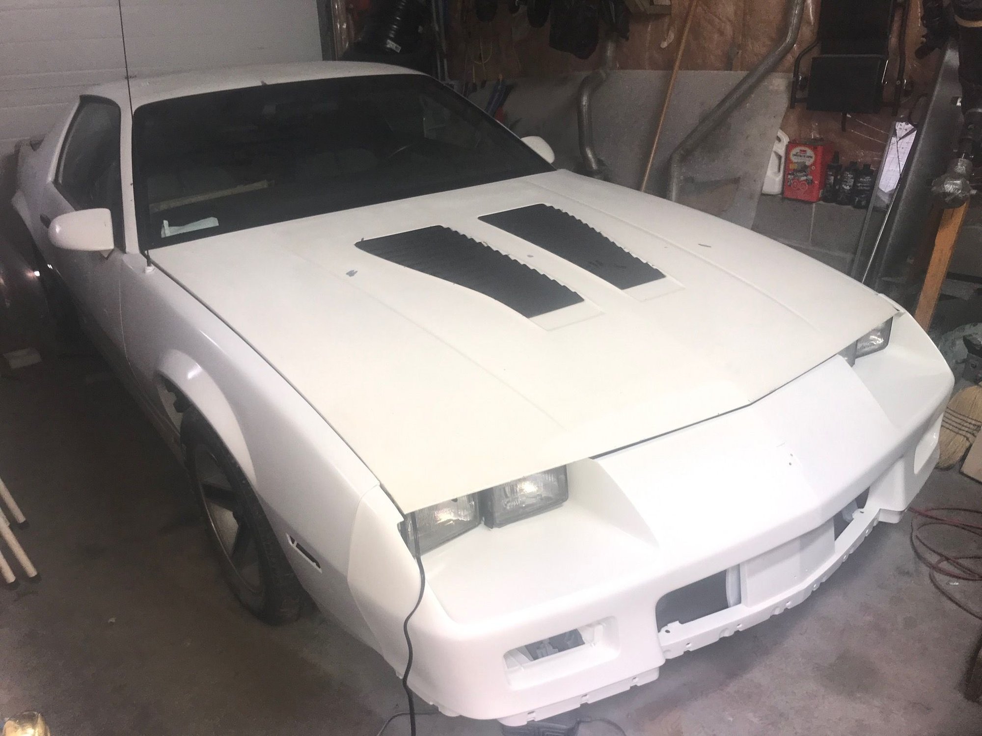

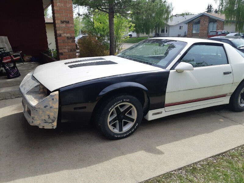

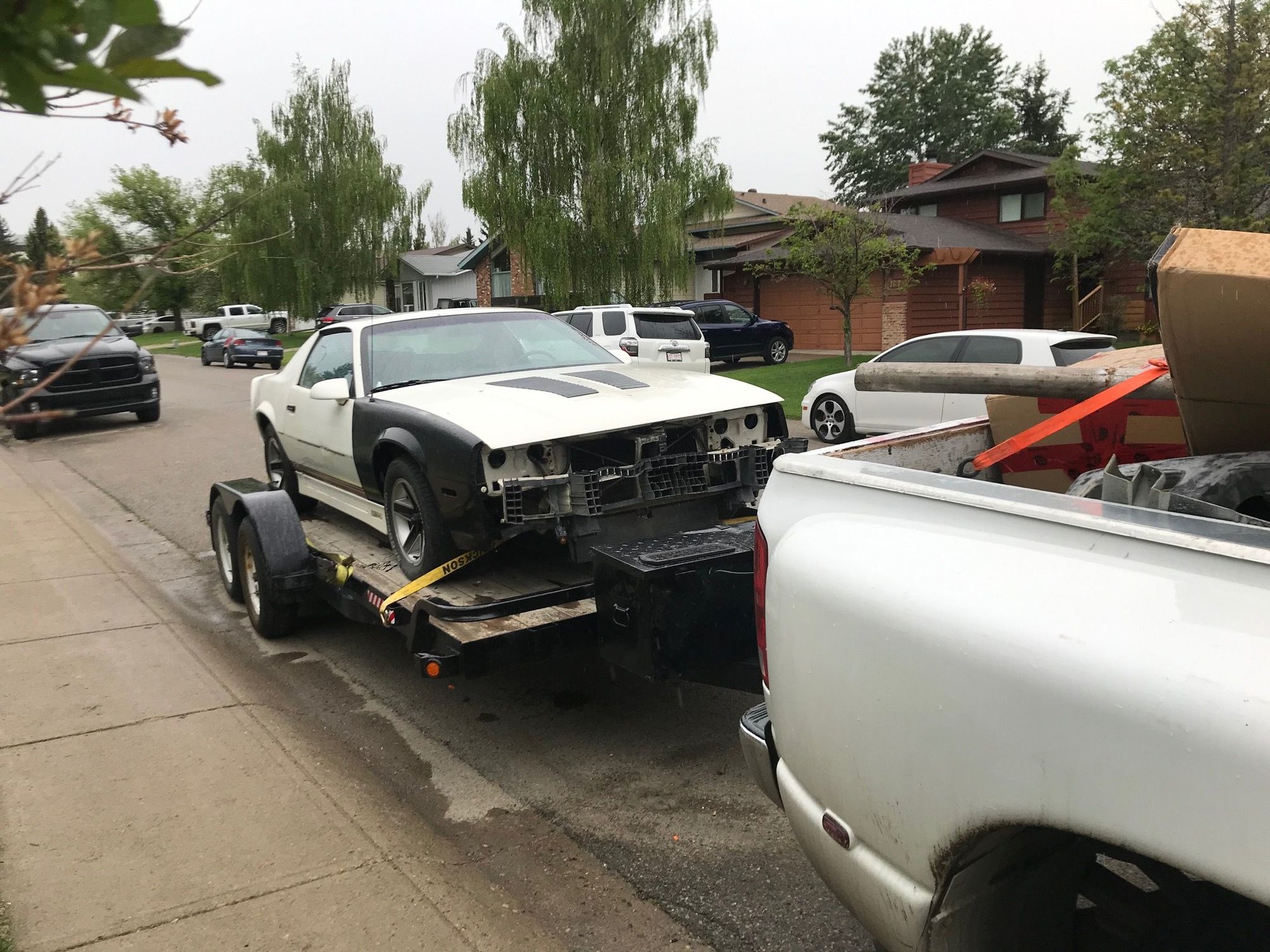

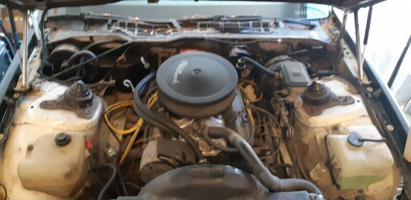

Heres the car:
The AD said $3000 and "includes extra parts" and that was it.
It was a treasure trove.
The "extra parts"
A complete new interior still in the boxes and the stock interior isn't bad!
brand new control arms and panhard bar with Poly
The 305 was just overhauled and it was nice job AND has new Hedman Hedders
All new weather stripping still in the box
A complete new stock exhaust system end to end
800 page service manual AND 800 page parts manual
And he threw int he solid steel Camaro! Everything works.
Seller was my age but just ad major surgery on his right hand and said that was it he was done. If he'd listed those parts in detail he'd have got way more. I think I scored well.

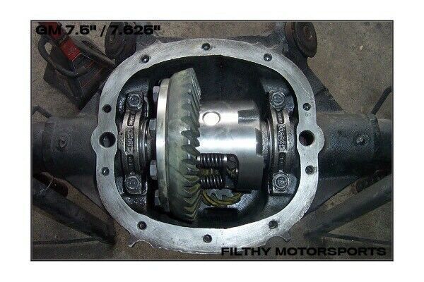

KIJIJI in Canada is great. Don't know if its the states. I'm sure KIJIJI or the equivalent is there. Chevy in great shape is abundant.
As our esteemed colleague notes a 7.5 is a pretty flimsy axle. I'm certain for a 350 hp 400 ft lb small block it can be manageable. There's a great post on 7.5s in Tech right here!
I have the Poly control arms and panhard bar with the car. I'll get the torque arm poly piece.
I planned from the out set to go Eaton posi 28 spline, GM or Richmond gears at xxx ratio and Moser 28 spline axles.
Weld the tubes into the pumpkin (three short welds) and a gridle and a solid bearng spacer.
2 days ago I scored this from some old racing pals for $280 bucks. Its from an 88 S-10 and the Eaton is 28 spline.
Excellent shape GM 4.10s came with it so why not? other than smaller tooth area? I will not be shocking it and will have overdrive.
I think I'm on the right track with securing the flyweight rear axle.

The 7.5 GM 10 bolt is a horrible performance rear end. There is no debating it. You can search for videos on YouTube of stock-stockish fourthgen Fbodys breaking the rearends. The problem also becomes logarithmically worse as your rear end gear ratio becomes numerically larger. The 4.10 gears are very weak--you can also search for comparative pictures of the gear ratios of the 10 bolt that demonstrate this. The ten bolt is usually adequate for thirdgens that will not use sticky tires and will not be making over 300 hp and will just be cruising around town. That's it. If it is a money issue than throw a stout rear end cover with the girdle caps on and take it easy until you can get a performance rear end.
Well thanks for your concerns. And you can search these sites for hundreds of guys who run waaaaay more power through them, successfully, than I'm considering. Of course there.s no videos of them NOT blowing up.
Is that 300 hp rear wheel or flywheel? Is that 300 hp with what accessories? Is that with automatic or standard? Is that with a trans brake and a 3000 rpm launch? Perhaps you could ask the administrators to flag the "beefing up the 7.625 10 bolt" in the Tech help section?
FWIW a 175hp 305 with a standard transmission can be wound up to 5000, dumped and blow up the stock rear end. A blanket "300 hp" statement is kinda of low info.
No question the 4.10s have too many teeth LOL. However I can and will tune the 350s Roch to come of the line off idle about 800 900.
I'm building it up for broad range, low end torque band 2000-5000 rpms or so. 1 hp/cube. carbed is not that difficult to build too. 380-400 ft lbs....flywheel and including. Peak HP around 5500.
You can't beat an Eaton Posi and it is a 28 spline. I may or may not run the 4.10s (they were FREE and came with the Eaton.) and may go to 3.55s as the 700r4 has a really low 1st. I will get Moser axles, I will weld the tubes into the pumpkin, I will run a solid piece where the crush sleeve goes so the pinion doesn't walk and will run a girdle and already have poly bushed control arms and panhard bar.
13.0 and 100 mph is the goal however I will be at 3000 ft air density.
Still think it'll grenade?

Why yes I do. The problem is still the physical size of the gears. The 10 that came in our vehicles is not strong and nothing you do will address it's main weak point, the gear size. You're going to dump a time and money in a 10 bolt and by the time you're done you could be at least 1/2 way towards the cost of a real rear-end. But you sound like someone who has made up their mind on everything and nothing anybody says is going to change it so I'm not going to waste my time posting pictures and links and explanations. I hope you're able to enjoy the car without too many frustrations and money.

Thanks again and I'm not hell bent on anything I just think while your "right", your also wrong regards just how limiting it is. I'm running 350 flywheel hp. and still may back off the gears to 3.55. tho early math through the traps still likes the 4.10s.
I kind find just as much support as you can find detractors. Quick search just now...Super Chevy article used a strengthed 7.625" 10 bolt w/4.10 Richmond gears behind a hopped up LS6: " it can take up to about 400-450 with drag radials so if you're not making more than that don't bother with a new rear. ..... and don't dump your clutch at 5000 rpms with slicks." Co-incidence I already said that!
I'm fully aware of its limitations and heard similar stuff 20 years ago when I ran a carbed only 515 hp and a torque monster 520 plus ft lbs thru a 10 bolt 8.5. ( BTW off idle automatic 3000 stall) Same basic treatment on that axle and ran 11.56 and 1.58 60s on hot sticky drag radials in 3500 ft air density. That's about a 10.80-10.90 at sea level. It never even gave a second thought much less any problems after 6 years and 350 passes.

100 MPH in a 3650 lb chassis (this is what my coupe weighs with 200 lbs of driver and a half tank of fuel) can be done with 1HP/CI goal. If wouldn't take much to exceed that 305 HP either and still have the other qualities you're after. I bet you could tune the carbed 305 with the 700R4 and 3.54 gear to better than 25 MPG (CDN gallon) on the highway. My big cammed 350 has knocked 24 MPG steady state highway at 120 KPH between Edmonton and Calgary.
FWIW, regarding the rear end, the somewhat stronger 9-bolt these cars also came with got me into the 12's with a slight stall converter and McCreary Road Star treaded "slicks". The 3.70 pinion broke on that pass but had seen dozens of drag strip launches prior to that. 60' times started out at 2.0 when the car first dipped into the 13's at 100 MPH. Eventually getting to 1.78 60's, 12.96 @ 106 over three seasons of test and tune. Then it went bang. Swapped in a 3.27 gear in the same axle and went another couple of seasons getting the 60's down to 1.7 flat. There's not a lot of difference in strength between the 7.5" 10 bolt and 7.75" BW 9 bolt so your diff might go a long way.

Re: Putting the Z back in an 85' Z-28 project

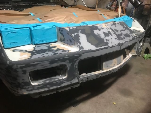

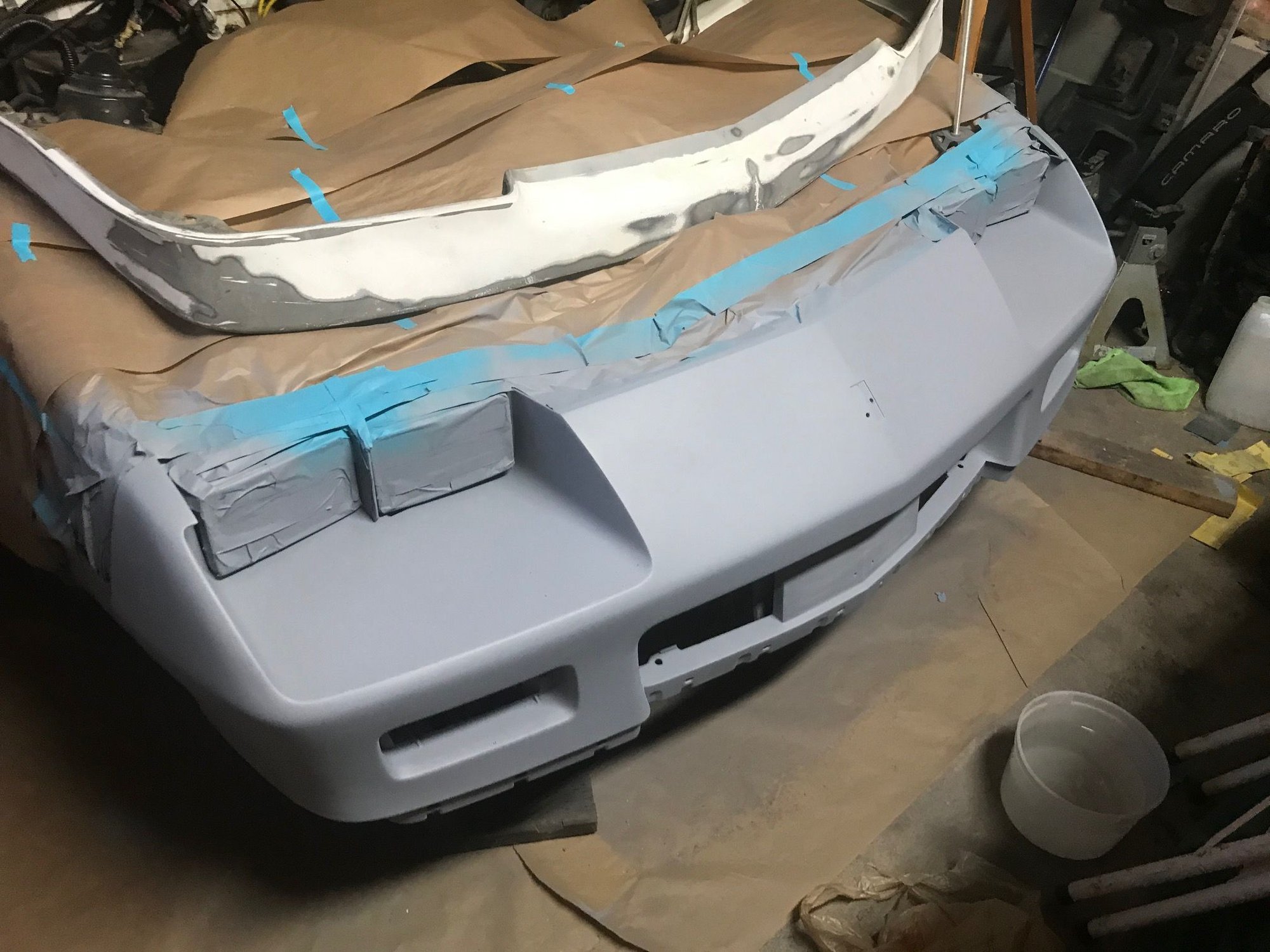

New pics. This is what I've accomplished in the past month besides scoring a few parts deals.
Rattle can!!!
About 5-6 hours sanding at 220. Carefully washed and cleaned it then tack clothed. 7 coats each 1/2 hour apart. Not a run or mark in it. Its been nice and warm out so it should cure well. Hope to finish sand primer to 800 next week. On the other hand I hate body work so who knows if it even sticks!

Nice work on the front end. I've a couple that need the same treatment.

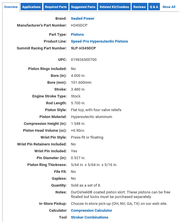

Skinny................... 377 ci and you can use your current 3.48" stroke rotating assy. You just need a 400 block and new pistons. Match the piston weights and you're good to go.
Funny you should say that. That has been a part of the decision tree. I've been looking at the aftermarket 4.125" bore blocks and if this build reaches the most extreme application, that is open road event racing, the shorter stroke reduces the stresses on all of the rotating assembly. Something worth considering if I intend to be at or near WOT for many minutes at a time. I have to determine if my GM 5140 crank is up to the task first. I've encountered mixed opinions on that.
Last edited by skinny z; Jul 26, 2020 at 08:11 PM. Reason: It's a 5140. Not a 5340!

I have all my pieces for the rear axle together or on the way.
Eaton 28 spline posi and Moser 28 spline axles
Crush sleeve eliminator from Yukon and a Summit Girdle with pins to support the main caps on the diff
4.11s GM original
New control arms w/poly
New panhard bar w/poly
poly for the torque arm point on the diff
Some parts came with car, got a screaming hot deal on the \Eaton and Gears from kijiji and the Mosers and Girdle are new. As far as budget hot rodding goes I think I've done well with about $850.00 Cdn for everything and it should be as bullet proof a 7.5 as can be built.
I work for a Diesel truck shop and can get the tubes welded into the pumpkin easily and all the assembly. ( I've done about 2-3 crown and pinions in 40 years so I will defer to a few guys who've done waaaay more than me to set it up)
I have no idea what the max power I could run through it is however I'm very confident a street/strip 350/350 won't over power a set up like that. In fact I've mused about going 400 CID and still have plenty of time to think it over.

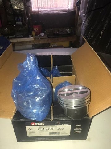

The over-achiever in the lot was the 353: (4.020” x 3.48”),
10.05 SCR / 8.08 DCR,
5 cc Speed Pro hypereutectic piston,
stock rods w/ ARP bolts,
.030” deck (block undecked),
670 Holley,
RPM Air Gap,
Vortec heads. Decked .006”. 63 cc,
Comp XR276HR. 276/282, 224/230, 110 LSA, 106 ICL, 64 ABDC IVC,
Victor Reinz 5746 head gasket .026” x 4.120”,
Mid length headers, full 3" single exhaust,
Cranking pressure 185-190.
Daily driven. Good highway fuel economy. Went mid 12's @ 109 with the usual collection of other drag strip bits: Converter, 3.73 posi, drag bags, adjustable rear LCA mounts. Stock chassis otherwise.
The biggest deal, aside from traction (as the tires eventually went away over a few racing seasons), was the weight. At 3650 with a 200 lb driver, half a tank of fuel, glass hood, Spohn SFC's, iron heads, and a full interior, it certainly wasn't a lightweight.
Personal best with was a corrected 12.49@109. With a 3000 DA on that day, best time slip was 12.93@ 105. 60' was an abysmal 1.85. It had ripped off successive low 1.7's with better tires.
Since then I've stepped up with better heads, more cam and looser converter but something's coming undone in the engine (high RPM miss and some unusual tapping) so I haven't been to the track with the new combination. Might be a while too.

Paint up date #1 all rattle can, mixed to match at body shop supply store. Then 2 part w/hardener rattle can clear coated and a month later its tough as nails and looks good for me to work on the power train now. Lots of careful cleaning and tac clothing between coats and stages.
Before and after and actually its all now attached and the lower fairings on it.

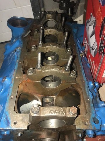

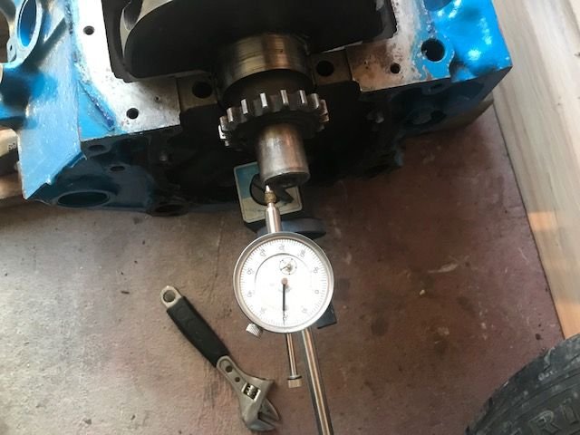

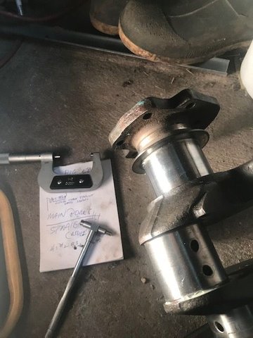

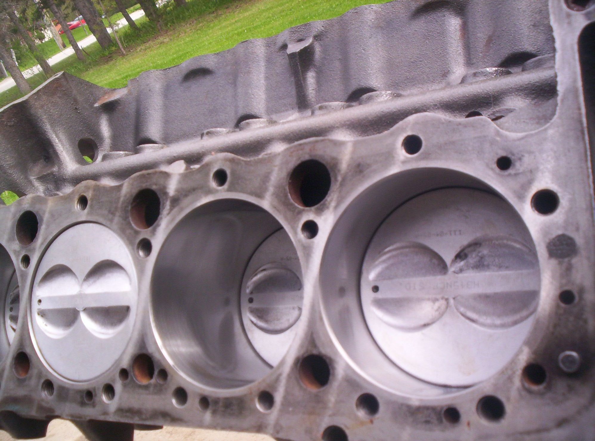

Heres the 355 I will use in the Camaro

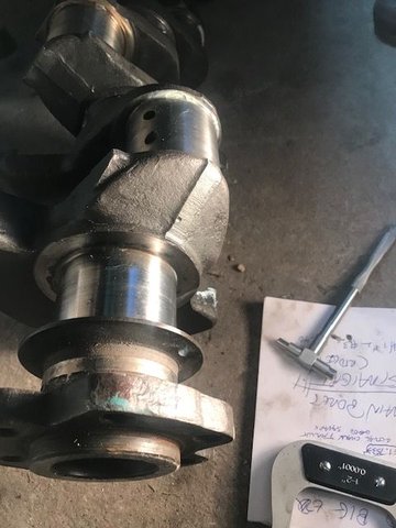

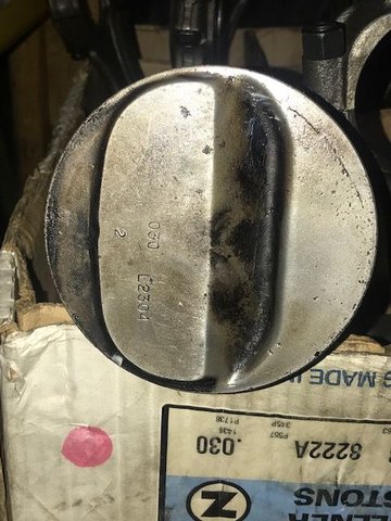

Typical 010 casting, 4 bolt block, clean, .bored 030 over and every bore is on the mark 4.030 -4.0305. Mains measure great and straight holds a .001" feeler strip on the saddles. Was very recently overhauled, run briefly??? and torn down due to excess end play.
Forged steel 1178 crank M.020 near max and rods .030 also near max. The Con Rod, side thrust clearances on all 4 throws are all good about .012-.014. The main bearing at the thrust end was worn away at least .020 on one side and yet there is no matching damage on the crankshaft main thrusts at all. Don't see it often, but I can't find anything else wrong on the crank in spite the main bearing thrust wear, And M .020-R .030 or not it's a nicely done crank.
Good rods and they measure great on big ends.

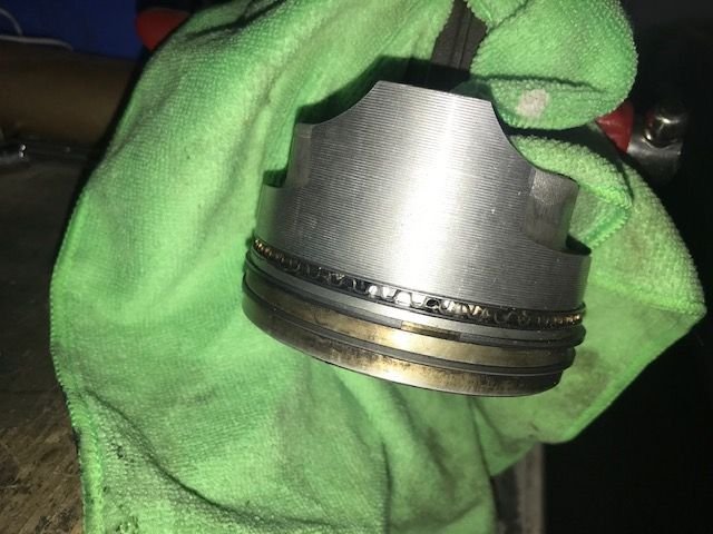

Forged TRW L2304 .030 pistons , low domed and make 10.7 to 11.4 to 1 depending on how I approach quench. The piston skirts are mint, almost untouched. I'm unsure of quality due to inclusions in piston tops. I'm also a bit antsy due to them measuring ,0075-.008 piston to wall. I know you can get away with it using forged pistons but I still prefer a tighter .004" 005".

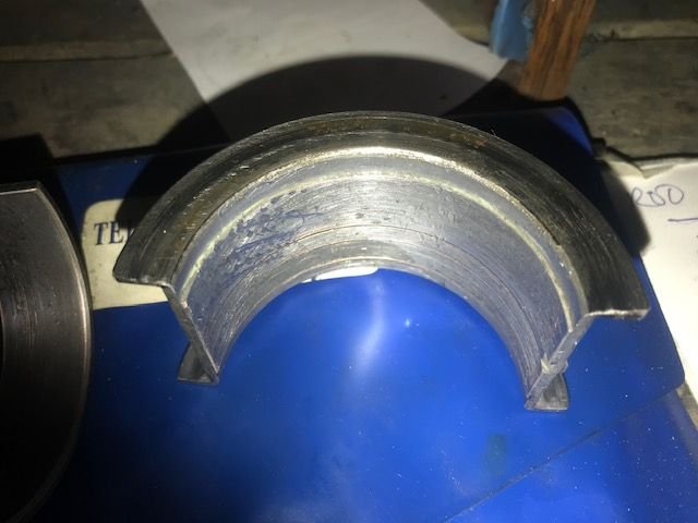

I mocked up the crank in the block, it all spun well on the used bearings and used then one rod and piston, switching from throw to throw to physically check the piston to deck height on all 8 holes. I got all 8 bang on .025" below deck as hoped for! This block is straight,square and has never been decked simply punched out to 355. It also has 5 screw in studs with extensions for a windage tray. They MAY be a problem as they aren't original and change the torque distortion a bit.
All in all I have a great usable 355 .030 block, that just needs a good cleaning and I have a very good, quite possibly indexed forged steel crank ( there is no blue at all and no dings at all, no runout and yet its Rods .030) with all the radii in good shape and apparently the end play is from the bearing only, as the main thrust surfaces are still nicely ground on the crank..
It's a good foundation I hope and the forged crank gives it a real "Z-28" touch as they would have featured this set up even down to the 11 to 1 pistons in the 370HP 1970 engine. No matter what I have a block, crank and rods and lots of options for pistons.

Wow 1/4" is a crazy amount of end play on any small block. I MAY be .024" however the crank thrust looks good and the block saddle also is fine. 1/4" may an exaggeration but easily visible end play is waaaay too much.

11.4 : 1 actually which is rather high in todays world and yet the cams the 70 era Z28s used were really wide LCA like 116 and worked on pump premium, admittedly of a type we can't get today. The 64 cc head chambers and the very slight dome (-2.4cc) are problematic to be sure.
I'll most likely use everything BUT the pistons. I just now used a feeler strip and even in perfect fresh .030 bores and the pistons with zero skirt wear I get .006" piston to wall.
I absolutely enjoy spending way to much time doing an assembly especially on an engine I also built (did the math for performance/select the parts). I'll happily make a 6-8 hour assembly last twice as long and anally measure everything.

The hits just keep on coming!
Picked these up last week from a farmer near New Dayton Alberta...$50 Cdn.
Never used, band new flat top hypers, that from Summit, with duty (AND with an order over $300 US to get the free freight) these would have been at best $180.00 or so. He said when I asked, he bought them from a friend and he had a Lethbridge Auto Parts receipt for $240 and GST. He took his block in for machining and the 1st hole didn't clean up until .060" so the .030s wouldn't work.
He put them on KIJI as "350 pistons" no mention of Chevy, Chevrolet, SBC etc. so they were on a while and no one else stumbled across them. I got lucky.
I have already let them match the blocks temp in the garage and then checked the clearances and they are bang on . A .001 slides easily annd a .002 sticks!
Just a reminder my block is a perfect 4.030-4.035 and no ridge at all they were just done, which is one reason I bought this block.

Nice score. I may have to get you to shop for me!
Those are the same pistons I had in my standard 350 when I got back into the hot rodding game a couple of decades back.

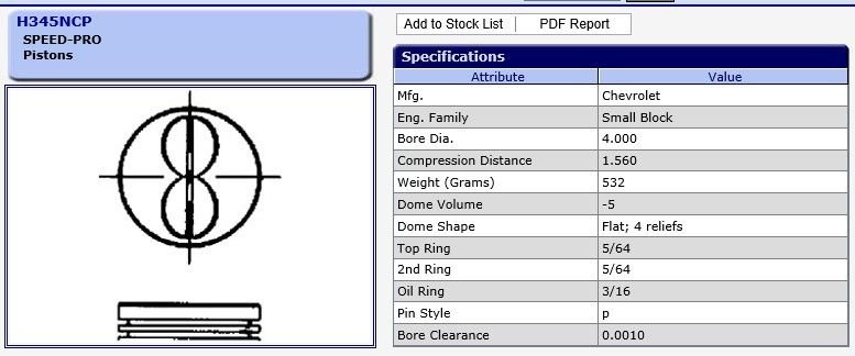

Uh-oh, those pistons just might be the rebuilder type where the compression heights are .020" less to compensate for the assumed block decking.
If so, there goes your quench.

Hmm. I just noticed the slightly different part numbers. H345NCP vs H345DCP.
Along with a difference in compression height. 1.548" for the "D" version and 1.560" for the "N" version.
Yes, and the N version is no longer available.
