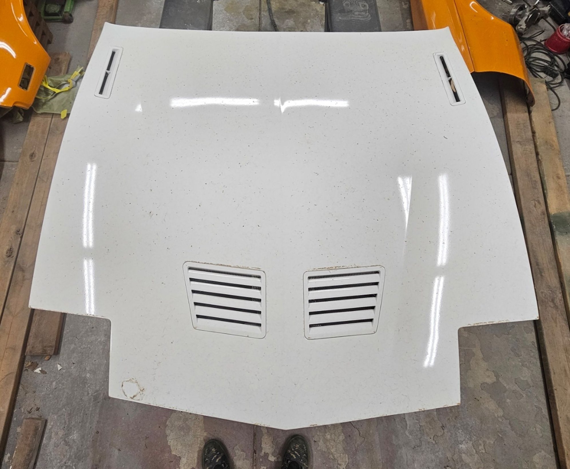

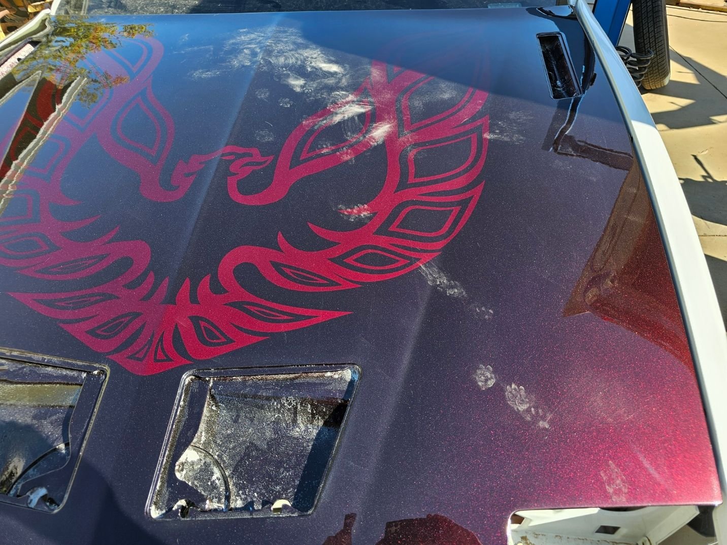

way back oct 2016 this hood was in the very same spot getting the same treatment.
Sanded and prepped for new paint..
9 years ago.

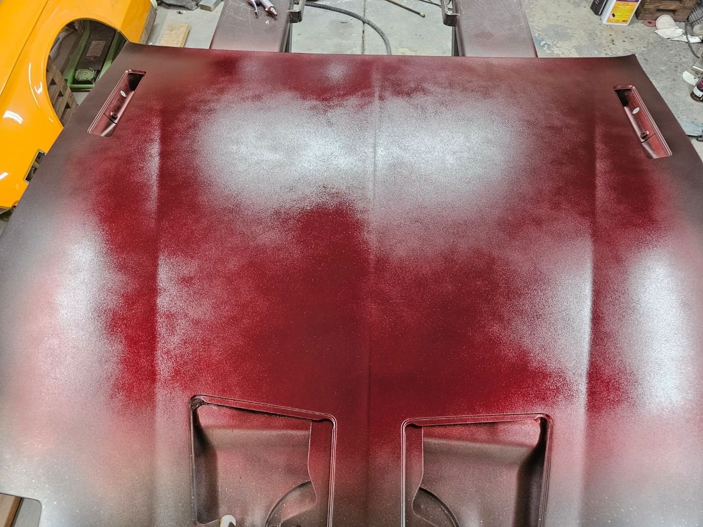

So i had ordered the corvette color posted above, and i sprayed the hood hinges.
The color looks nice, but had a purple look to it.
So i have been looking around and found a custom color that i believe has more of the dark red pearl im lookin for.
So, i got to thinking about the hood bird, i have always wanted one, so i found a decent one i think $57 dollars on amazion..
Then i needed to figure out what color to do the hood bird in. I didnt want bright and stand-outish like the Bandit cars, i wanted the bird to not really be seen unless you were close to the car.
So i had some gold laying around, i added big gold flake to it and then based the hood in it. From there i mixed up some HOK red apple candy and sprayed 4 or 5 coats over the gold. Gold will make a darker red than silver would, and the big gold flakes will add more sparkle to it.
Let it dry, laid out the 3 piece hood bird, with centering the 'head' first. Then the wings. Surprisingly easy. I really figured i was going to have a helluva hard time with it..
Then once the bird was one, i mixed up some black base to cover the hood, and then the new custom red paint to go over the black.
I then mixed up some 'cold weather' clear i had laying around and blasted on 2 quick coats. Why cold weather? It was some left over from another job, and It'll get sanded and recleared in a day or two. Got to remember, this is 'custom' graphics and paint work, so there are now 2 layers (black and then dark red top coat) over the hood bird. This will make hard outline, so the 'cheap' clear if you will, locks down the graphics. This way no harm can happen to them.
Once the hood sits for day or two, ill knock the clear down and add another 2 coats to it. Eventually when i paint the entire car, the hood will get sanded with 600 nice and flat, then the base coat can be blended from the fenders onto the hood to make sure it matches. Then the final clear on the entire car.
I'll get the hood out in the sun tomorrow and post up a few pics..

Real dark on the sides, nearly black.
Wanted more red, the orangish tone I'm not sure about.
Spoke with the paint supplier they are going to send me another choice to see if i like it better.
In a few days will sand the hood and apply 3 medium coats, from there will sand and buff.
Maybe it's not the colors, maybe it's the not flat glossy clear that is making me think something is off.
That is the fun with custom colors, you spray them, and then sit a piece in the corner or against the wall, this way you walked by it a few dozen times in all sorts of different lighting and get to actually see the product.
That is how i test a custom panel.

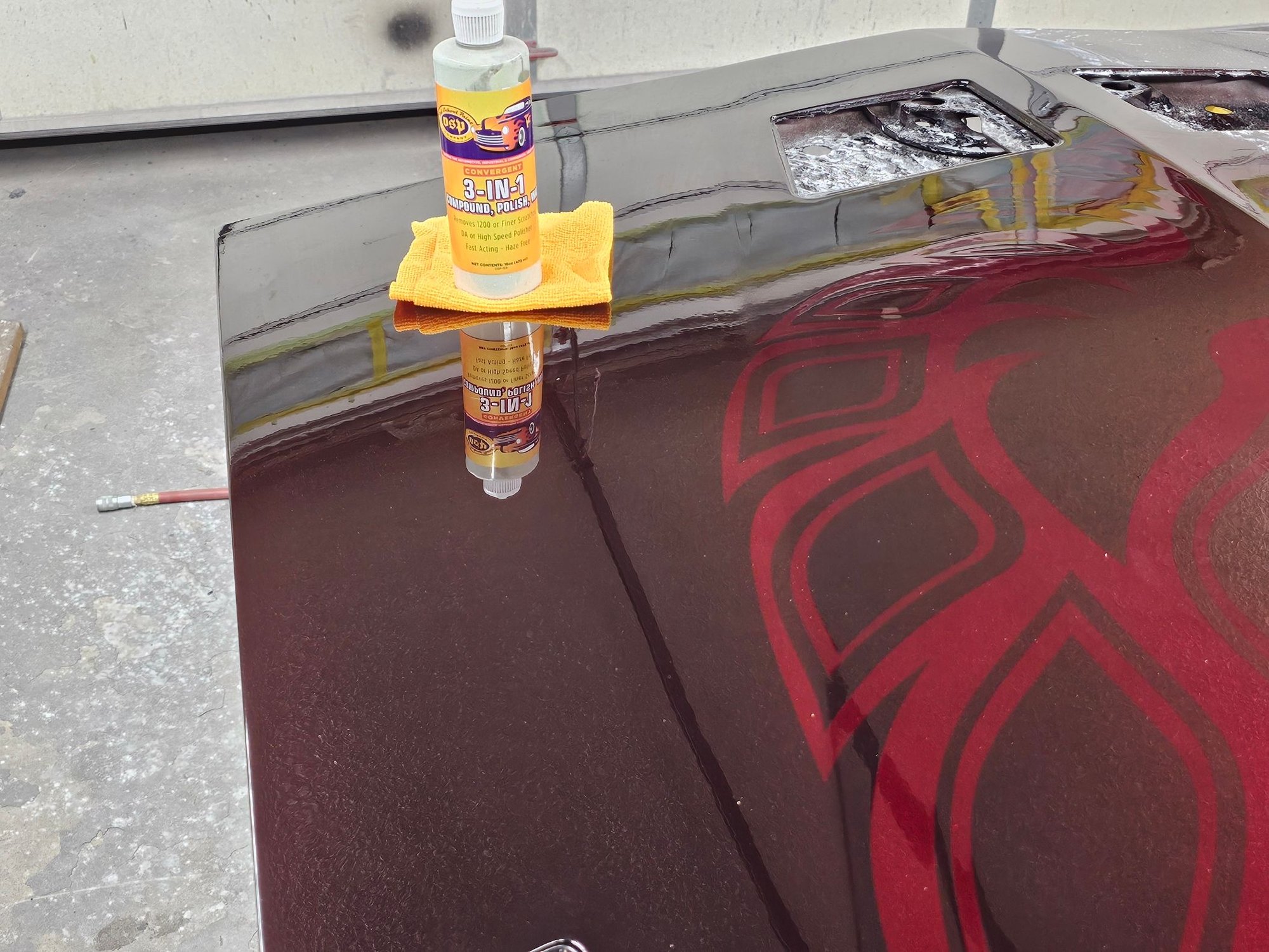

sanded the hood with 800 and sprayed 2 medium coats of clear.
Let it sit for a day or tow, and then sanded with 1200, 1500, 2000 then buffed.
The hood will stay like this now until the rest of the car is painted.
When the vehicle is painted, I will sand the hood down with 800 again, and then blend in the color bring sprayed on the complete vehicle onto the edges of the hood so the fenders and bumper cover all match and have no issues.
Then the car will get 1 light coat followed by 2 medium coats. Sit for a few days, then 800 the entire car, and then 4 medium coats of clear.
Then, 1200, 1500, 2000, 3000 then buff.
Then assemble and get to smiling...

I did a quick buff on the hood and took it outside in the sun. It's not fully buffed so you can see swirl marks and some not so polished areas, but this doesnt matter. The color change, and walk around is what matters and It is nice and dark on the side view, nearly black which is what i wanted.
In a day or two i'll pop off a fender and paint it to see how it looks not laying on the ground like a hood.
I'll post up a couple pics, but, if it looks like the hood does, i see no reason to not go ahead with this custom color.
Here is a video from an hour or so ago.

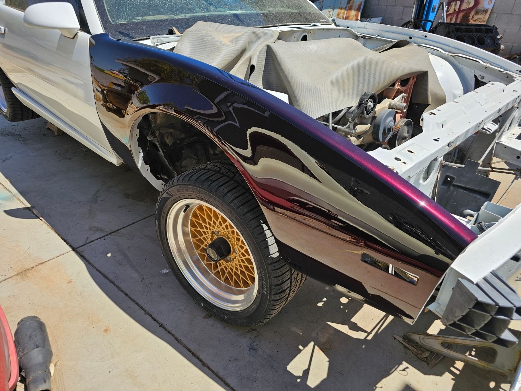

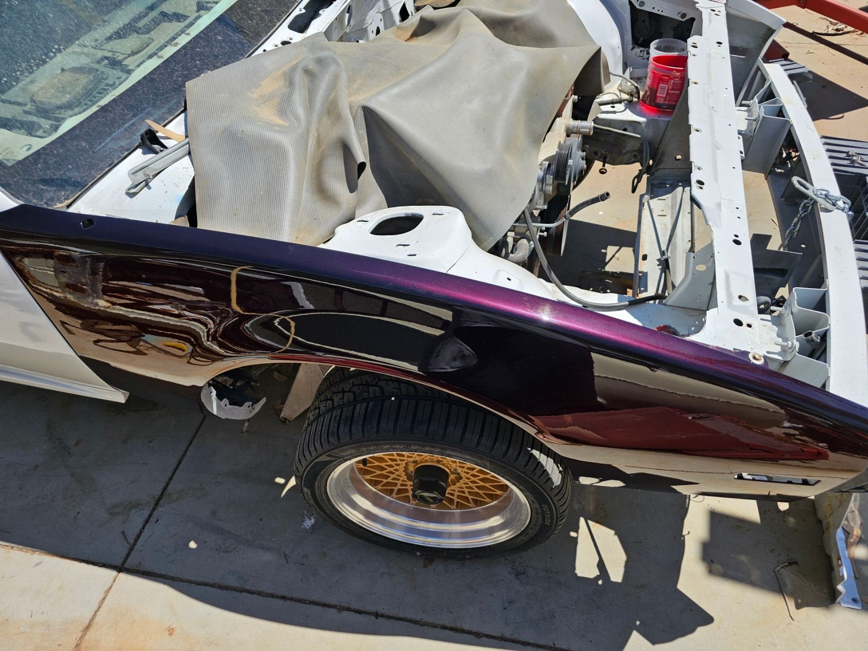

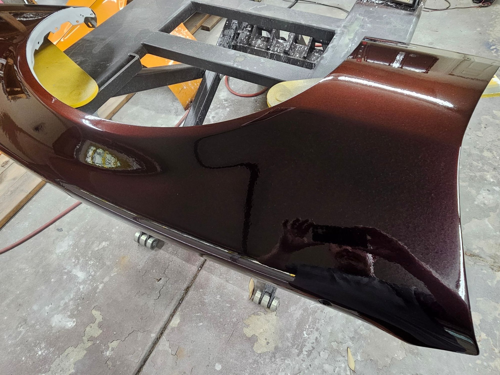

pulled off the passenger fender and sprayed it with the custom color.
I'll hang it back on the car in the morning, then sit the hood back on the car as well.
Then i can really see if i like it or not.....

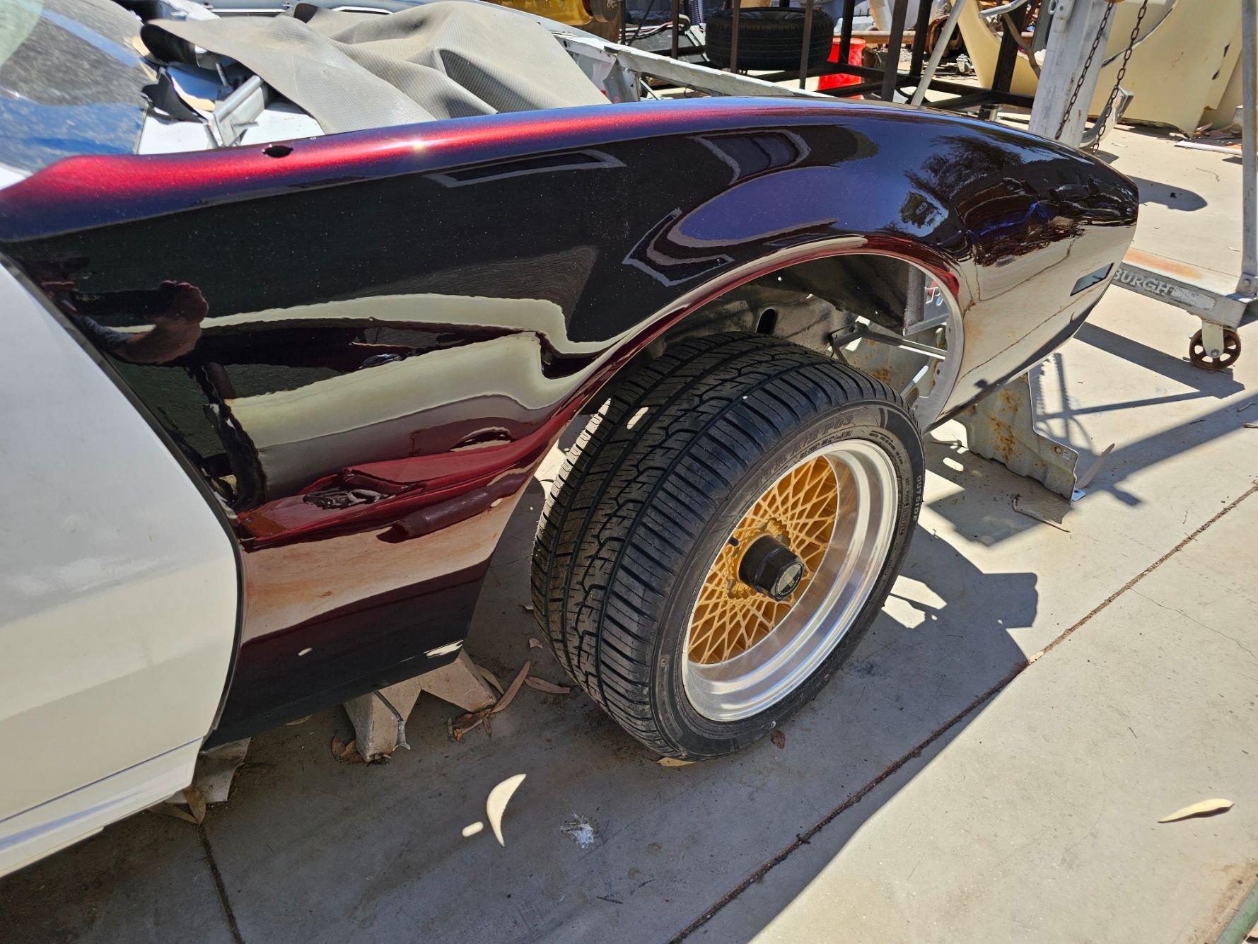

Quick buff this morning and put it back on the car.
I am starting to really dig this color.
Like a black cherry with a bit of a twist.
I'll get the hood sat on in a few hours, and get a few more pics.
But it is looking like this will be the color for the complete vehicle..

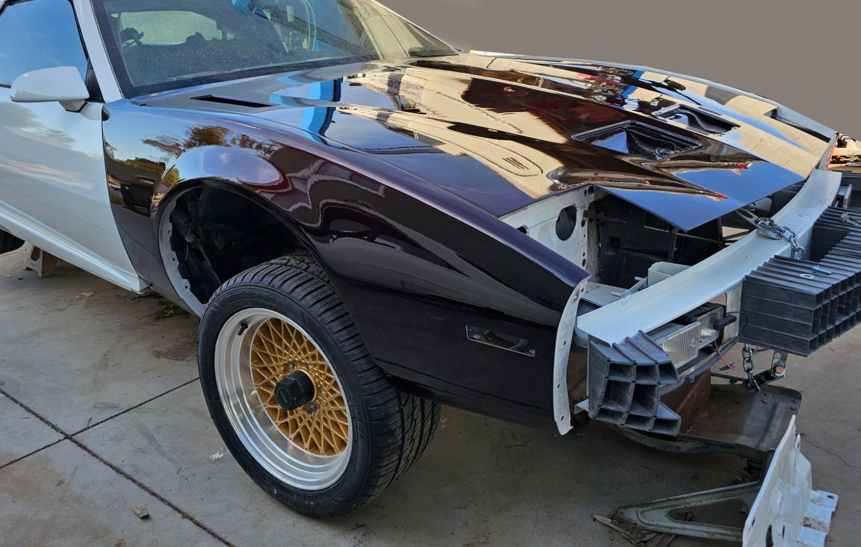

sun is going down so this is the look of the custom paint with no direct sunlight.
The gloss of this clear always amazes me.
And the sand/buff job isnt finished in these pictures...

Ok, thats an amazing color. And very unique, so you won't ever see that around much.

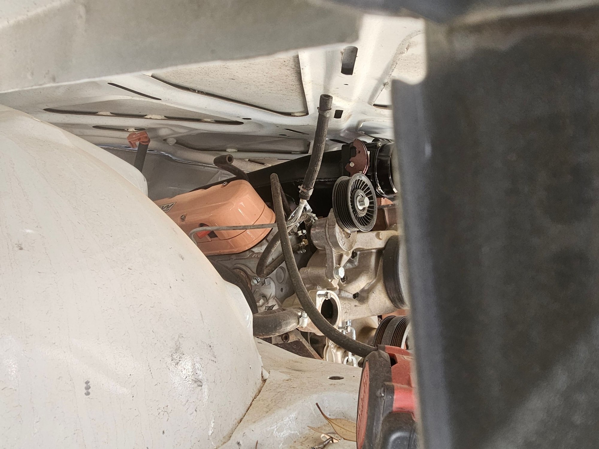

Re: MILD RESTO-2nd owner 1991 WS6 GTA

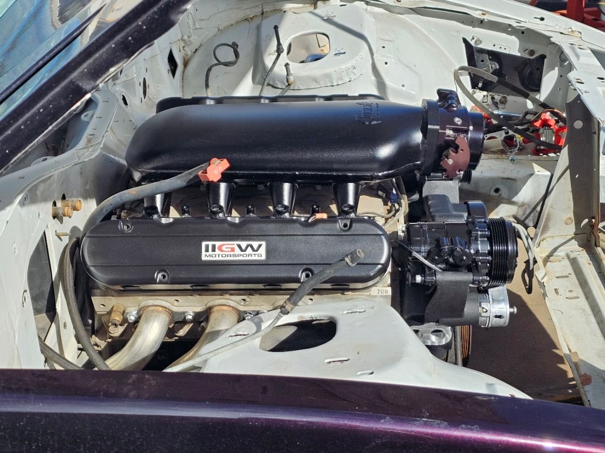

got a new intake and test fit it to the car.
has nearly 1.5 clearance from the hood with an after market throttle body..
good to go.
next is new ALT bracket and should be ready to start the engine.

Good thing the neighbor's cat didn't try to "claim" the hood! Not sure how well fresh clear coat wouldn't withstood that.
Posting on the forum has become less and less frequent for the last few years. Looking at the top post on each forum, and many of them are days old. I think most people just browse nowadays, which is kind of good, because it means they've learned how to search lol. But yeah, people are watching.
3rdgen VINs have standard prefixes. Firebirds and Formulas begin 1G2FS, and TAs and GTAs begin with 1G2FW. The rest of yours if fully visible, and the VIN decoder in the Tools at the top of the page recognizes your 1991 GTA.
Looks like you didn't go with Black Rose, but something close. Looks nice. That's been a Corvette color off-and-on for decades, including the C4. Might even be some C4 ZR1s in Black Rose. They tend to only be photographed in the daylight. It's a beautiful color, but the purple-ish tone was always the common criticism. One of those colors you love to see on the road, but it's, "great to see, but not for me."
I'm trying a few colors. The black rose was real pretty, just trying a few ‘custom’ colors first to see which I am going to settle on

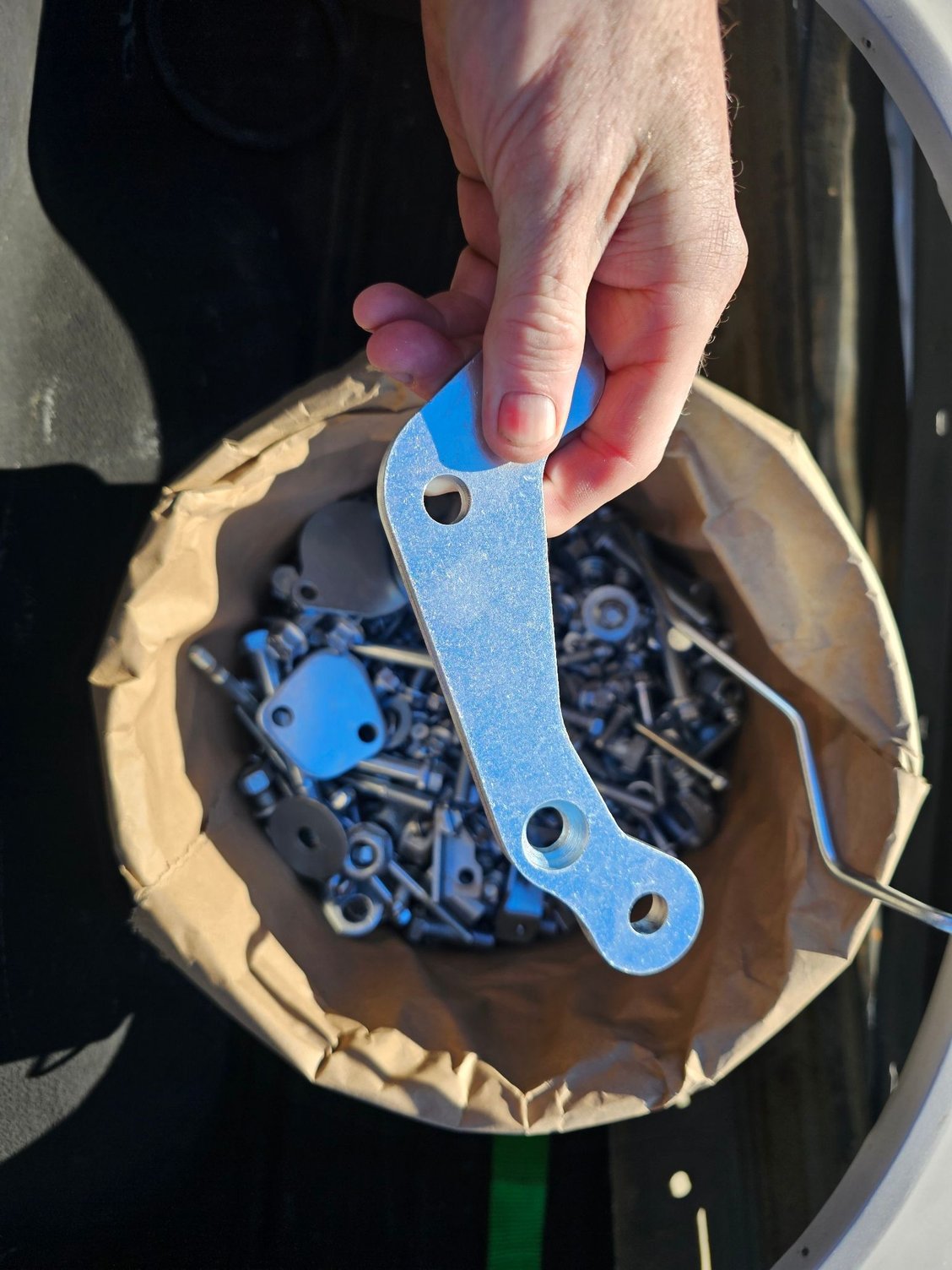

i sent a lot of parts out for 'clear zinc' coating..
my Big Brake Upgrade brackets look purty now.

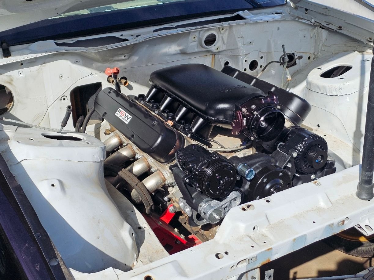

Big white box arrived, and even though i have been fighting a cold and have no energy, i was determined to put some pieces together to see how it'll look and fit...

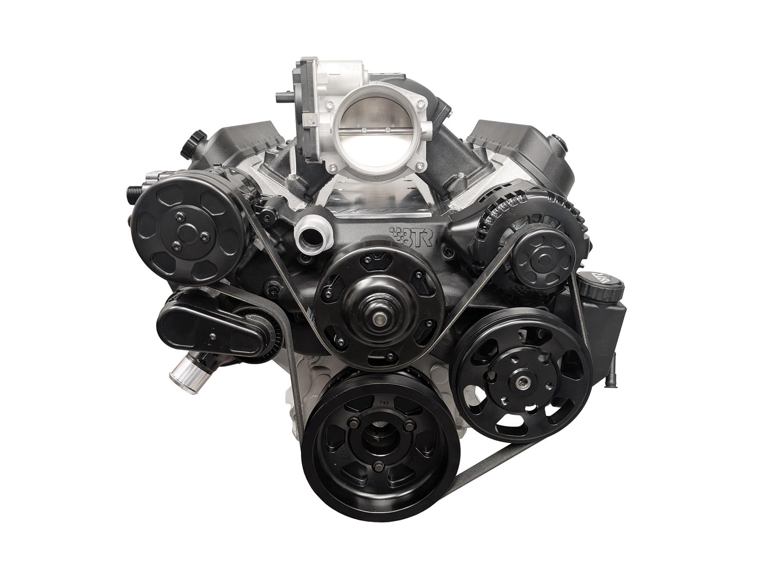

Man this accessory drive looks awesome! Is that Corvette or F-Body spacing?
Old Feb 24, 2026 | 10:54 AM
  #192
the made it special so it's inbetween those and you can only buy their parts. Gotta make money..
AI OverviewThe Holley Mid-Mount accessory drive system is designed with a unique, compact spacing specifically for GM LS engines, bringing accessories closer to the engine block than stock F-body or truck drives. The alternator uses a
5.46” bolt spacing. It generally uses a dedicated, tight-fitting bracket setup designed to fit within a compact envelope.

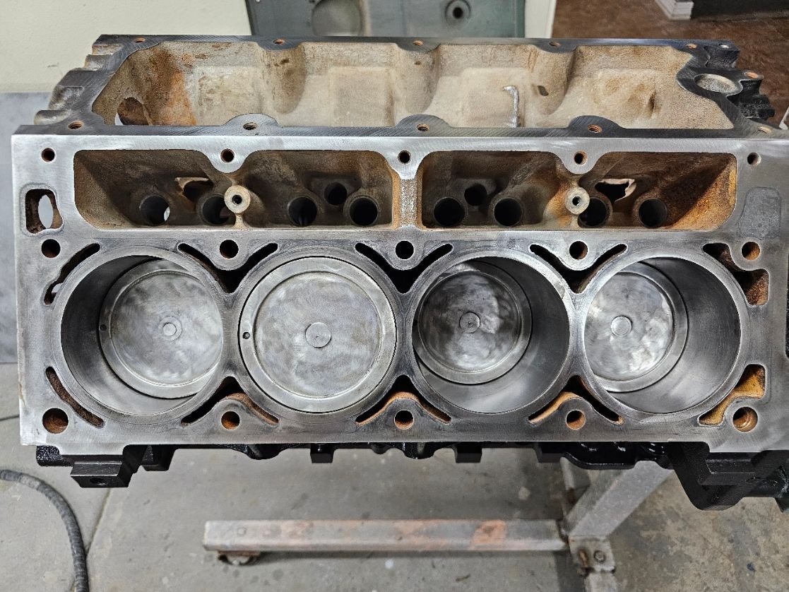

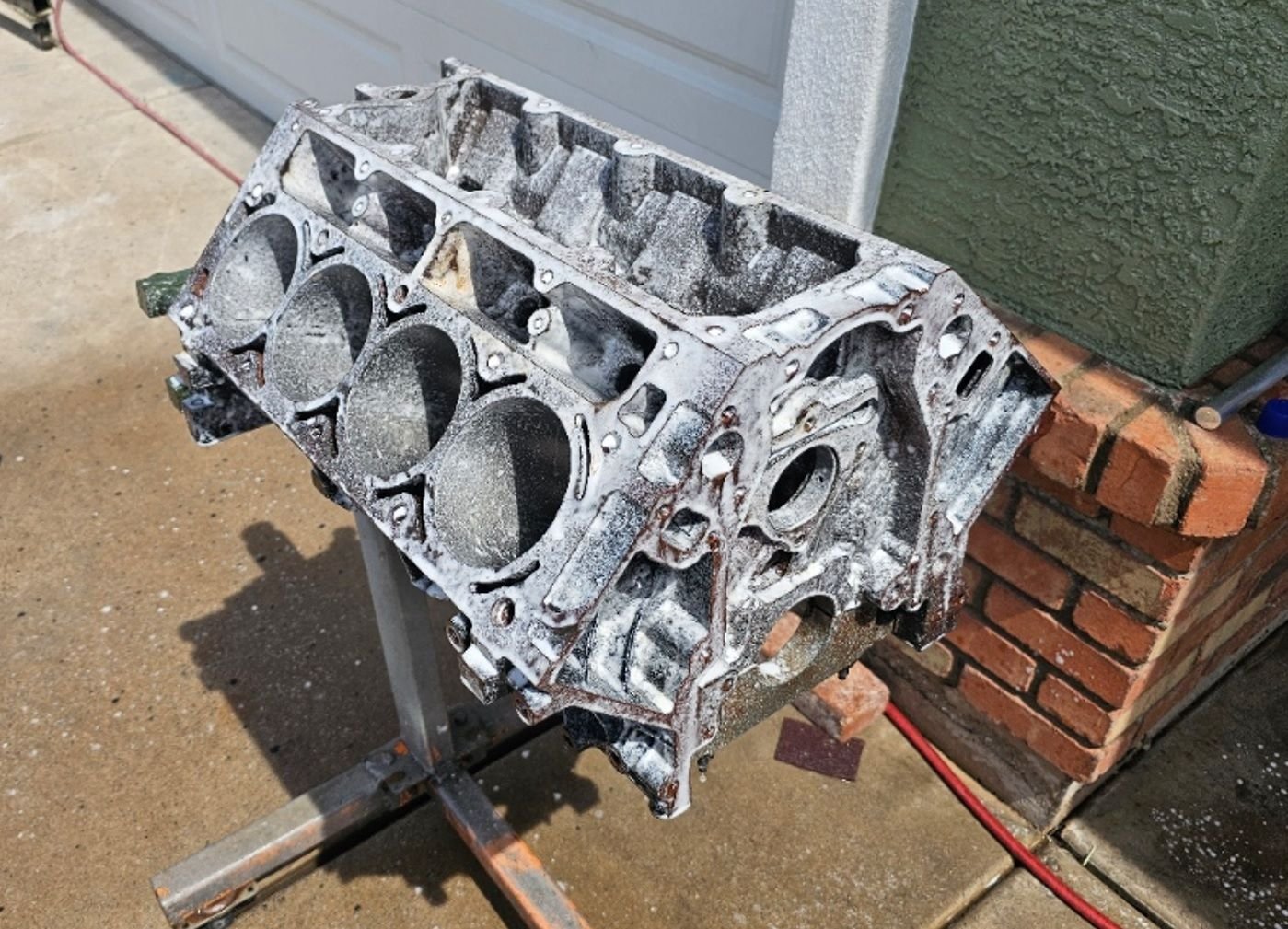

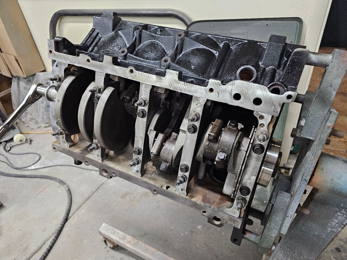

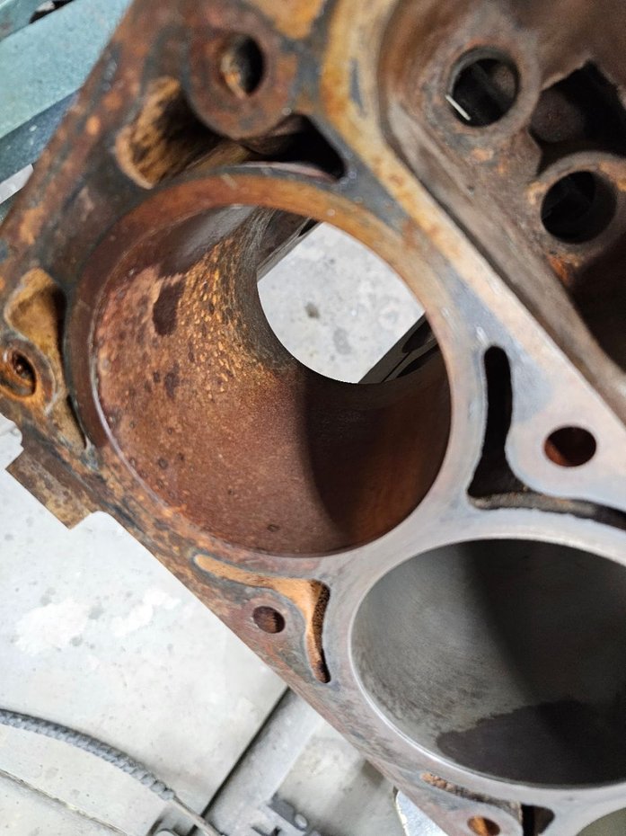

After a few hours of cleaning, flex honing, and some elbow grease, The short block is assembled.
I was able to use old parts sitting on the shelf, so, I have about $9 in engine cleaner for the rebuild.
New cam bearings, new rings, new rod/crank bearings, few coats of black paint
