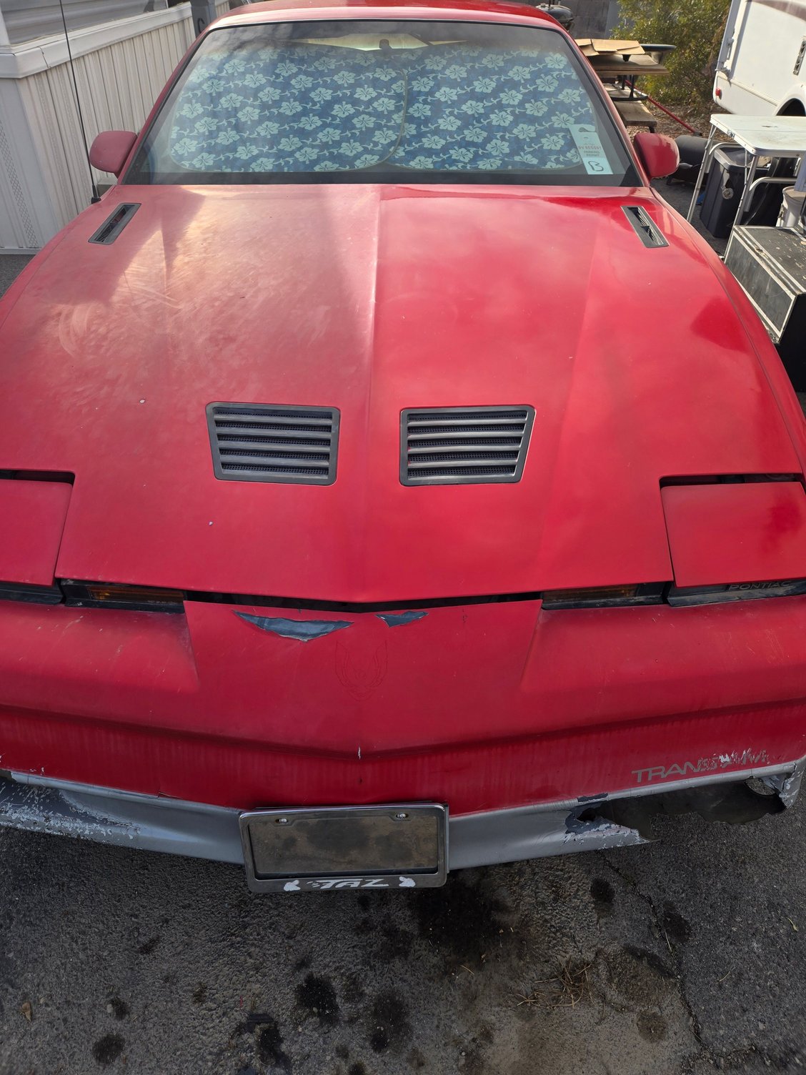

The car was mislabeled in the ad its actually an '88
Going to give her a well deserved bath then break out the polisher and a bunch of Meguires to see if I can get that "patina" OFF..
I will also do the engine compartment . Then I will completely disassemble the interior..
Needs a battery, possibly a fuel pump or an ICM

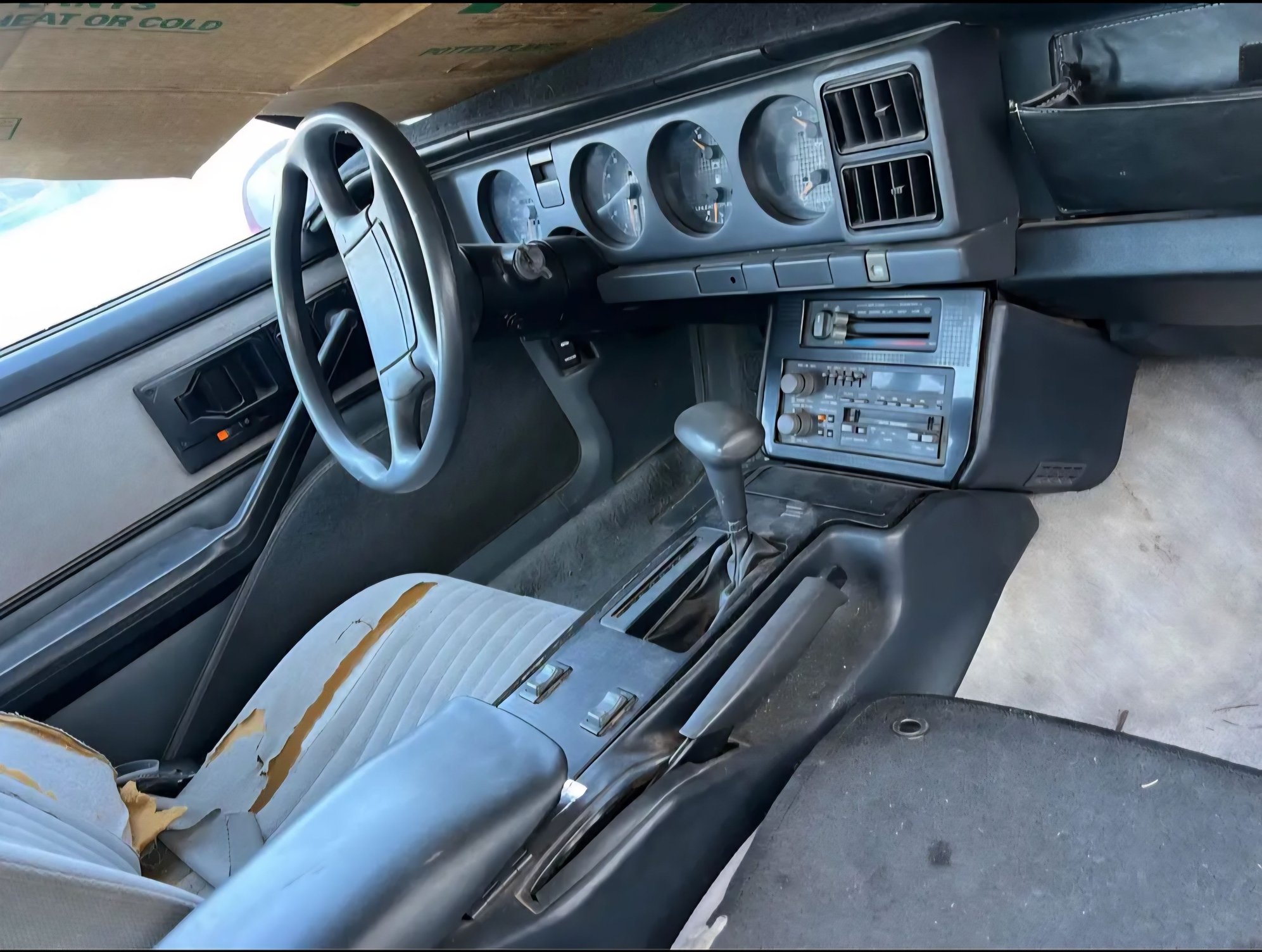

88 would've been my guess: 88-89 steering wheel, 88+ serpentine drive, 85-88 dash bezel, 88+ windshield washer system. 88+ air intake.
Optioned for performance, not luxury. Base seats and door panels. No Performance Sound system. No power mirrors. No rear defogger.

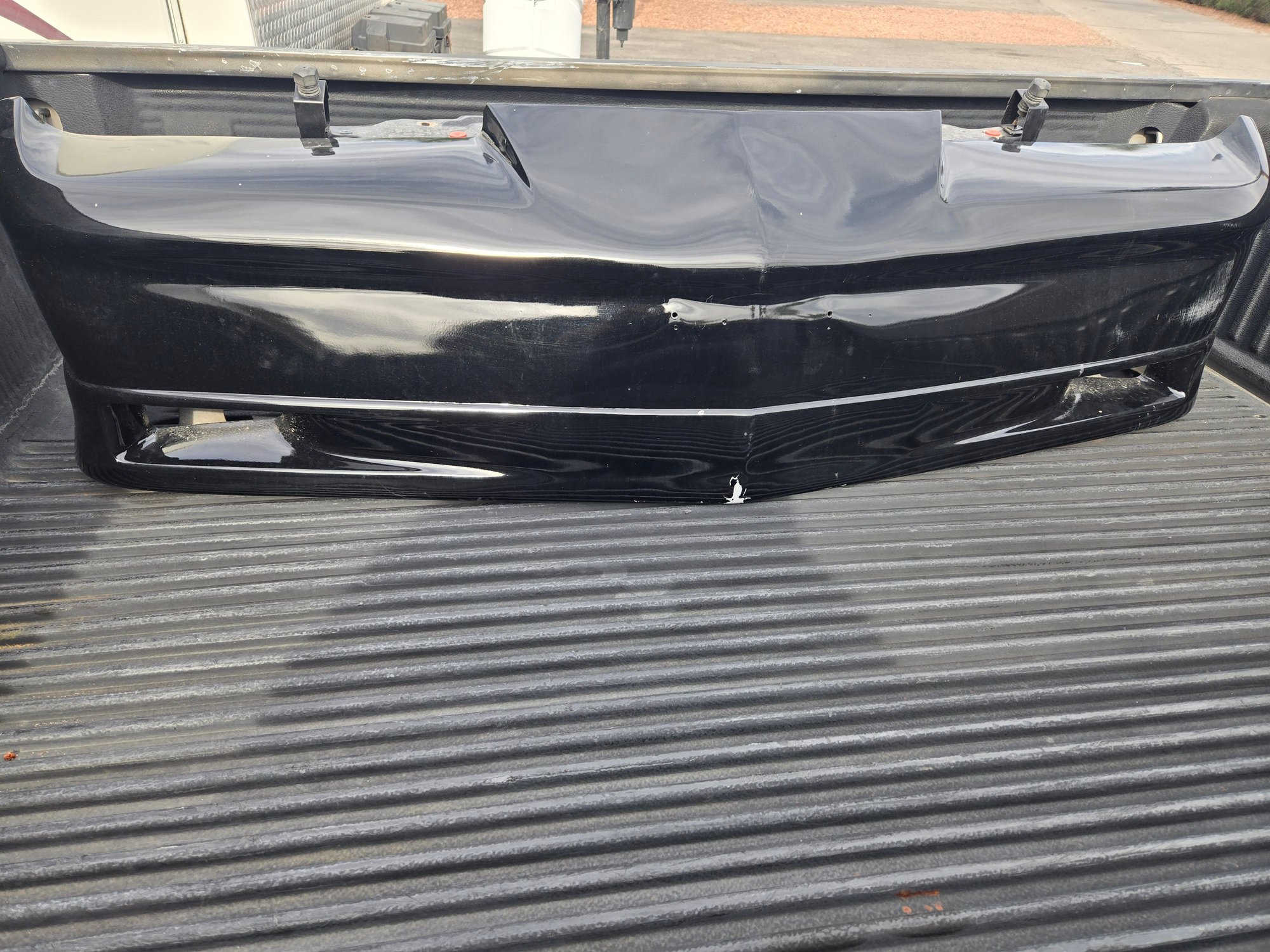

I was fortunate today, I found a cherry bumper cover. I want to put it on this coming week
but I prefer to have it painted first fingers crossed for the best.

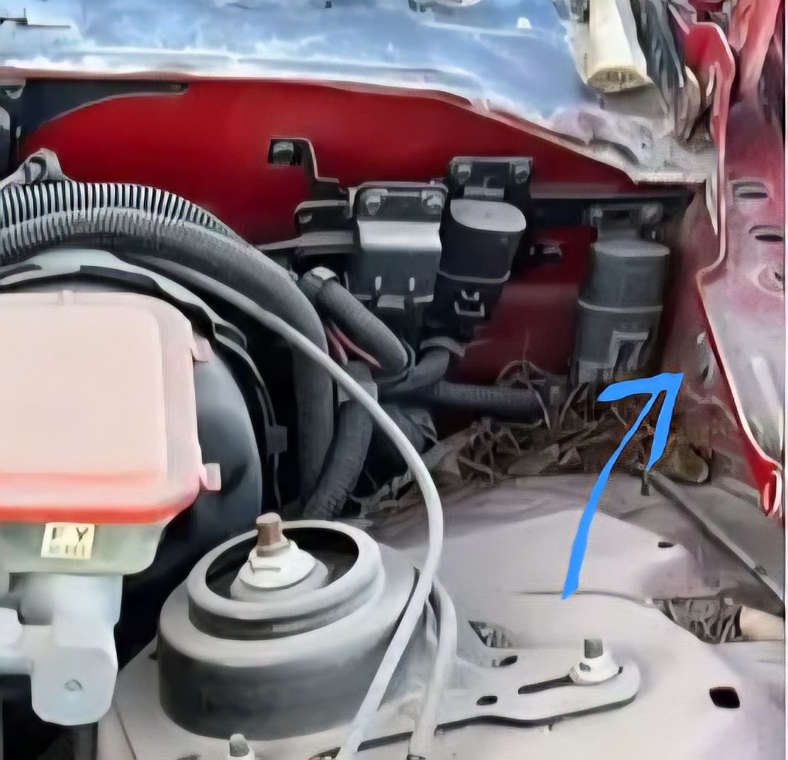

The previous owner said it needed a fuel pump but I found 2 ground wires that were disconnected from a ground. I believe these are for the pump relay still need to have keys made for this TA. A new pump is definitely going in anyway.

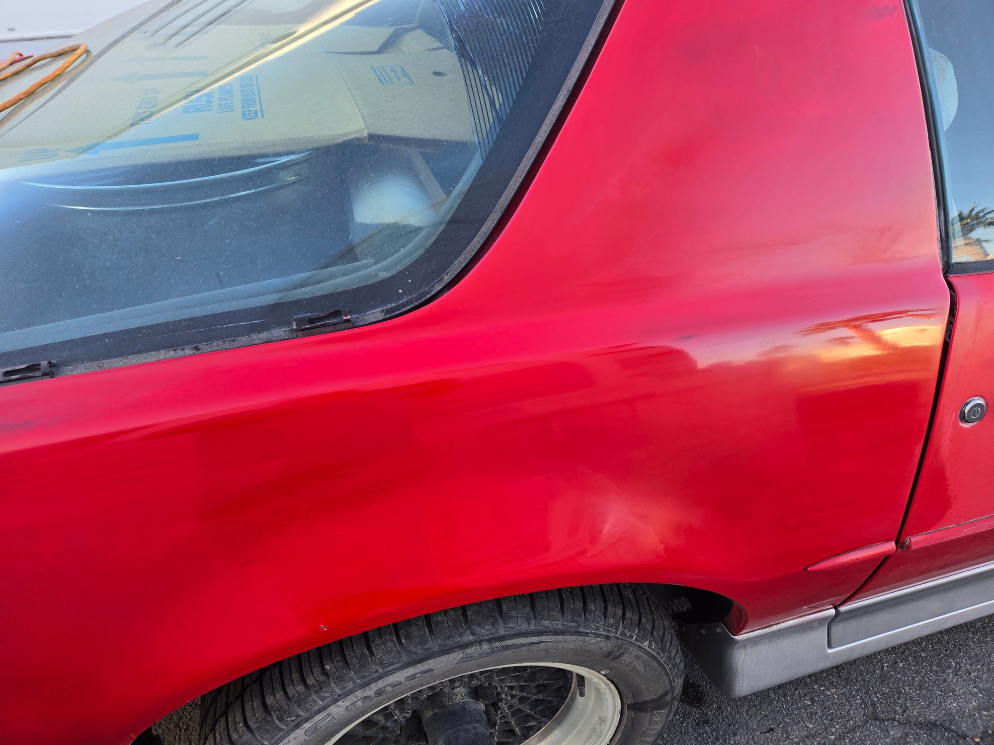

I have been able to get a little shine on the old girl but aftermarket cheap paint is not very easy to work with.
BEFORE
AFTER Meguires med cut

I'm watching this now.

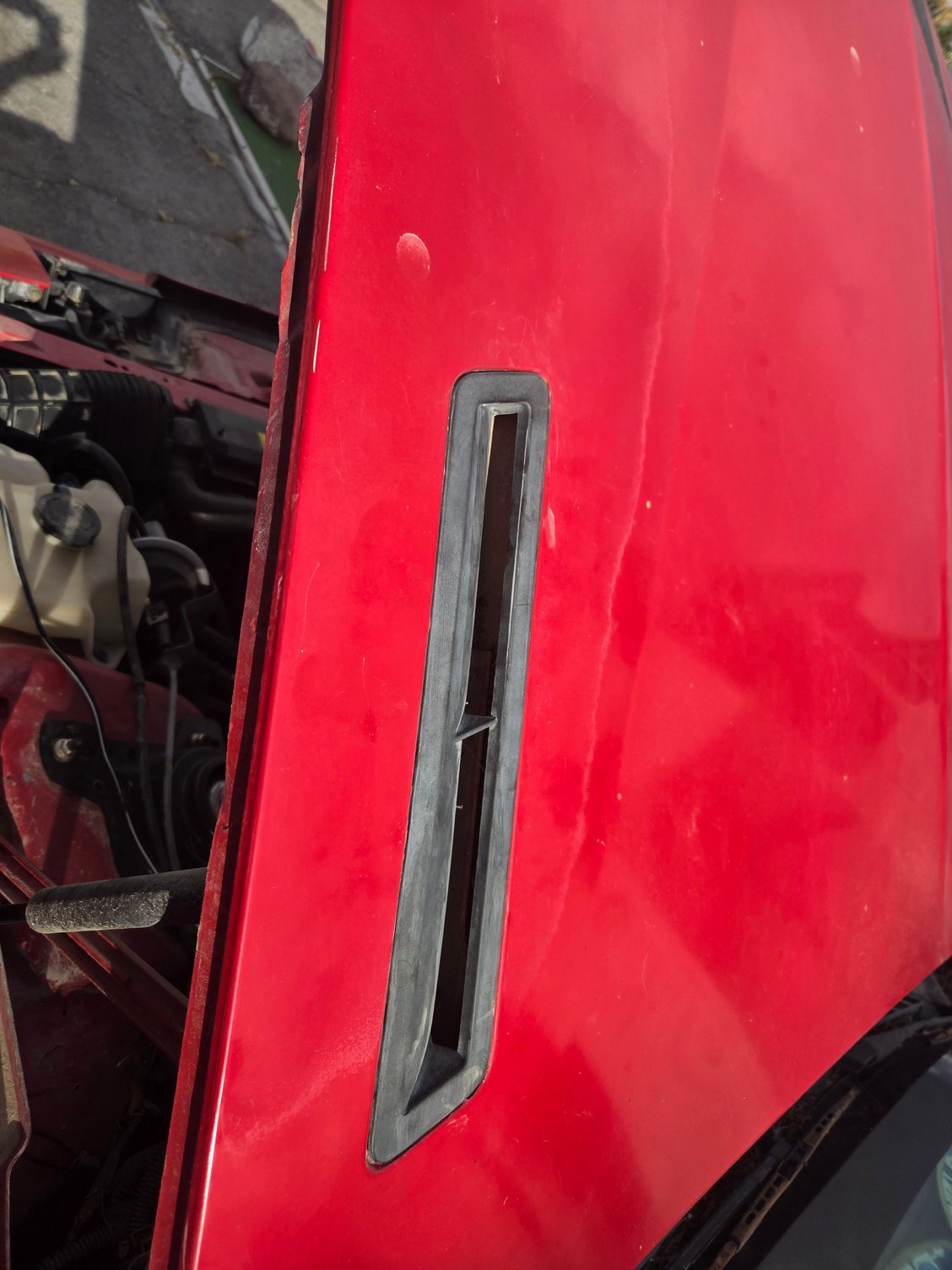

By the way, those hood vents have been installed wrong.
Both sides are formed similarly and they do fit in there like that.
The grille part of them should be facing towards the center of the hood, so you can see them from next to the vehicle, like this.

I was on the fence with changing them but I am replacing the hood.

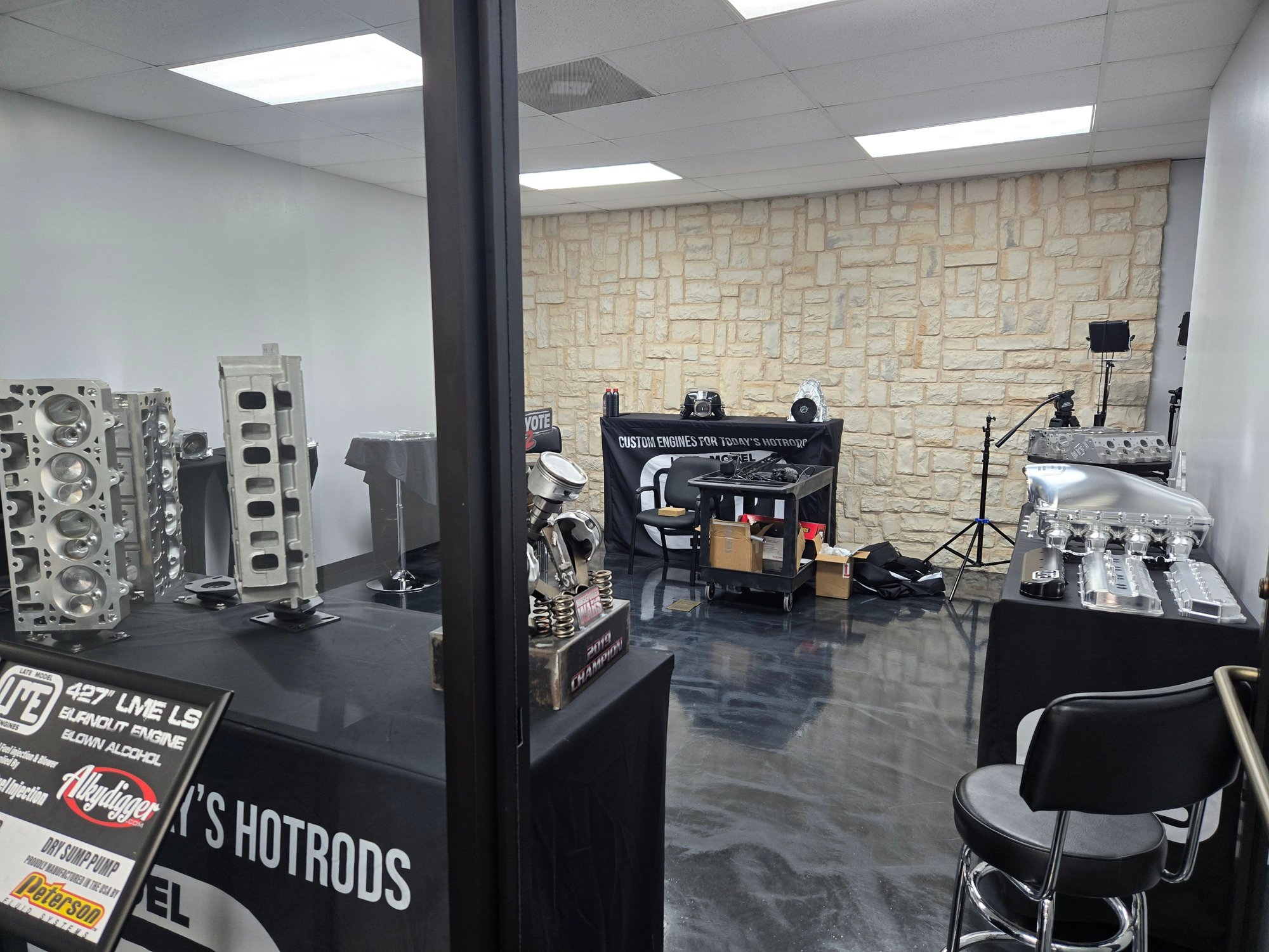

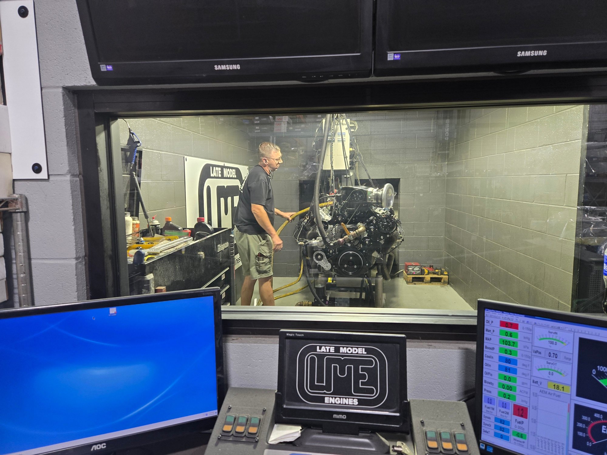

Not working on my TA due to work. However, I did get to visit my lifelong friend at LME in Houston. Watched a customers 400+ LS with a large blower make some rad HP 900+ and TQ 800+
Sweet dyno session
Sweet dyno session
Billet Lt1 lid
Billet Lt1 lid

over 700 HP over 600 TQ
The more i looked at it I kept thinking of your post so I pulled the vents out and put them back in correctly.
