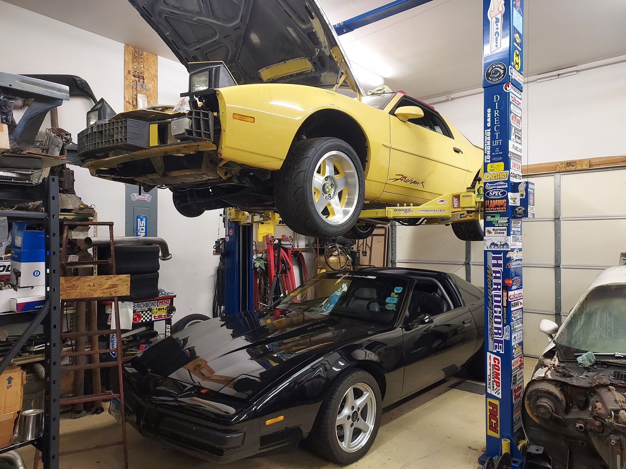

Working on a more factory ride height. With some weight removed it sat a bit high
Old Sep 29, 2024 | 04:15 AM
  #659
LiquidBlue's Avatar
Joined: Jun 2015
Posts: 2,194
Likes: 246
From: Austin, TX
Car: 90 Formula / T-tops
Transmission: MD8
Re: "it" has begun....
how are you removing your coil springs?
Old Sep 29, 2024 | 04:12 PM
  #660
TTOP350's Avatar
Posts: 12,229
Likes: 1,156
From: Il
Engine: 4++,350 & 305 CIs
Like everyone else, with a variety of tools. Spring compressor, rubber hammers, punch, prybars and a pole type screw jack to gently lower and raise the a-arm.

from your photo i was wondering if you kept tires on ground, removed control arm bolts, and then simply raised car into air until coil springs had all the force off them. that would make the job so much easier.

The tools i used. I do them in the air these days and the 3 leg screw jack works well

Adjusting ride height today, springs out and back in in 2.5 hours, taking my time.
settling on 27" 1/4 on front

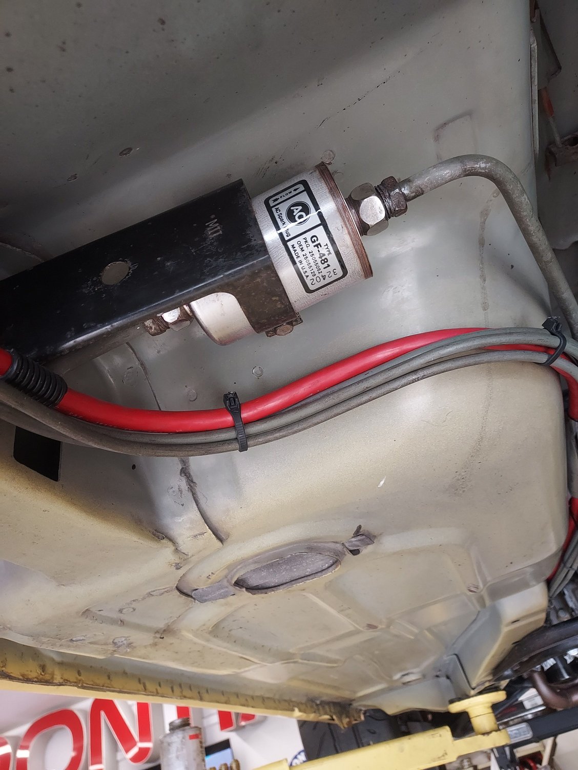

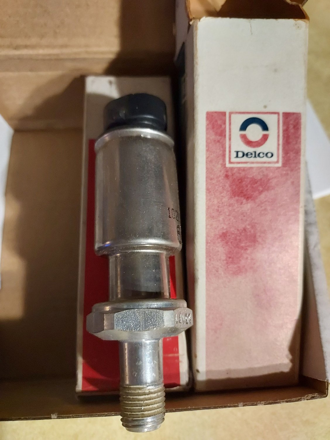

Found a couple nos oil psi sending units with the ink still on the housings.
between that and the nos fuel filters, it'll be a real show stopper now!

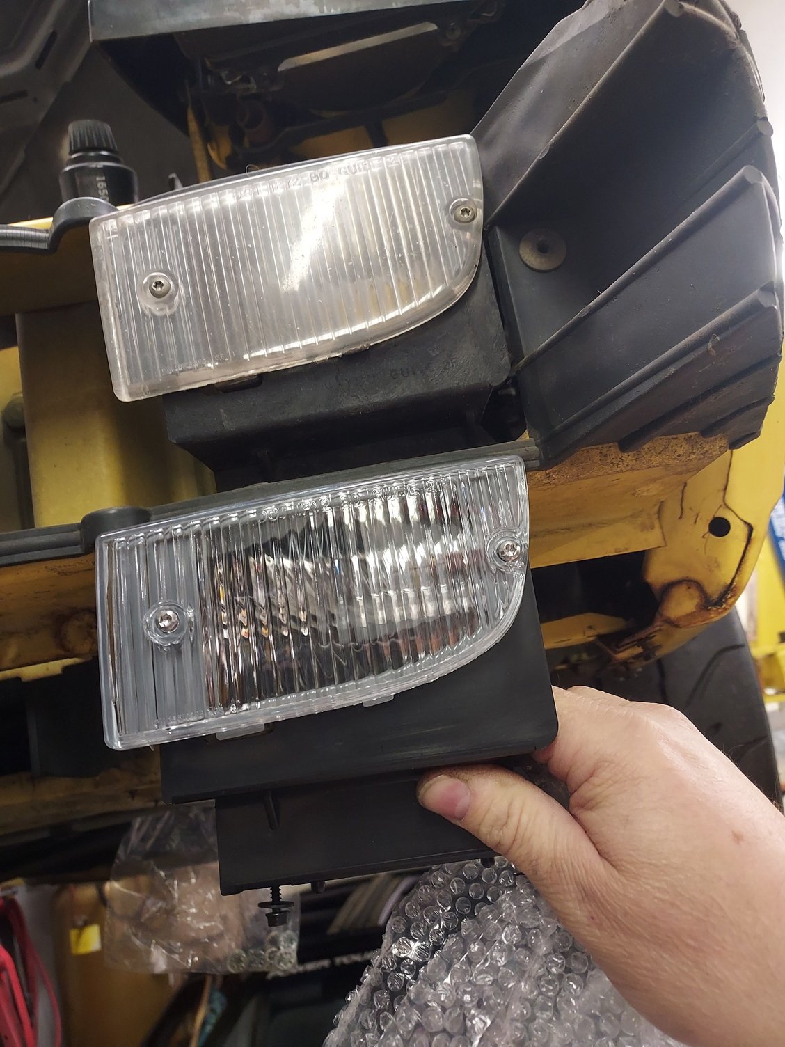

Thought my lenses looked halfway decent until i put Hawks repops next to originals.

Wow those do look nice.

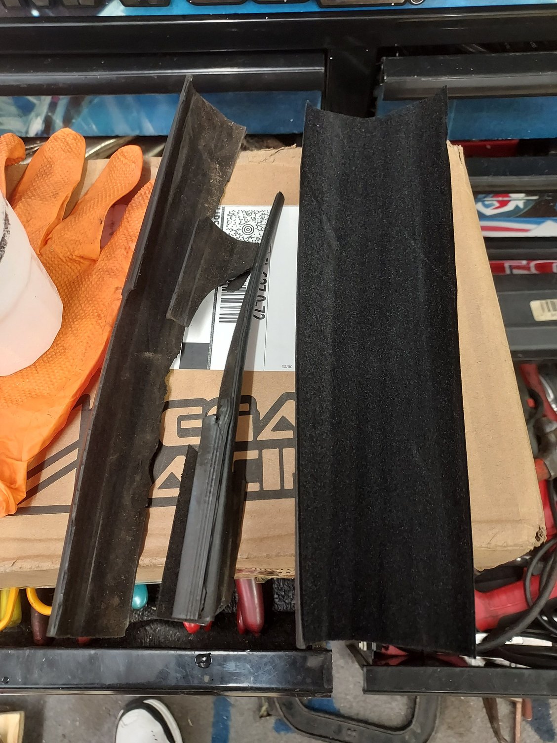

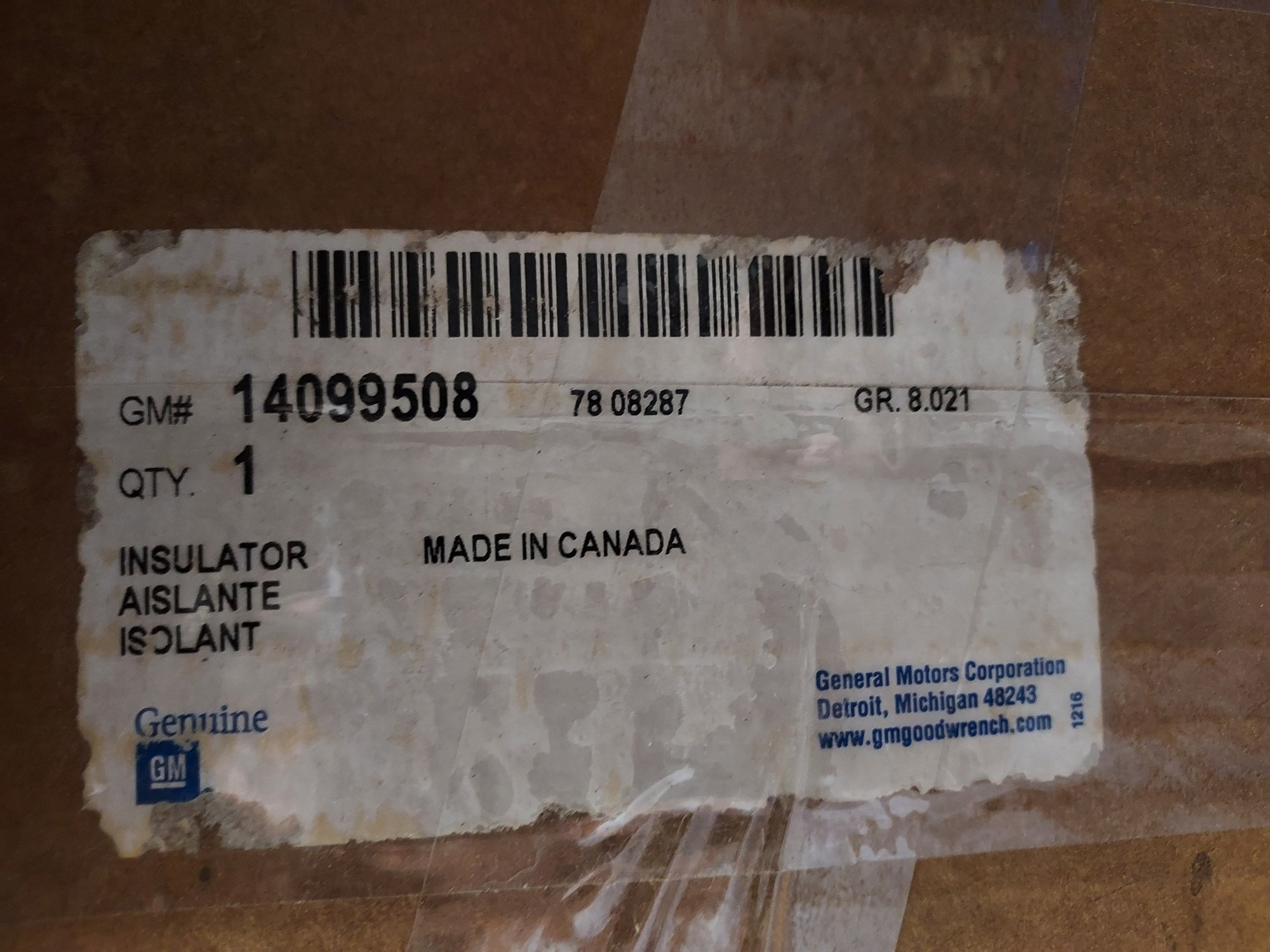

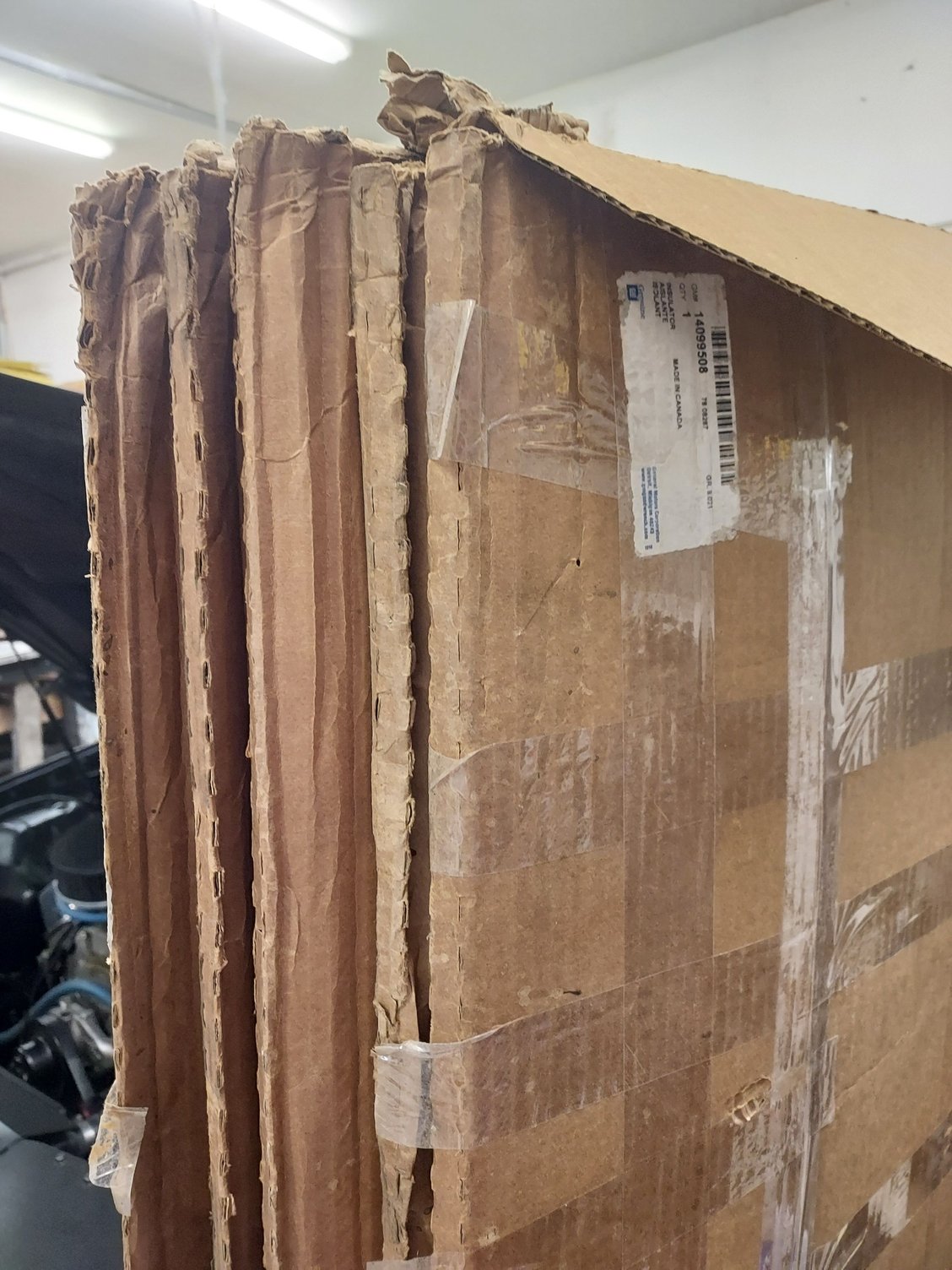

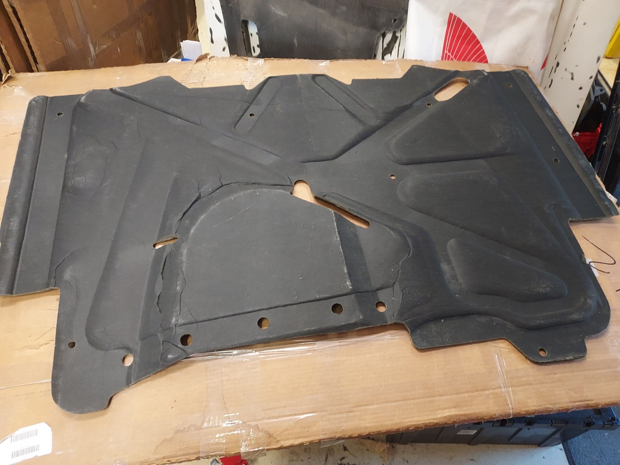

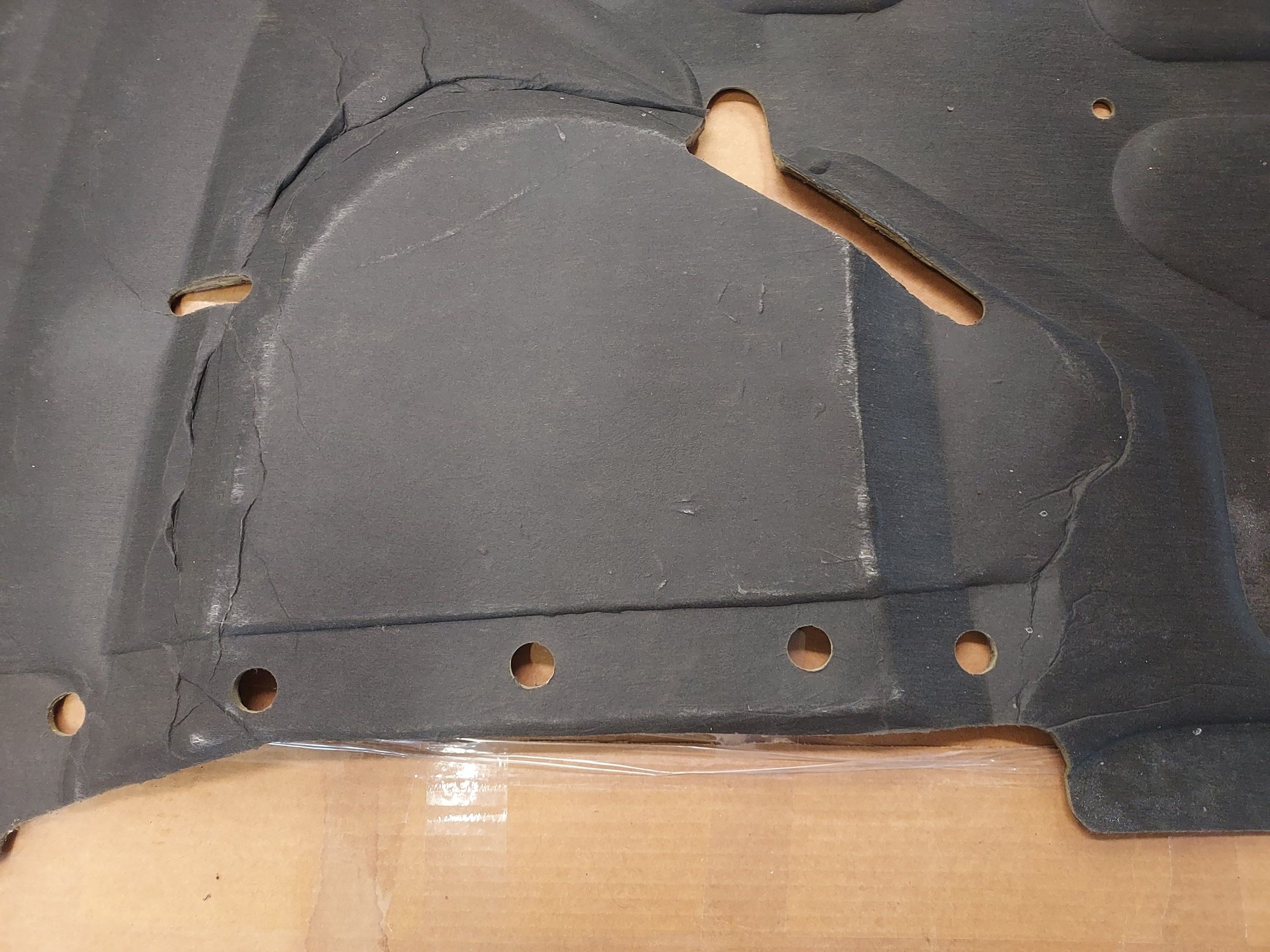

Even though these aren't correct for 92s, i found 5 nos t/a and formula hood insulations.
Due to past storage they aren't perfect and got wrinkled where the hood bulge is molded.
will post a out of box picture later.
i do have 1 other i bought nos years ago and it's in perfect shape.

If you take a DA polisher to your original lenses with some polishing compound I'll bet they'll clean up good as new.

I'll definitely do some polishing on them for curiosity sake but it looks to be on inside as well.

That's a huge insulator pad score!

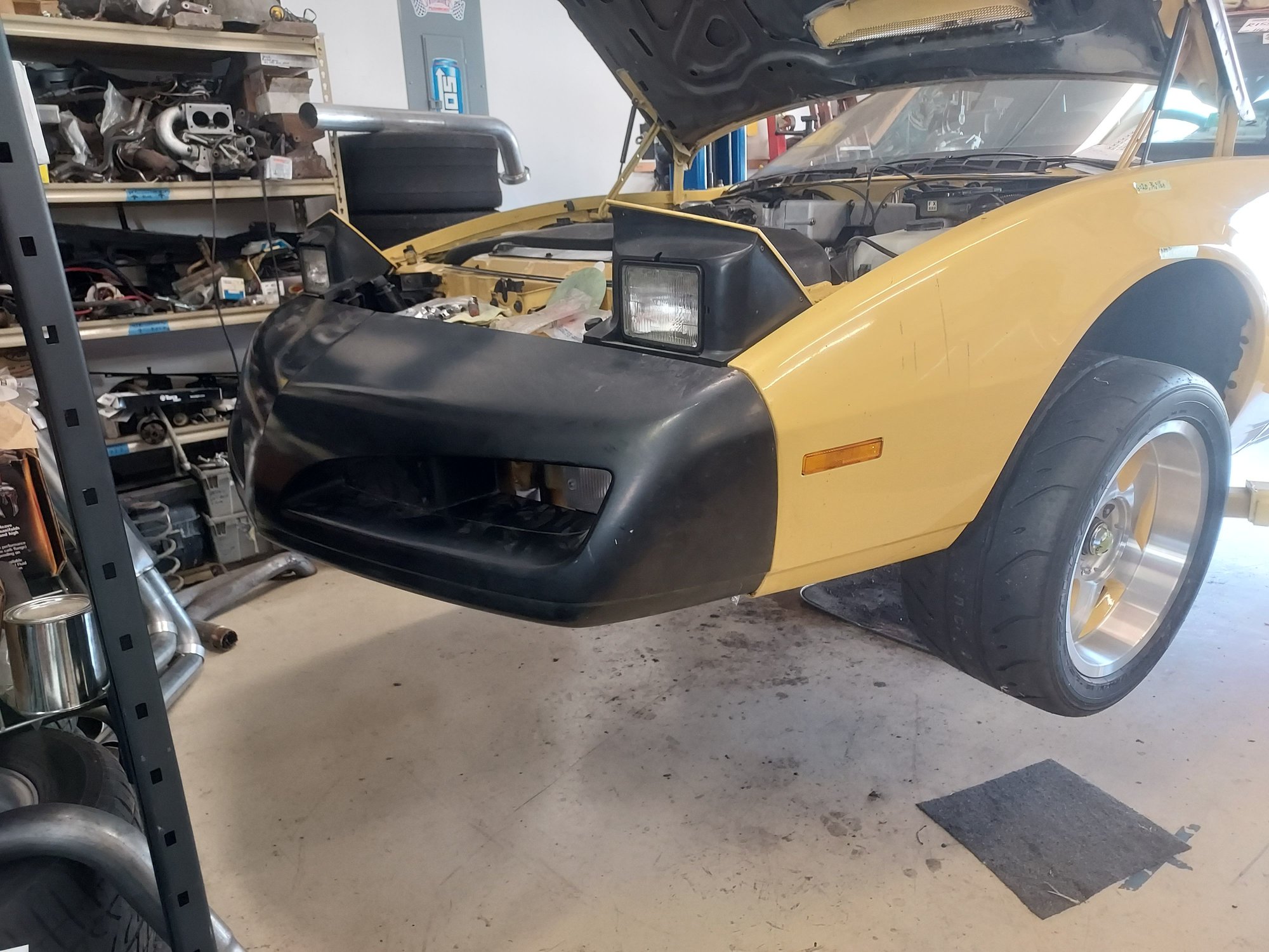

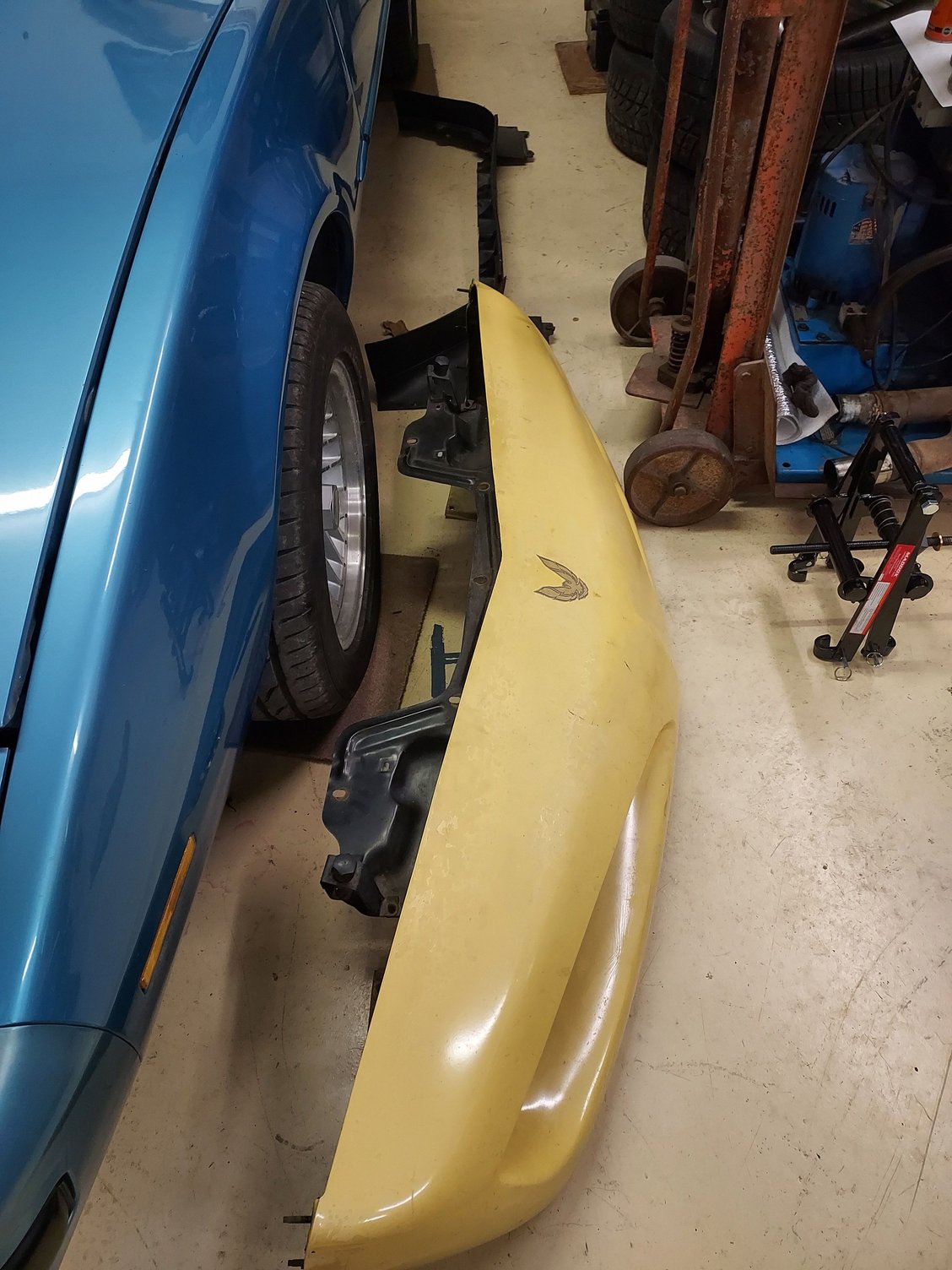

Fitting nos nose
Fitting nos nose
It fits as good as the original  factory parts
Sample of the black and notes on how it was masked off

What was wrong with the front bumper fascia that was on the car?

Hard to see but it had warping and curling going on along the hood area. Plus, im lazy and it's easier to scuff and paint a new cover than to strip the original.

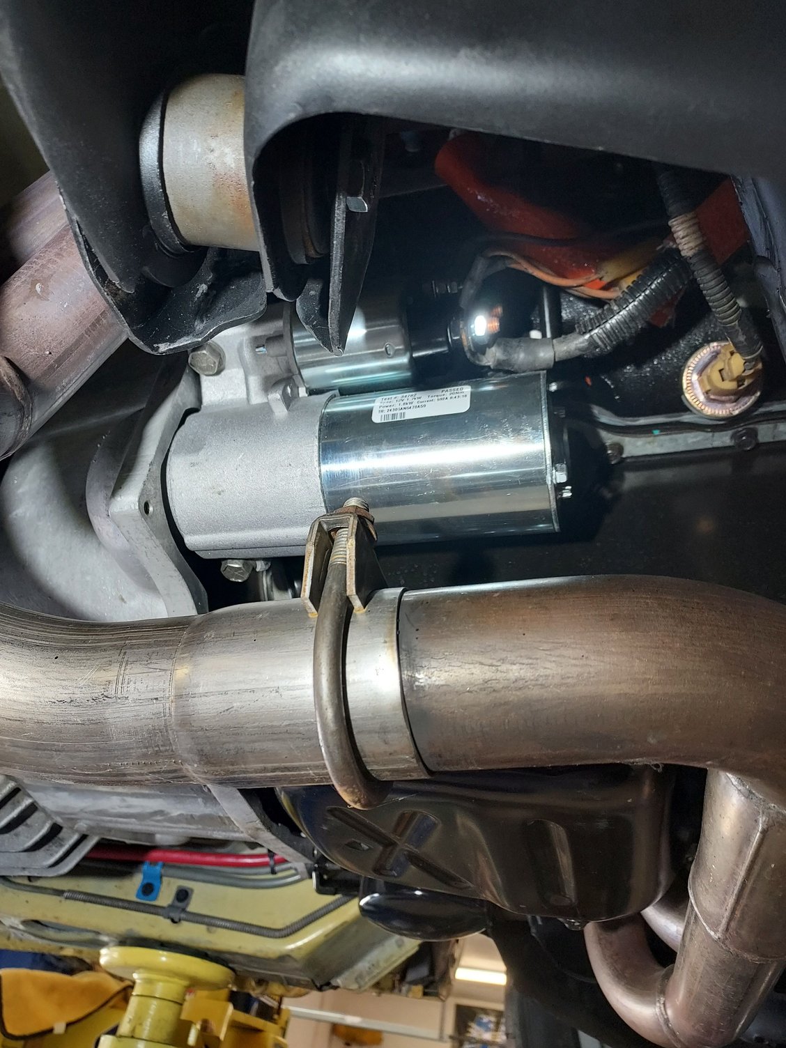

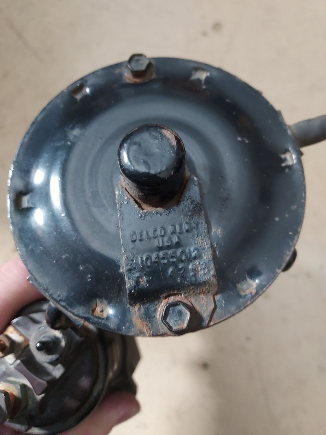

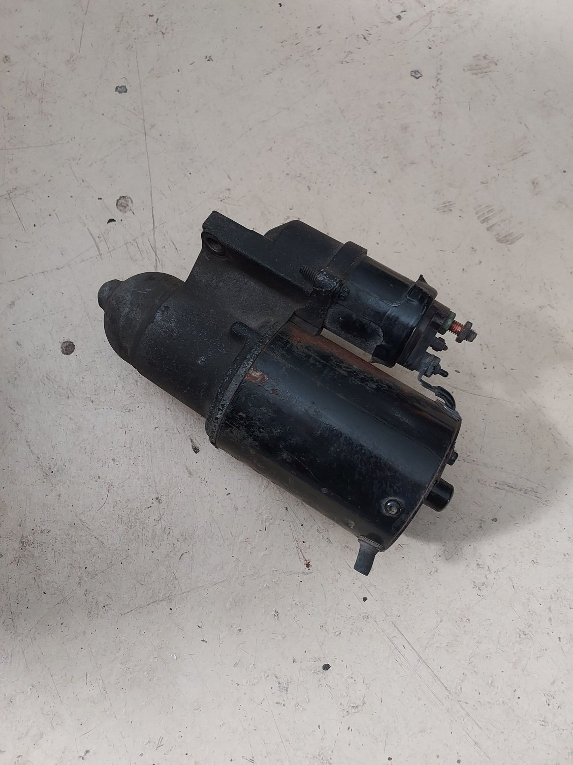

Original 305 starter with nasty dead spot
Original 305 tpi 5spd starter with nasty dead spot
"New" Remey LT1 fbody starter from china. Used a remey reman from mexico on the teal car. Kind of a test to see which one lasts.
The original small 92 5speed starter bolts work. Don't need to use the arp LT1 bolts. Teal 92 350 auto needed the arp bolts. One of the factory bolts has been discontinued by gm.

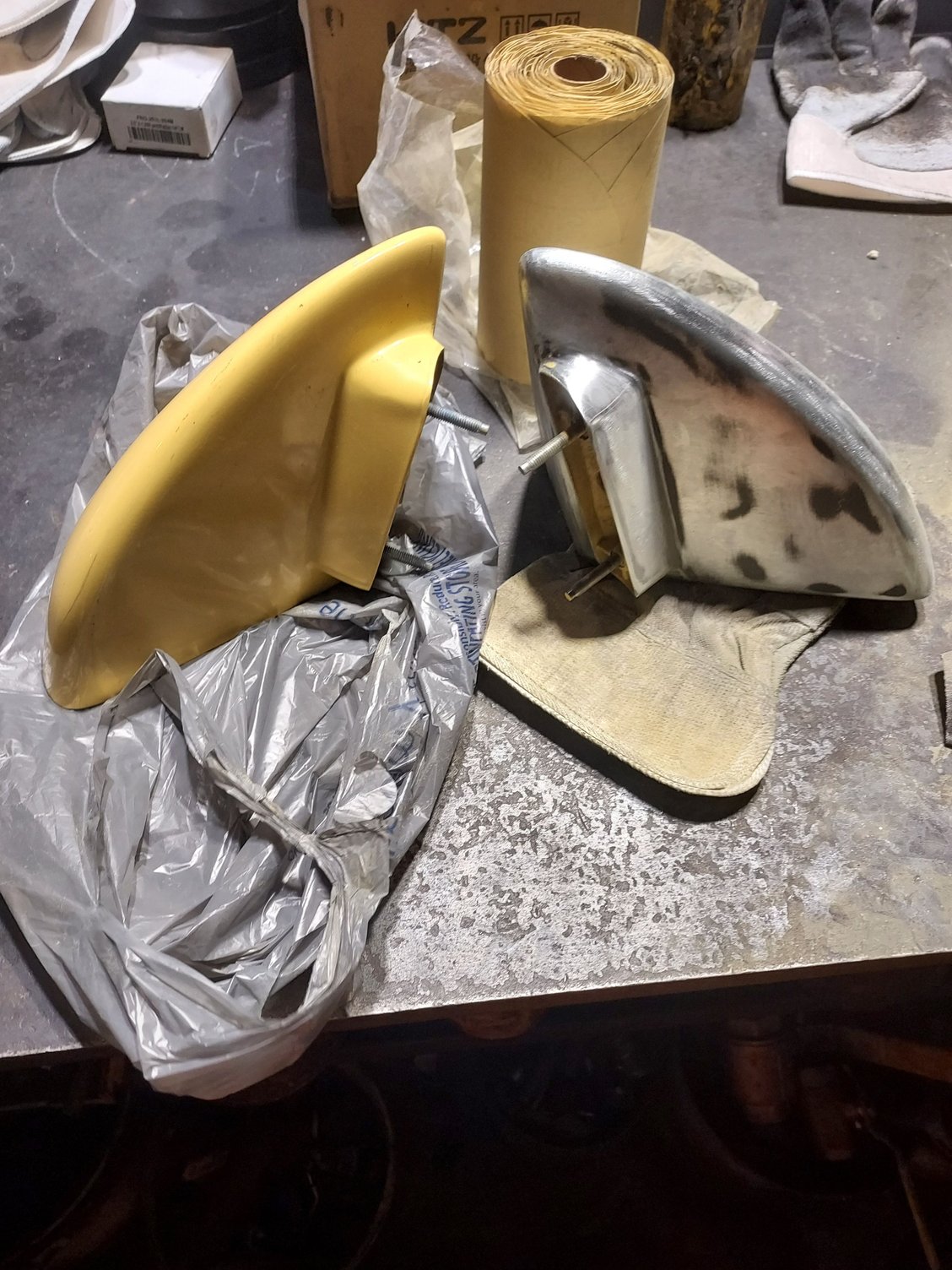

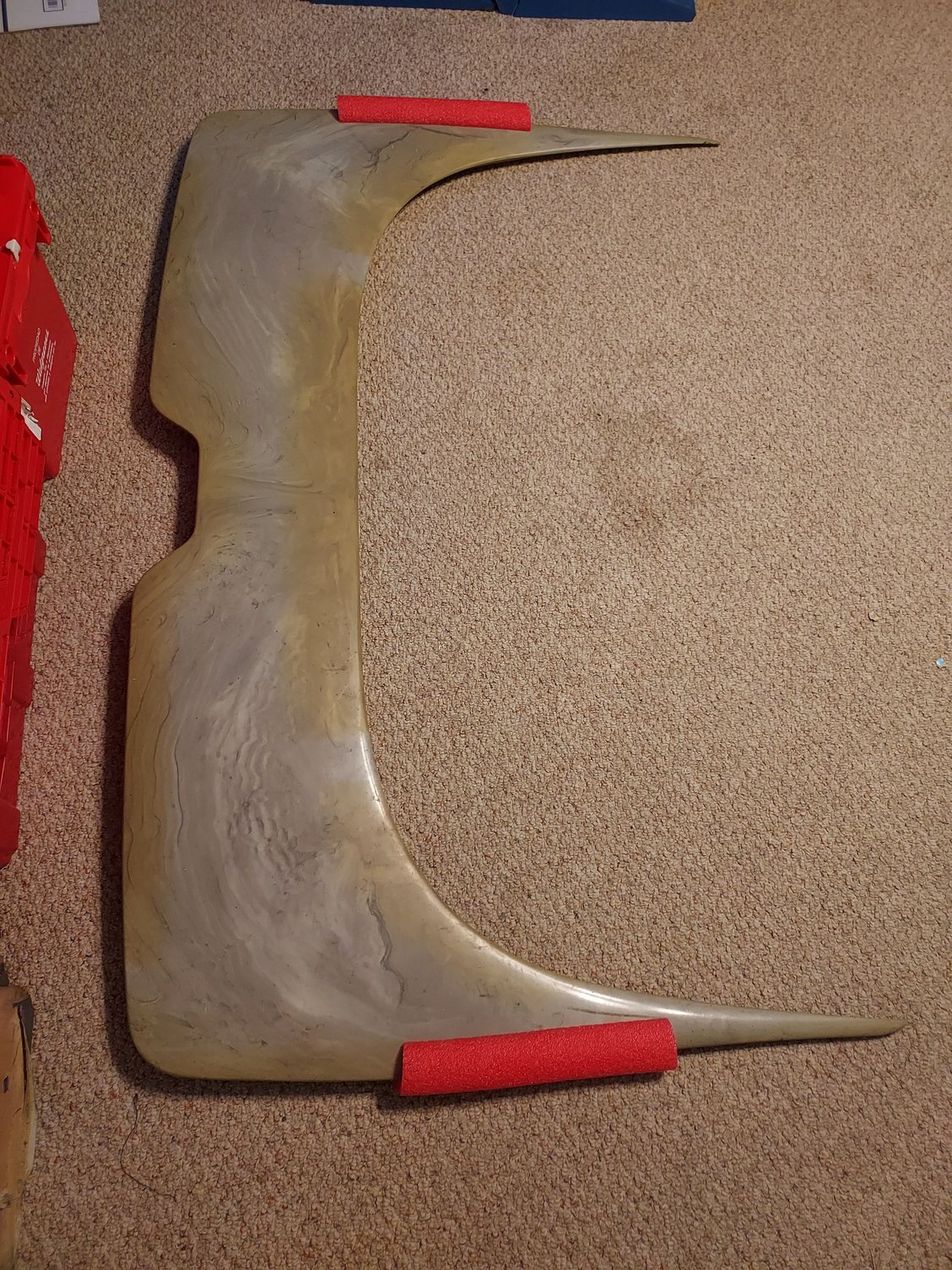

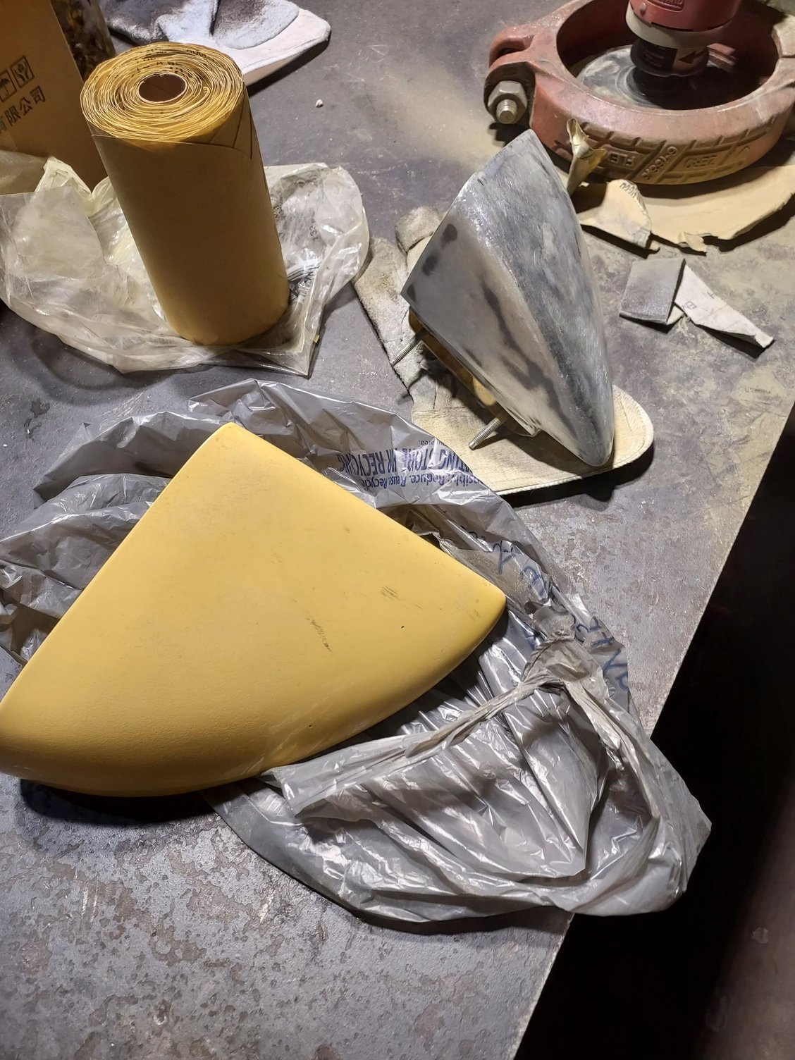

Have been chasing this NOS aero spoiler for several years, finally found its home. It's on standby incase i have an issue with either of my 92s

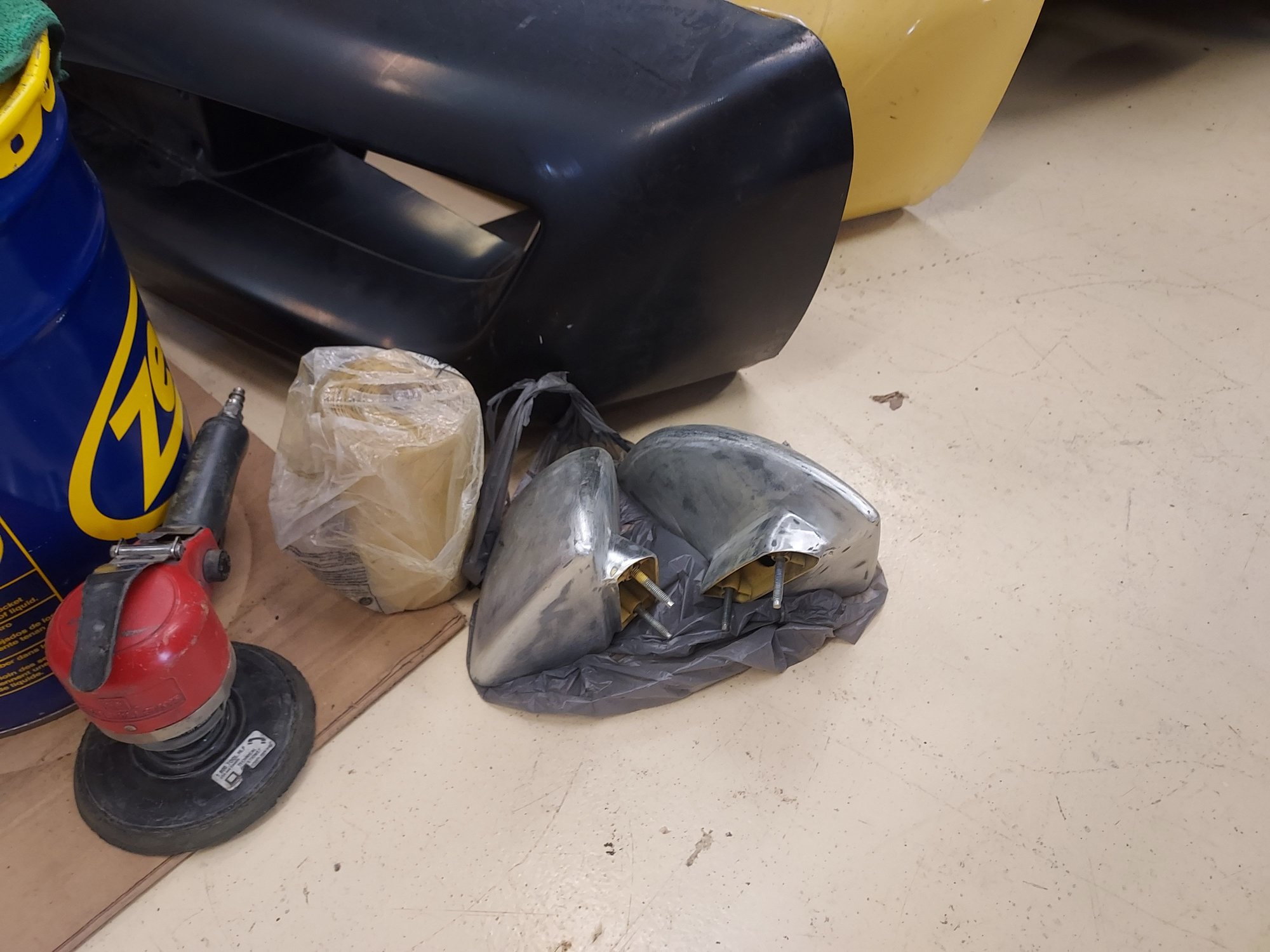

The plan is to do the hood, nose, headlight lids, and maybe the mirrors. Trying to figure out the black paint code used in the nose parklight areas.
brembos are 13x1.? Same rotor ring a F40 uses. I haven't really got on the brakes in this thing yet. It does have some racetrack pads on it soooo it takes a lot of heat to get em grippy

You going to get some pics posted of those NOS hood liners so we can drool and lust over them?
I've had them out a couple times but forgot pictures!

You can see how they got a little flattened in the scoop area. That puts these at driver quality at best. The covering isn't torn or anything, just wrinkled. Not sure how to get it back into shape and hold its form.

Well, seat fabric finally came in, doesn't look or smell freshly dyed at all, just looks like black possibly nos.
also, while doors are apart, i changed the vertical window Channel rubber/felts. Pass side was super brittle and falling apart, which prompted the new parts. Driver side, oddly, still decently soft

We finally got a non-ethonal pump at our local gas station an few months back. Time to drain the 10% corn juice for real fuel
We finally got a non-ethonal pump at our local gas station a few months back. Time to drain the 10% corn juice for real fuel
May as well install an assembly line correct nos fuel filter.
