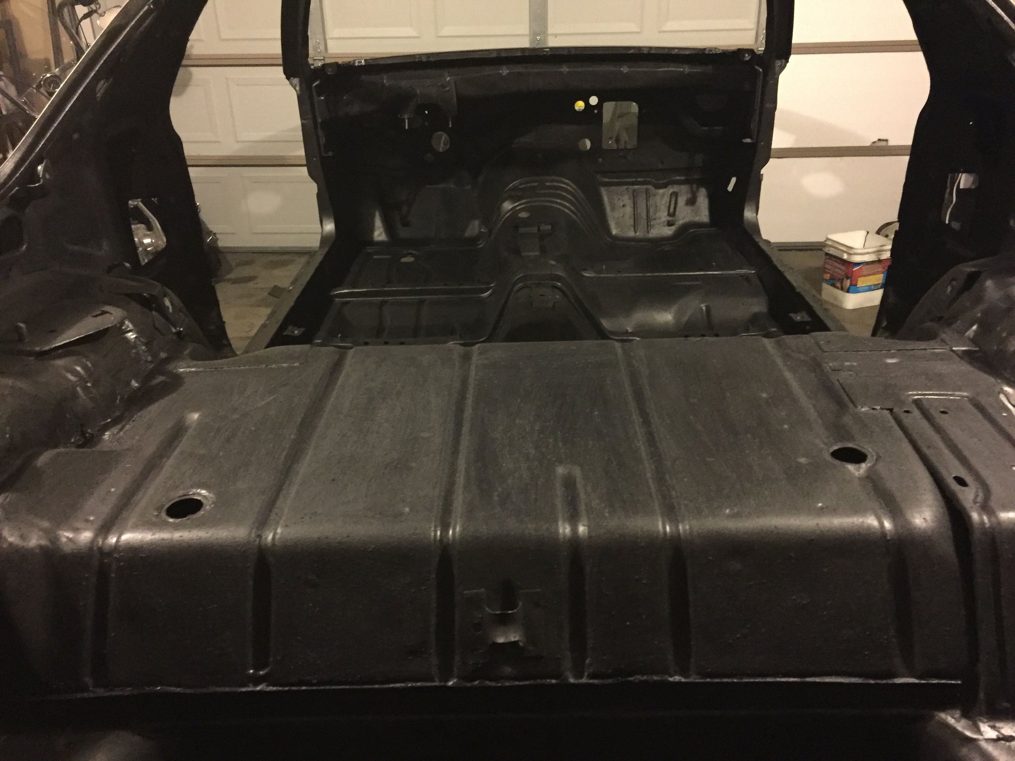

Ive got my 89 iroc z tore down to nothing, refinishing the inside and underneath with dupli color's bed armour (which seems to be very nice), but now that i'm going to start putting it back together ive hit a dead zone on how i'm supposed to convert this car from an automatic to a t-56.
anybody that has any info on this i would greatly appreciate some guidance!!!
Note: I'm converting this car from the 5.7 tuned port/auto to a Ls 5.7/t-56

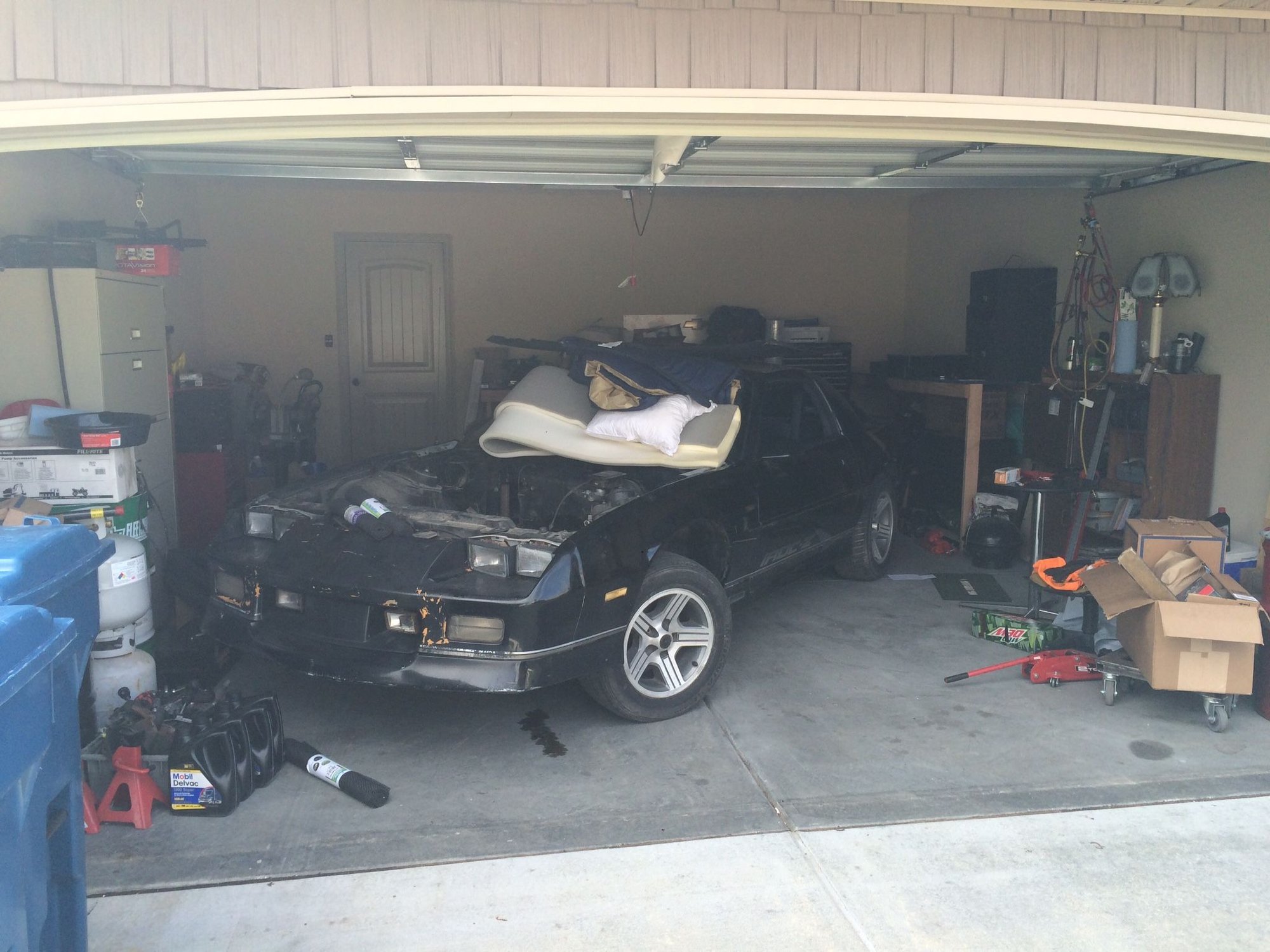

It looks like he bought a 5 speed to rebuild. I'm trying to figure out how to convert mine.

Re: Guidance needed!!!!

I've just about got all the inside and underneath redone.
