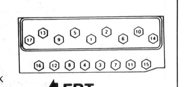

Im pretty much there I started working on it about noon then went to eat at about 4pm then came back and worked for about an hour stoped at 7pm the exhaust manifolds are unbolted I took the A/C stuff on the passenger side off water pump is off the heads just need to be pulled now Im gonna go get a rubber mallet and beat on it and hope it loosen's it up
i had to use a pry bar with mine, i had to pry on the accessory stud to come off...mine were glued to it....
i was hammering away and beatin the **** out of mine just didnt want to budge till i pryed it

story time it was great
i asked terrel if he had all 17 bolts off and he said what i only have 8 or 9 so i said hmm...thats why so i sent him this pic
and he goes oh...damnit i have to take my exhaust manifolds off now... no wonder they wouldnt come off and than he went at 9pm to go finish that was the funniest thing
