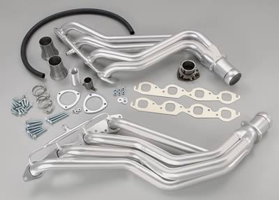

Take the Hedman 69821, long tube and smog queer friendly:

Those are shorty headers del, they're legal. I was talking about long tubes. No one sells long tubes with air provisions for thirdgens.. they do for fourths but not thirds. Even the long tubes with air are NOT legal, because of cat position change.Originally posted by OUTATIME GTA

I agree esp. for thirdgens because all LT's for thirdgens don't have AIR and I believe those are Hooker Super Comps only right?
Yeah I see the diff w/ those long tube Hedmans.
You're right, no AIR. I've got the tubes on my Super Comp shorties.
