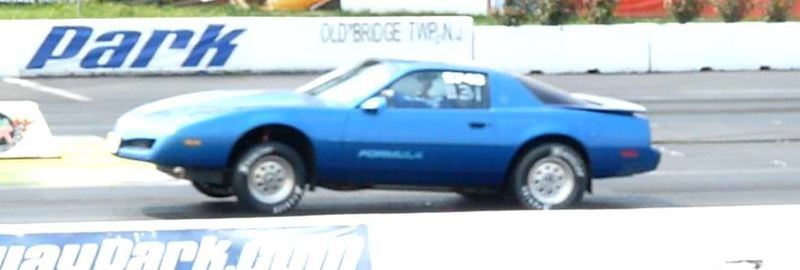

Also posted this on YB and getting a lot of looks but not much info...
Looking for advice as to whether my suspension is leaving some ET on the table or not.
1991 firebird with a 406, 11.8:1 comp with old AFR 210's not-ported, mini-ram and solid roller cam 248/248 625/625 on a 110, TH350 with ATI 8" 4500 stall, Strange 12-bolt rear with 4.56's , 28x10 Hoosiers in rear.
Currently running 17psi in the slicks, -2 angle on the torque arm, lca brackets in the lowest hole and mid setting on the qa1 rear shocks set at mid point. Front struts are 90/10 lake woods. Rear suspension is all spohn chromoly with spherical rod end and a drag bar preloaded. Springs are Eibach Drag Launch springs
Car weighs 3565 with driver and gas. Last week it went a best of 11.15 @ 121.4 with a 1.55 60' time.
Doesn't feel like it's spinning but looking for advice on how to lower the 60' time a little.
Launching by foot braking the car. I bring the idle up a little so it not choppy (2000 ish) and then stab it the last yellow.
Thanks for any/all responses.
Picture of launch
Video of launch

Looks like it is leaving well . especially for foot breaking. Have you tried letting a little more air out of the back slicks or playing with the settings on the rear shock ?
Whatever changes you make, do it one at a time and back up the pass.

Yep, that's a nice looking launch.....
My setup is similar to yours. I built some travel limiters on my car to keep the front end down, and that helped lower my 60ft times and kept them more consistent. However my car is lighter @ 3200lb race weight.

I dont think you will get much improvement in the suspension at this point. Focus on taking away antisquat if you can maintain traction. Other than that, you are still leaving pretty easy. Need to leave with more rpm and stuff to start taxing the suspension.

If you're not spinning, it doesn't look like you have excessive antisquat and the front isn't lifting too much (you're not wasting a lot of power getting the suspension to work)I don't think that there is much that you're going to do to the suspension/tires to run a faster 60'.
I'd be focusing on tuning and trying to make more power (maybe mess with timing in that range...) till you start having traction problems or too much suspension reaction and then start messing with the suspension again.

Just the one pic ya have..its hard to tell. But you do have better weight transfer then a lot of guys on here with rattle trap race cars...(all cut up)...when you hit it off the line and hook.ya want the car to push forward..not skip...and part of the push..wheels will lift..footbraking is a blast.with a good convertr.
Watching the video.
I would not go under 15psi in the slicks...(18 to 20psi)
can you get the rpm/converter up in the 3000 rpm ballpark and then flash it.
