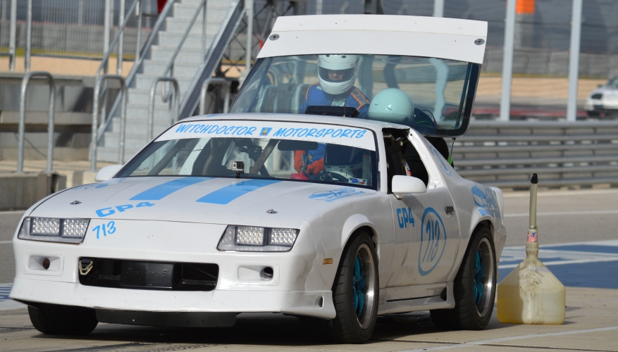

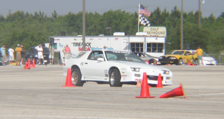

There was no such thing as the "1LE" tank. It was in the marketing stuff but never got produced. There was no 'special baffles' or 'swinging pickup' or anything. I've owned several 1LEs and when replacing the fuel pumps they were the same as any other random 3rd gen. On street tires driven hard they will fuel starve at half tank and on race tires they'll starve earlier.
That being said, I've also autocrossed a good bit (won a few national tours, etc) and have always been fastest with a full tank of gas. My car has stock rear panhard/TA and good dampers, so if you've got to a lower PHB or something it may perform better with less fuel.
A 4th gen team I sometimes drive for in WRL Endurance racing has taken a stock plastic tank and added a hydramat to the bottom and have been successful in racing (on 200TW tires) and running the fuel down to less than a gallon which is incredible. They have lowered PHB, good dampers, etc.
