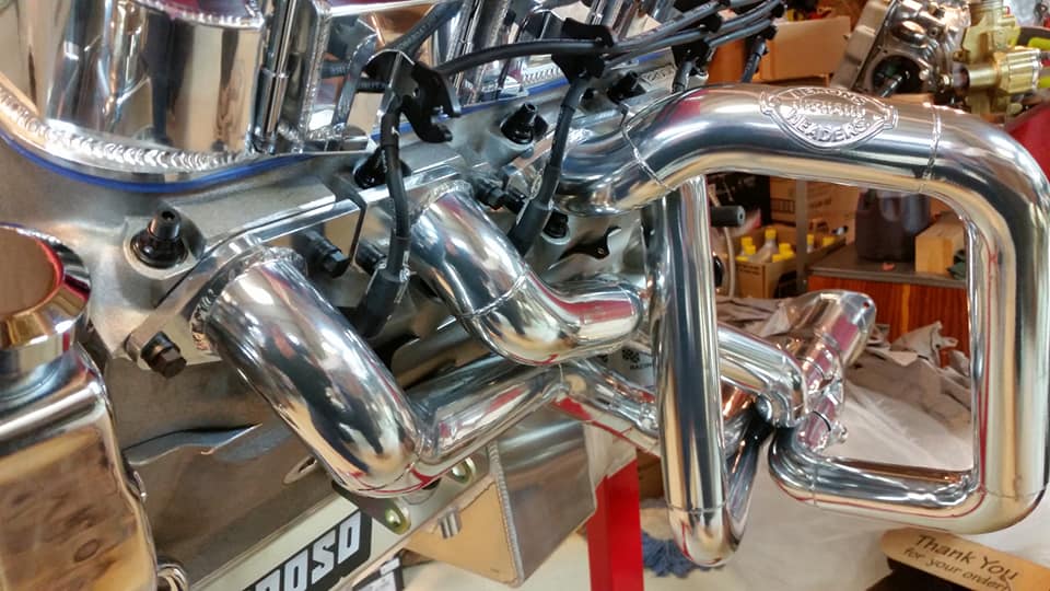

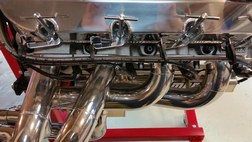

Dan did my SBC stepped headers with the Brodix 18 degree head pattern, coated inside and out. about that price.
6 years later they still look great and get the job done !

still thinking on how I want the exhaust to exit the car..in front of rear wheels with modified nascar boomtubes (1 ea side). or?up over the rear. and into turn downs on ea side.ya cant see..(I don't like the look of pipes sticking out from the rear)

The further back you run the pipes the quieter the cabin will be, if that is a concern at this stage for you.
My headers just dump under the car, for a track car I saved over 100# by not having an exhaust system!
To knock the dBs down a bit I installed car chemistry 4" collector inserts.
For a car I seldom drive on the street this works for me.
Loud pipes save lives, JAJAJAJ LOL !!!

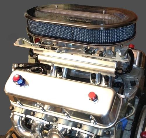

my intake set up
fitech $1900
intake itself with mods $900
linkage $50
2. 1" spacers $30
2 nos plates $200
polishing $450(bling bling)got to have the bling bling
this is a tad bit more the a single 1150 carb and a single plane intake (what shafirof uses)
fitech $1900
linkage $50
2. 1" spacers $30
2 nos plates $200

on a side note..my intake set up..came out to the same lay out as holleys did..right down to my rod linkage fit..and carb spacing to runner.. the thing they did. that I did not do. was tig the 1" spacer plates to the intake top.... I left my intake top flat.. I also left my inside intake base flat. sort of like the accel super ram. and like the tunnel rams..I hope I have enough plenum Volum.. I think I do..dyno will tell...lol

update..so the eng came in with the HP I wanted 892Hp on pump gas.. and 912Hp with a hot mix 108oct unleaded ..this is without spray..so I know we can get it to 1100hp with a small 250hp hit..and im sure the car will be under 3300lbs with me in it... land rocket!
adding NOS blow out plugs/plates to save the intake and parts (trying anyway)
a lot of parts still coming in.. a Radiator.. a 2nd one. as I wanted AN fittings (no hose clamps) so I had one made & polished with 20AN fittings
orderd 3 other thermostat housings to see what one would fit.. metzer..moroso..brand 3 brand 4...and in the end I might make one.as I think the 20AN 90deg fitting sits to tall..I also orderd a 20AN 120deg fitting to just tilt the hose down a bit..
so now I also have a 2nd Radiator im not going to need...
I was going to just tig 20 AN fitting to the unit I orderd..but I found out they would make me a Radiator with the 20AN fittings installed (O ring) so hell yes.. and have it polished also..also having a polycarbonate air cleaner made with a 3" tall air cleaner..to fit under the hood..as the billet aluminum unit you see up top..is a bit small..
as its over 12" wide and 21" long and im having it made so its more forward..so the back of the hood clears..with out trimming (I hope)
done in clear or black..Im thinking of shooting it in body color..

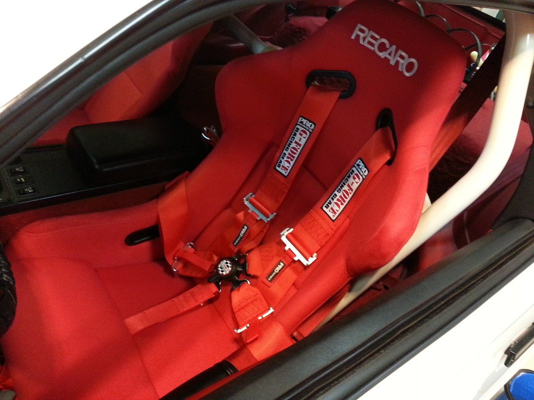

reshooting eng bay before install. have everything I need now. but the drive line & headers.. getting/ordering that when eng and tranny is in..adding a few more bars inside the car to make the track happy.. Dan Lemmon's headers have not come in yet..still need to cut holes in inner fender...got the templets for the cuts..want the headers in hand before I make any cuts. thinking of ordering a plastic eng block for mock up... so no not together yet...but the plan is by spring..2019..
did order a set of the Kirkey seats covers & rails...just in case I like the fit better the the recaro profi's I have now..but I orderd to wide at 20"..lol will send them back and get the 16's..as the 20's look to wide to fit...don't know what I was thinking..just wanted to use up the credit before they sent me a check...lol..
16" wide Profi Recaros..just fit the way I wanted..
so shooting for spring and looking to get it into the 10s...
also have info on a place making billet hood hinges...sent them a mesg..to make sure they are in fact making them..they have a price listed..but ya never know..

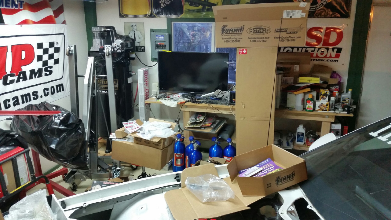

wanted to be able to do oil filters and starters without dropping the headers..this was part of the plane..so I think the cutouts are part of the plane..this is a $2150 SHOT in the dark on fitment with the UMI K member..fingers crossed..( I was tired of looking for parts) and making deals..lmao..going on the ...IT LOOKS RIGHT... it should fit. thing...
ITS COLD out side my shop is cold... parts are stacked deep..not joking.. sold off a lot of the small block stuff.. shipped out a lot of parts Monday..
on a side NOTE: have been off work for the last 4 months..as I was Injured at work.. there falt not mine..and needed Surgery to fix..what they did to me..paychecks are still coming in. and will be.. till Im fixed/better Pre DR orders..so nothing to do but shop for parts (don't need any) and chrome plate parts. still doing...
a company out of CA sent be the brake booster parts (taken apart)Free.. so I could have them chrome plated.. and master polished. dropping them off this week with the Heater box and a few other parts to be chromed..(over the top) with the chroming..I know..but what the hell..bored!
I then send the parts back to the guys in CA and they will build me a new GM booster/master cylinder for my Camaro..
my shop is a Mess Parts every place..looks like summit blew up...picked up some more shelves to Organize parts..

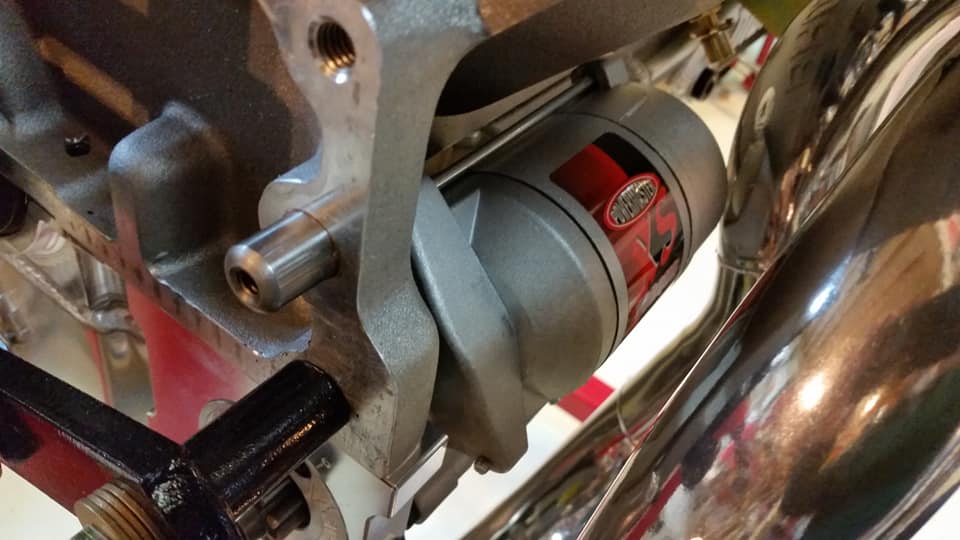

so the headers will be in today. Started mocking up a few things .found none of my starters will fit..oops.. GMPP small starter..nope..MSD nope..this came after I was installing the Moroso eng mounts. and could not get the lower mount bolt in on the pass side..the oil pan has a roll to the outside..making it tight for a standard type 3/8x16 x 3/4 bolt to work..had to use a header bolt. (smaller shoulder) to fit past the pan edge.. so after I got past that I was like..lets toss a starter on the pan..have some brand new stuff. to try out...NOPE!..lol.
the pan is notched for a starter..just a short stubby one.. going to call Moroso and see what they..(whos starter) to buy.
see the small notch for this pan. starter location..
its about 2" to short for the body of any of the reg mini starters...

Re: headers $2000 GOING Big Block!
talked to moroso.. they told me the powermaster 9500 starter was the ticket..there are a few places making this type of starter..but looking at the 9500 and the way ya can clock it..and knowing the nexed thing could be the headers..im going to order it today.
https://www.summitracing.com/parts/p...a/instructions
on a side note: this was my falt.. for not looking closer at my set or parts from the start..I did not think ahead about the starter fitting the Pan..Untill I was fitting the Moroso solid Motor Mounts..and found I had to use a header bolt on the lower bolt hole of the mount..this is from most of the time this pan is used..Im thinking motor plates are used..In place of motor mounts.. this pan was picked out for use. as it was lighter then a steel pan.and this Build is to drop as much weight of the front of the car with bolt on parts on the market.

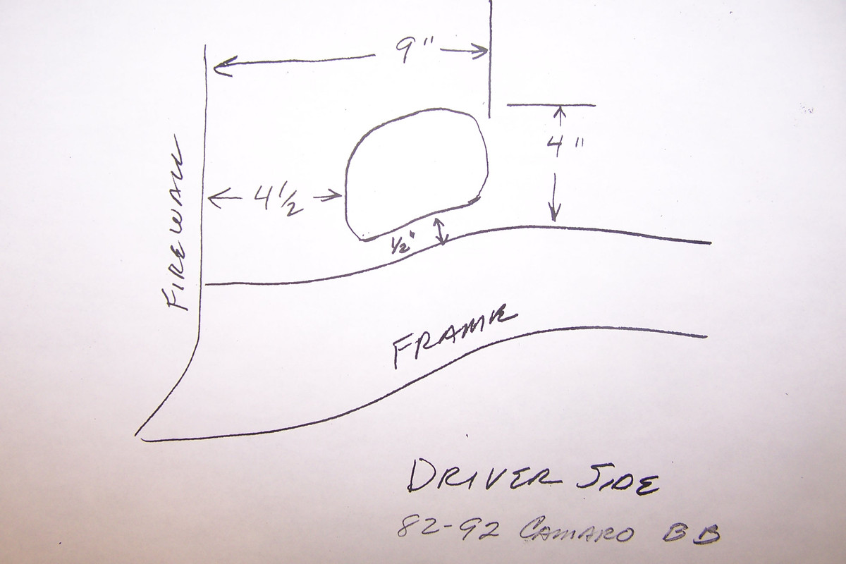

Joined: Sep 2009
Posts: 3,776
Likes: 101
From: Spokane WA
Engine: Aluminum 615BBC
Axle/Gears: 4.11/4.30/4.56
have to cut holes in the inner fender..just starting to remove wiring. pulled the AC delete box (getting chrome plated ) dropped it off to day with brake booster and some other small parts.
as soon as the starter and header bolts show up.. Ill start the mock up on the eng stand.. with K member.. Dans info with the headers names Sphon/BMR/Ajay and 1 more as K members. his headers are made to fit..so Im thinking they will fit the UMI K Member..
remember if its not Fast..you chrome it... I Like to say.. Chrome it.. even if its fast.
lots of room for the plug wires..plugs.
starter fits nice in the pocket (oil pan) but if I had to swap it out I would have to drop the 2 tubes next to it.. no Biggy. it clears the block and headers..and could be clocked 360deg. just needed to be moved/clocked up 1/8th inch.. nice fit! ea tube is free..so its easy to install with eng in the car...

it was fun putting the puzzle together..as ea tube is free..not looking forward to cutting the holes..(shes my baby) but there comes a time..to keep things easy..to work on..and I hated doing plugs on the SBC..from what I can tell it should be Cake with the BBC..
Joined: Sep 2009
Posts: 3,776
Likes: 101
From: Spokane WA
Ahhh. The jigsaw puzzle headers with slip on collectors. I know them well.
The only easy way to get big tube headers on a BBC in a third gen that's not a tube chassis car.
I have to remove the front 2 tubes on the LH side and loosen the other 2 tubes to get my starter out. One tube is dimpled for clearance for one of the starter bolts and the bolt won't come .
The only easy way to get big tube headers on a BBC in a third gen that's not a tube chassis car.I have to remove the front 2 tubes on the LH side and loosen the other 2 tubes to get my starter out. One tube is dimpled for clearance for one of the starter bolts and the bolt won't come .

I don't like those infinite clocking starters. Figure out where the starter position needs to be and red loctite the retaining screw. I had one loosen off and the starter turned until the power post started arcing on a header tube.
I now run a basic GM OEM mini starter and it works just fine.
I've seen headers like that before that go over the frame rail then back under the car. I want all 4 tubes over the frame rail and exit out the side of the fender but making a set like that all equal length is a lot of work. For a blower/turbo car, not so bad.
If I had to do it all again, I wouldn't even start with a production car. Spend the bucks and go right to a tube chassis. Much easier and cheaper in the long run.
