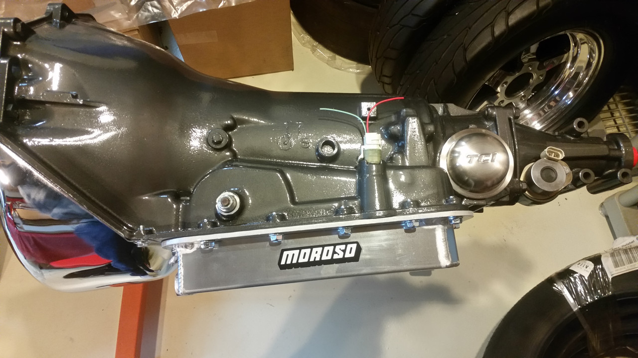

doing a FTI 5 TH400... with all the fun stuff.. and a nice street billet converter 4800 to 5000 stall.. should be to my door 3/4/19.
the stall was picked out by the builders.. after looking at the dyno sheet./ car / info.
https://ftiperformance.com/TH400-Rac...m?productId=24
added a few things like a Clean Neutral for the reverse pattern shift..= P/R/N/1/2/3/N
I added a moroso pan to match the eng pan..w/roller tail shaft and some billet parts.
I will add a super bell and do a finish to the unit to fit the car at this end.. (got to look good)

will rework the outer case..and do my finish on it..I just like the look of a smooth case..(debur / hand finish)
shot of 2 of my 700R4's. I sold off..
What color is that painted?

Hammer tone Black..but looks more like a gun metal Gray...ya have to remove a lot of the rough finnish from the case..take off all the sharp edges..but it lays down a nice gloss finish...the pic show 2 diff 700R4s...
both did not take that long to prep.about 2hrs ea...and no primer. as it has a built in primer..
the TH400 will not take that long to prep..but is getting the same finnish..
