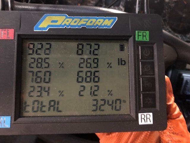

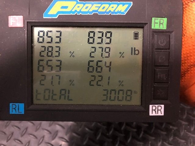

My goal this off season was to remove at least 200# from the car.
I scaled the car today after finishing the last upgrade and the I removed total of 204#
The car alone now weighs 3,008# (previous weight 3,212 #) with me and safety gear we have 3,240 #
