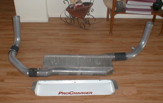

I hope you don't mind me asking all these questions. I need to rule out any obvious possibilities first. The one difference I see between your setup and mine is the H2O nozzle size. I'm using a 14-gph nozzle. I'm sure if you went to a similar sized nozzle, some of the knock you're getting will be eliminated. But like you said, air inlet temps of 180 degrees + really hurts. With my "old" intercooler setup (more later), I used to see air temps about 110 at the start of a run and peak out at about 130 (without H2O). With the intercooler and H2O, I NEVER saw air temps over 100 degrees on 90 degree days!! And that's 14-psig boost too!!
So I believe an intercooler setup will work wonders for you. BTW, I have a third gen three-core IC setup for sale. It includes all the piping (as seen under the car) including the two pieces that run up the inner fenders to the engine compartment and all hoses with clamps. I'll throw in a $175 ATI air scoop for the IC too. If you're interested, please e-mail me. I have attached a pic of the entire setup.
