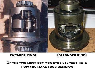

dude that so sucks, especially since malibus are 26 spline like 87 and older third gens not 28 spline like the S-10's, 88 up thirdgens, and the ones SLP is selling. but I see them on ebay all the time. make sure you look for this when purchasing: LINK

For dirt cheap super-easy posi action jsut dig a spare rear out of a junkyard GBody and weld the spider gears. $50 plus your time and labor. Don't drive it on the street much like that, though.
