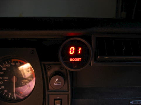

I use the Nordskog digital boost guage. You must drill and tap the plenum for the sender, but it can be placed on the bottom out of sight. This guage had an automatic recall feature that will tell you the highest and lowest boost reading from a run. They are available in red or green display. Mine looks like this:
