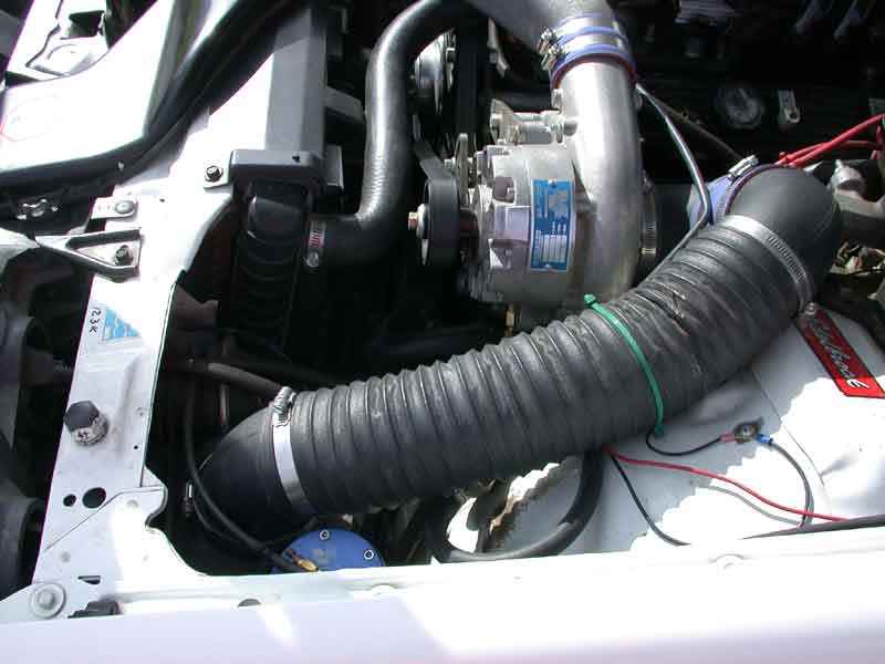

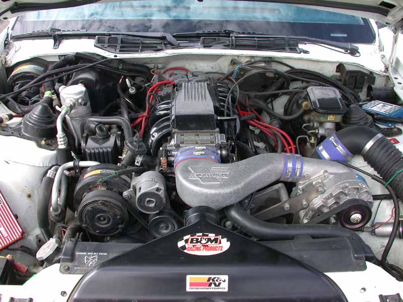

Hi there all. I came up with an idea for a different kind of air intake for my Z28 with a blower. I was hoping some of you might have some opinions on my idea, or maybe some other ideas. Enclosed is a picture of what I'm dealing with.
What I was thinking was making a plastic box around my current air filter as seen. Then removing my drivers side high beam, and installing a hose in the factory 2 1/2" circle behind the light, then running that tube into the plastic box containing my air filter.
I have a serious airflow problem, and have no room, nor other ideas. Any information or comments from anyone would be appreciated.

I would just leave the filter right where its at. The blowers gonna suck in all the air it wants. All you could do by extending the intake is add a restriction. The airs gonna get so hot in the blow it wont matter if you get cooler air.

Yes I realize the blower is going to suck the air it needs, however all it's sucking at the moment is hot motor air. I'm not talking about adding three feet of tube, maybe 3-4" in order to get cold fresh outside air coming in.

1st: how do you know its sucking hot air? how have you quantified this?
2nd: Does it go through that "battery pan"? is the filter just sitting there in the engine compartment or does it go undernieth? Even if it doesnt its likely not sucking hot air.
3rd: What trim head unit is that?
PS: please if you answer 1 then answer all or answer none at all

Even though the blower is heating up the air much hotter than the engine bay air, it's a matter of adding heat to it. Adding 100 degrees to 60 deg air is 160 deg, while adding it to 120 deg air is 220 deg, and quite a bit hotter than 160. The colder the intake air, and the less restriction the blower has to suck through, the lower the outlet temps will be.

At moderate boost levels it is better to get low restriction cold air to the supercharger and skip the intercooler than to use an intercooler and let the supercharger get hot air ... The air temperature at the intake will be just as low with less restriction.
It is best to use both an intercooler and cold air.
A friend of mine put a the air filter above the headers on his 1986 Camaro. He measured the temperature in the air tube between the air filter and superchager when driving i city traffic ... it was about 170F and sometimes above 220F ...
When using cold air from the front of the car the temperature AFTER the superchager did not go above 170F ( about 7 psi boost ). When driving in city traffic (no boost) the temperature after the superchager was not much higher than outside air temp.

1: The filter is sitting where my old windshield washer resevoir (sp?) was. There is no direct airflow there. With my hood poped, at idle, standing in front of the car you can feel the heat coming off the motor.
2: No my battery pan is on the pass side of the car. My evaporater canister is mounted underneath where my air filter is now, and I'm not sure there's another place I could locate it in order to drill down through,
3: It's an S-Trim
SpeedJunkie: The TPI airfoil is currently not in use, except blowing air on my intake elbow. Because of the size of the elbow, there's no way to route my air intake back around to that location which would be optimal (see picture).
The fenders are high pressure areas on most of these cars... there are big holes in front of the inner wheel housings/strut towers going into this area, and this is where you filter is mounted, being fead relatively cool, dense air...
I have the same problem with mine. My K&N is too hot to touch. I've considred routing it inside the fenders, but sitting on that tray where the battery used to be is almost as bad as sitting right over the header like ATI.
I've seen a few guys on here use their cowl hoods with air boxes, but I'm guessing the airbox gets just as hot. Heat rises.
I wonder if SLP's cold air box could be used. It mounts to the inner fender and sucks cold air in from that area.
