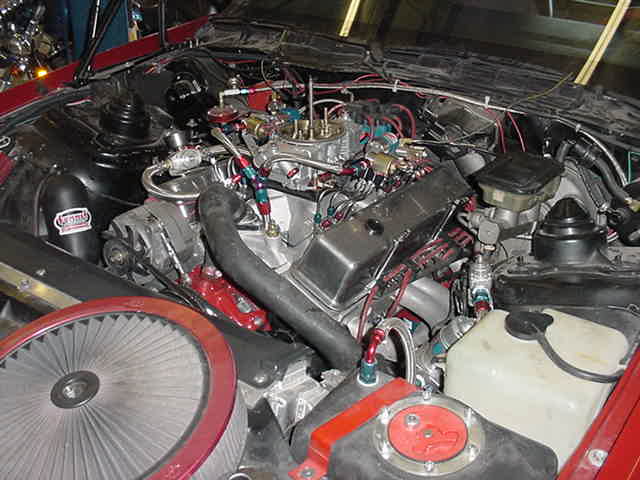

looks great, but why the 2 fittings on top? how are you going to mount it? on mine the hood clearance is REALLY close on the fittings as you can see in the pic. a sepreat cell is the only way to go for a big shot.(now that i've tried it both ways)

Automec - The 2 fittings on the top are a return line and a vent. I plan on mounting it on drivers side behind the headlight (in the area where the vapor cannister was). The cell is too tall right now so I am going to have to cut that tray out of there and sink the cell into the body. I will take pictures when I do the install.
