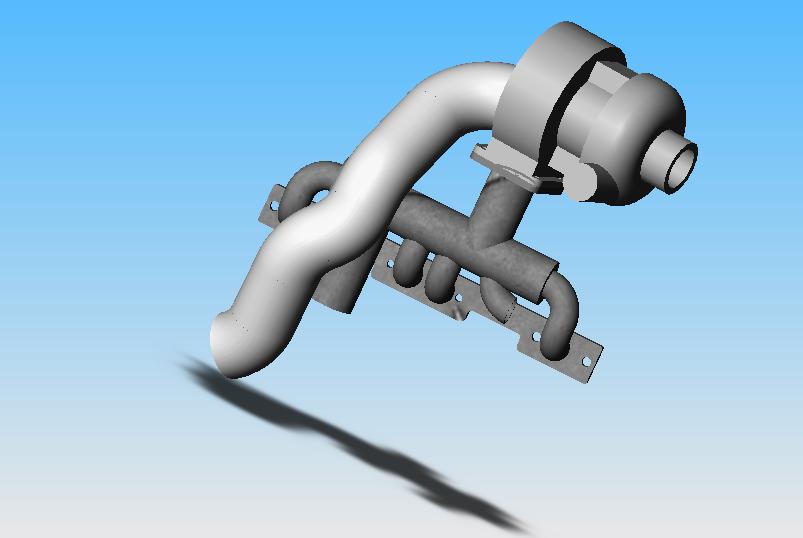

I am also a Mechanical engineering major this thread is right up my alley. I am a senior and am currently working on a single turbo set up for my 91 Z28. This is my senior design project. Here is a preliminary drawing of my design. I realized today that I need to revise my design due to the lack of space for the down pipe. Tell me what you guys think.

How about turbocharging the car now, and as your design project, plan for a few optimizations. Do CFD on various exhaust/intake designs, quantify how downpipe size affects backpressure/HP, and basically prove how you can engineer a system and have the numbers corrolate to the real world trials. Go Boston!

I see you're using Solidworks .... great software, I use it every day.
Anyways, the only suggestion I could give is trying to run the cross-over pipe in FRONT of the engine and coming straight up into the larger tube. This would give you more room for you downpipe and have a better flow path into the turbo.
Other that that it looks pretty good. Definatly use Cosmos floworks if you want to impress the professor. DON'T just flow your final design, do some prelim designs to show some comparisons.

Do you mean run the crossover pipe right into where the wastegate pipe is exiting? As far as the crossover pipe goes I don't see how to route it all the way accross the front of the motor due to space limitations. could you elaborate further? The primary goal with this project is to retain all of the stock accesories, this is also the most challenging. Thanks for the input

You should still be able to run the crossover infront of the k-member and steering, low and over up where the existing wastegate pipe is. The drivers side manifold could go straight towards the front of the car, then down, then over, then up. This will give you a lot more room for the downpipe seeing as it would be the only pipe between the engine and firewall.
Did you already measure your hood clearance? It's hard to tell from the render if the turbo is sitting too high for the hood. There are a few other examples for single turbos on this site, do a search and look for the paperclip

I have done a quick estimate of my height, Its probably too high, not a big deal to edit the feature. I like your idea about the crossover pipe I am going to look into that a little further. thanks for the advice.
