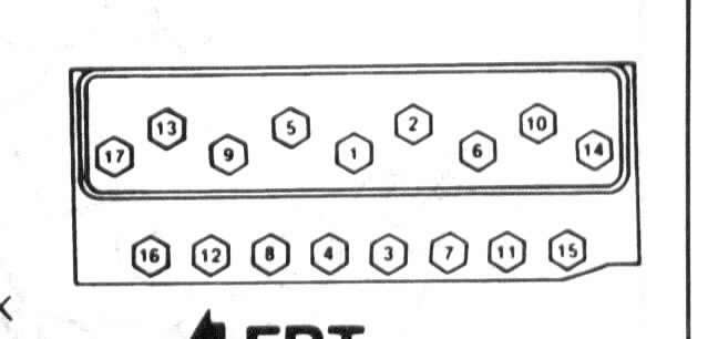

anybody know how to torque the head bolts on aluminum 350 pre -87 heads? I know the torque specs of 65 lbs, but not the pattern to torque them.. Do you have a link, i really want to get this thing running. -J

I don't have a torque pattern handy, but its pretty straight-forward. Start at the center bolts at tighten in an outward fashion. So like, the first center bolt in the head, then one to the left of center, one to the right of center, etc etc. I'm sure someone will chime in with the 'official' patterns that are printed, but they all are pretty much saying the same thing, just keep your count, and don't forget any.
here is something more important though:
tighten in steps, so if 65ft-lbs is the final torque, step in like hand tight, then 30ft-lbs, 45, then 65. try and step in equal-ish amount, but above all when closing in on the final torque, keep a nice even stroke, and get a smooth click or needle sweep on your wrench. so for instance, don't try torqueing to 62 ft lbs, then try to get to 65, since you will be fighting static friction breakaway torque and may tighten more than spec.
also, make sure you use some kind of thread sealer. myself, I use plain old ultra-black RTV, and never had a failure, but the 'correct' stuff is a dedicated thread sealant.

yeah, that's what i thought, but I heard something about a triangle pattern, starting in the center. anybody know? thansk -Justin

here you go

thank you very much! and that's for the pre-87 or pre centerbolt heads right? i appreciate it!
doesn't matter their all the same.
