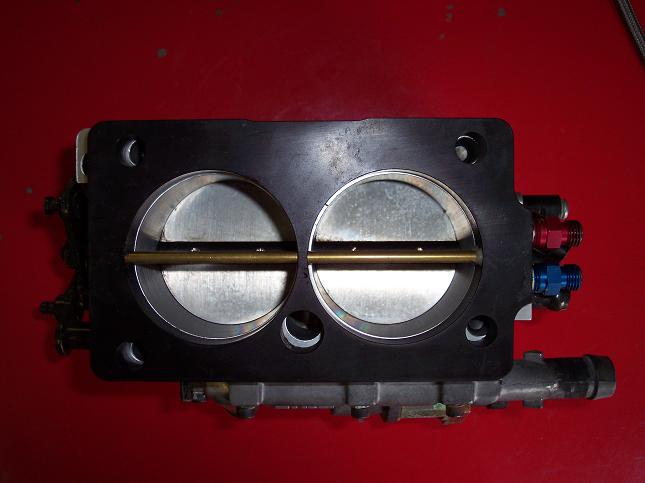

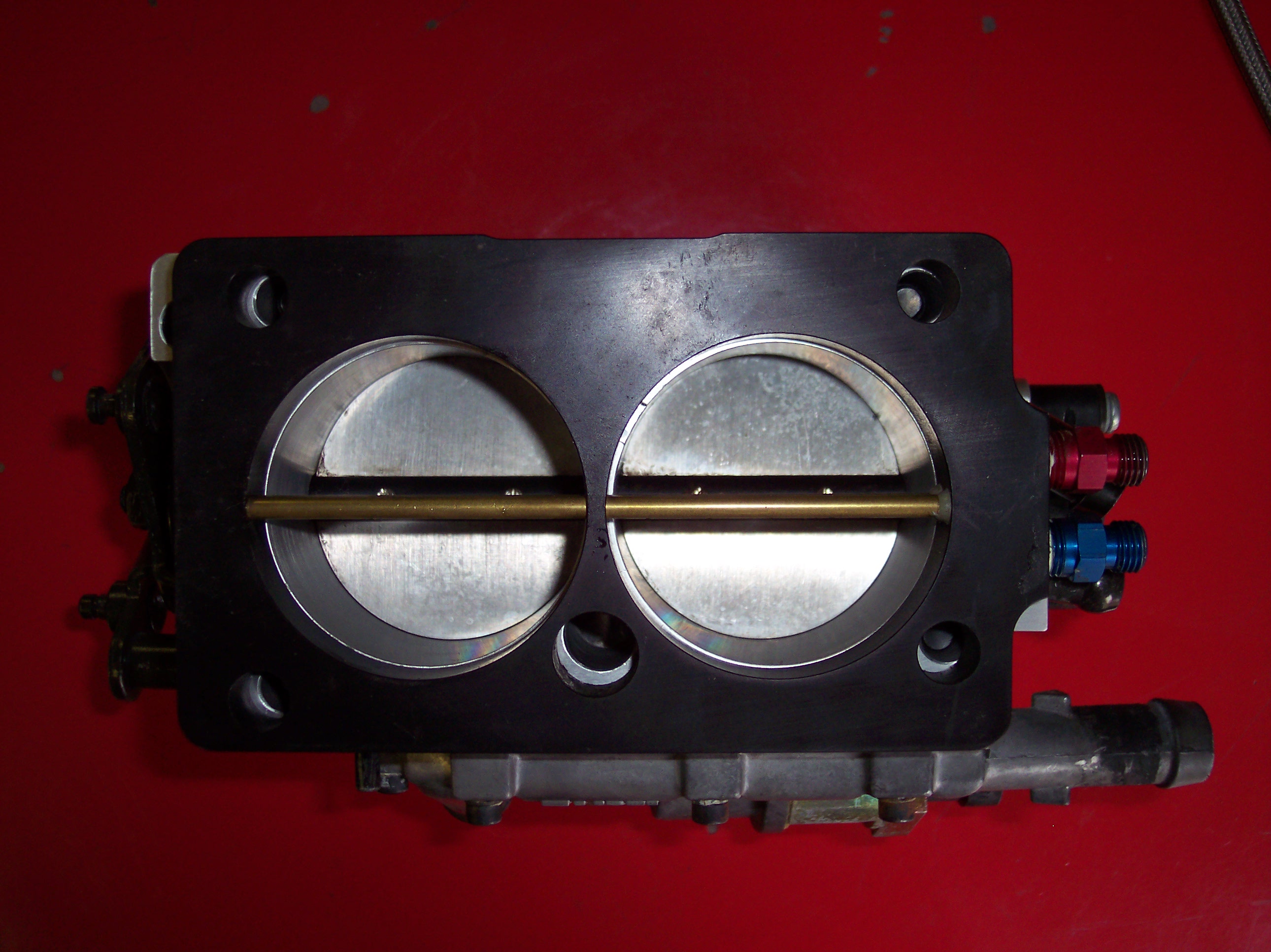

well the new ones dont have dual foggers, they have two spray bars with the same number and dimeter of holes as a NOS "cheater" plate.
the 5151 also have bores that measure 2.325" (59mm)
whereas 58mm (2.280") TB's actually have a bore diameter of 2.275"
here I checked My accel and my edelbrock 58mm TB's with a photo to help you see:
Accel 58mm w/5151
CLICK FOR GIGANTIC HUGENESS!
Edelbrock 58mm w/5151

Yes, thanks for the pics B4CTom1. I had never seen the bores on the plate with the bar - good to know.
