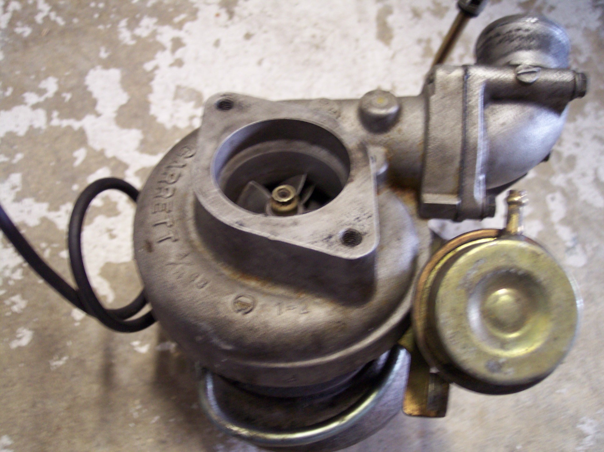

Ask and ye shall recieve...
The intake wheels measure 1.858/2.370 and that seems to give them a 60 trim.
The exhaust wheels measure 2.008/1.819.
The intakes housings are .48 and .63 exhaust.
They were being used in a 300ZXtt and came out of the Mitsubishi Eclipse Spyder.
The markings on the intake housings are:
A/R .48 1-2
The markings on the exhaust housings are:
.63 H4 on one side and 687 97J 272-2 on the other.
The tag on the bearing housing reads:
TJ 0190J
11411-40P04
466195-2
on one and:
SH 0447J
11411-40P01
466079-1
on the other.
Thanx for any help!

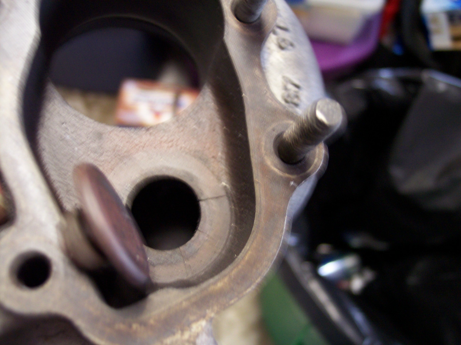

Dave, here is some pics of the cracks in the wastegate port I was telling you about...

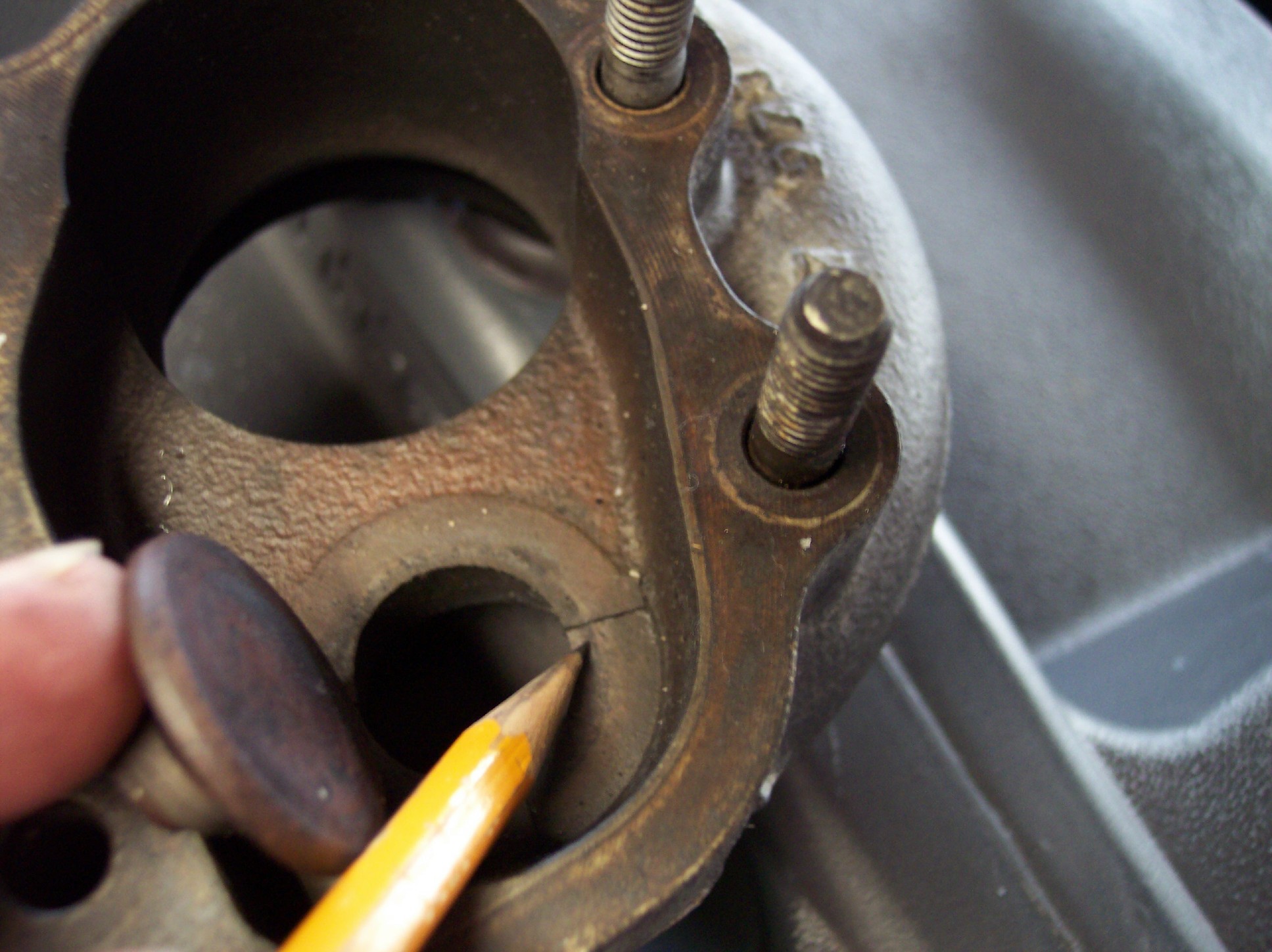

I used a pecil to point them out in case you couldn't see them in the picture...
