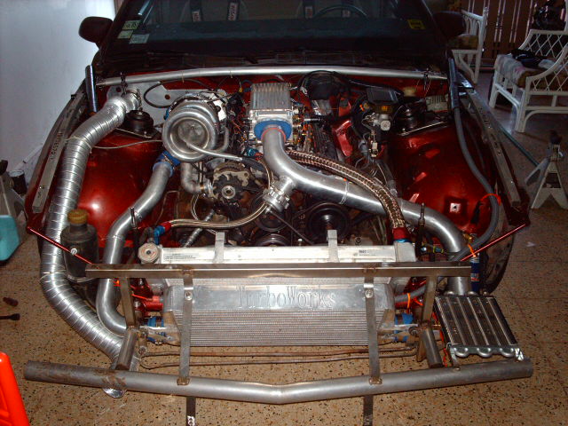

Now seriously I finally got the GTA up and running again. You all know that I first wanted to go quad turbo and I did, but the kit left no space for rutine checks like spark plugs and plug wires. I ended up trying to sell it but I end up keeping it, it's probbably going into a 1st gen Camaro for my wife.
About the GTA here are the stats;
418 wheel horsepower and 565 pounds of torque also on the wheels @15 of boost. Completely stock bottom end except for a Summit oil pump and with over 116,000 miles on the clock!!!
The car has been on a rigorous diet since I parked it about two years ago. It now sports complete fiberglass front end with custom hood, chopped front, Hawk's notchback, etc.. Rough guess race weight estimate is 3,100 pounds.
The car is very fast and I am finally happy, and with the current setup seems that is going to last long before it breaks apart the stock engine, hoping is soon because I have a new 4 bolt 360ci for it.
Well here are the pics, enjoy

More pics; suspension and engine

Answering to some questions before,
The turbo is a Turbonetics T-76 S.96 trim
The engine is seeing no more than 5500 rpms.
How long does the engine is going to last? I really dont know. It dosent seem that is going to die by too much power, but rather by "natural causes". The engine currently has no more than 4 psi of oil pressure at idle and maybe 35 psi at high rpms since it is a very seasoned engine and the bearings apparently have too much clearance by now. I do have a new block with all forged internals, H-beam rods and all the goodies, I'm just waiting for that old fart to blow up or seize until I get some parts missing and TIME needed to complete the new engine, so, I can't make the swap right now.
