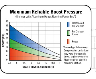

On an 8:1 blow-thru carb w/ aluminum heads you can safely get away with 12-14 lbs of boost w/ 93 octane.

12 to 14 lbs without an intercooler? is there like a point of diminishing return without an intercooler?

only if your limited by pump gas, but everything would benefit from intercooling/methanol injection

Here's Prochargers rough chart for determining safe boost levels with their head units.
