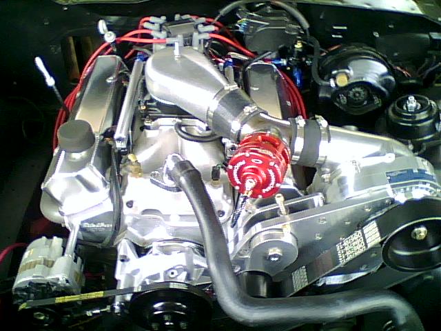

its finished.

A work of art, any numbers?

whats the thing on your intake?
Its a turbo? but the red thing.
Its a super charger and the red thing is a blow off valve.
Sure is purty! nice job

stupid me, used to the super sitting directly ontop. didn't know they had blow offs either. "yay for my V6 and lack of knowledge"....
Thank you.

No dyno yet, need to do some fuel upgrades to take full use of the engine, I estimate anywhere from 600-800 rwhp

One question from the peanut gallery here - how do you mate the carb hat to the carb? I'm just seeing the stud coming out of the carb, and the wingnut - but how do you get a good airtight seal there? Snug fit around the stud, and an o-ring or something?

my car has an o-ring around the carb hat and the carb

ah, ok. Customized the carb for the o-ring? Same with the hat?
What about the hole for the stud? o-ringed as well?

the hat has the o-ring provision, remember a proform carb has a smooth mating surface already for the o-ring to seal. The hole for the stud has a washer and is cut out slightly, that requires no gasket, etc.

where did you get that setup?? what brand of supercharger is that??? curious...cuz in the future i want to do something similar to my z28

the hardest part was running an intake elbow to the blower for my air filter, and my brake lines being in the way, im still working that out, as you can see from the pic, no master cylinder to be seen.

They make mini-master cylinders that will bolt up, but you'll most likely have to re-make / bend new hard lines.
