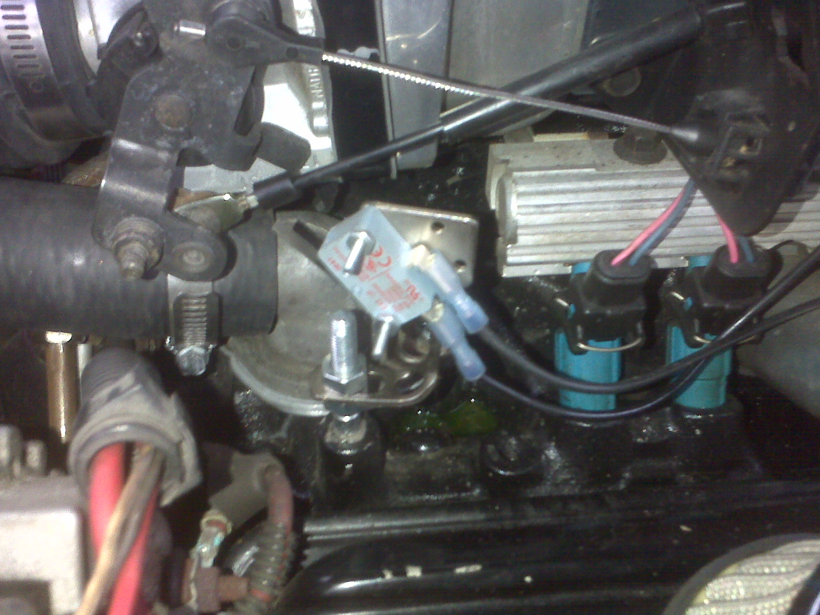

thought id show ya what i ended up doin. carb stud works great.

if you ever get a controller alot of them have WOT tps switches already in the box, just tap into the blue tps wire and read voltage at WOT

I used the HSW (harris speed works) LT1 throttle body bracket with switch. Its like 20 bucks and bolts to the bottom TB screw on TPI/LT1 style TB's. My holley throttle body wouldnt trigger the switch with the throttle linkage lever so i drilled a hole in the lever arm, and put a small screw so that it would trigger the switch at WOT.
