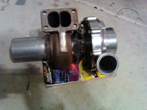

getting ready any input t70 rear mount
had this laying around for quit awhile now im goin to rear mount it no more then 10 lbs that should b good even got a little fmic to thro in snow inj then tune it up a bit shoult do good
getting ready any input t70 rear mount-006.jpg some one told about a twin scroll once so i got one

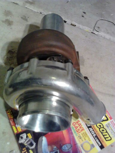

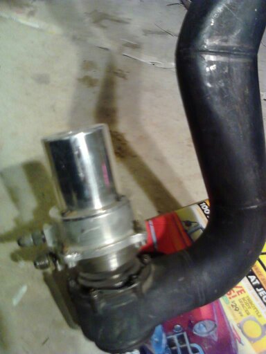

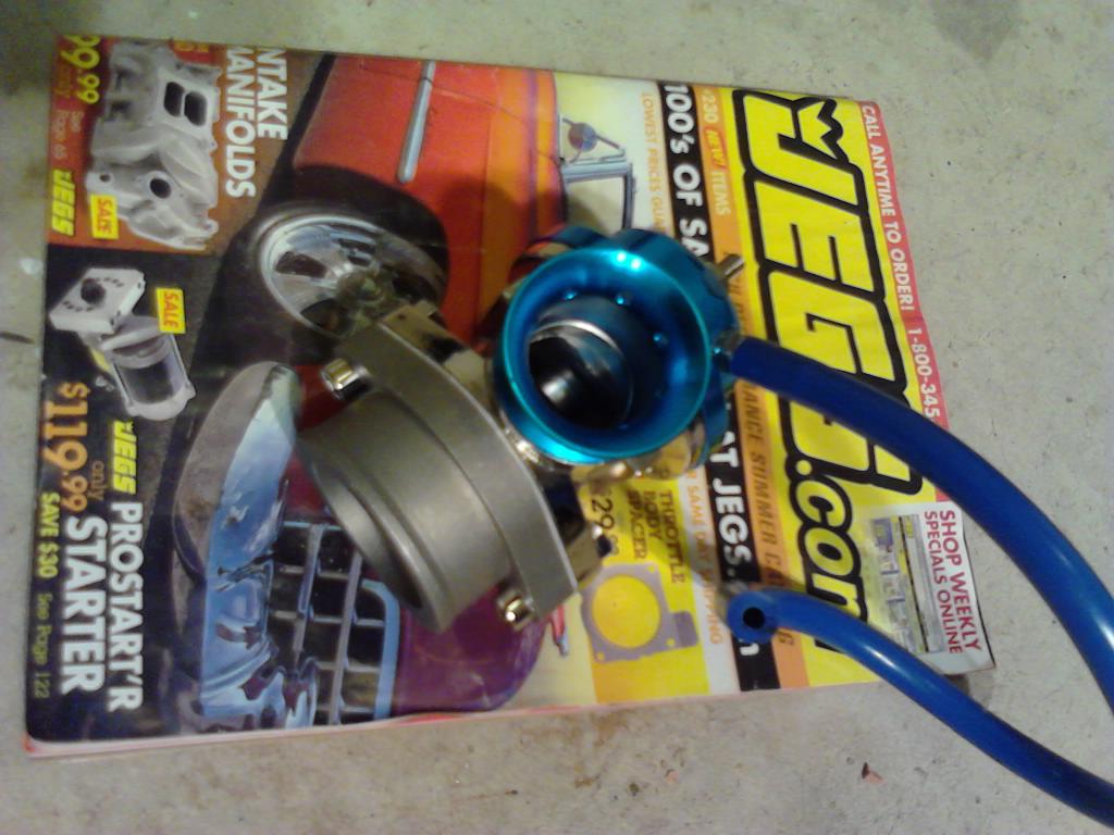

Dont really need twin scroll for a remote mount since you will likely be running 1 pipe to the turbo, from a ypipe in the factory location. Twin scroll is nice for pressure pulses from individual banks of exhaust tied into 1, like if you did a front mount and had left bank into 1 side of turbine and right bank into the other....or if you did twin turbo where you have some cylinders feed left side of the twin scroll, and other cylinders on oposite firing orders feed right side. Helps spool the turbo abit better. With all 8 into 1 pipe, you dont have alot of pressure pulses from firing order, so you could have just got a regular housing. No big deal tho, just thought I'd point that out.
Oil system, figure out how to get oil back there and then use a turbowerx scavenge pump to get it back to the pan. I plan to use a turbo werx pump on my car since my drains wont get back to the pan in a suitable angle.
Other than that, happy turboing. Make a mount for the turbo to bolt to, then run the exhaust into it so the turbo is supported by the car. Use a piece of flex pipe in the exhaust somewhere to allow for movement.
Getting cold side piping back to the front of the car is going to be the hardest part. Mainly for ground clearance issues. I think a single 2.5" to the front will work but seems like it would be pretty small for such a long run. 3" may be better but hard to say. 3" under car is alot harder to fit than 2.5" so thats a concern.
Theres more room to run it back up the stock exhaust location, but that will radiate heat onto the cold side piping, thus killing the effects of the cold charge. Intercooler up front would help that alot but that requires abit more plumbing.
