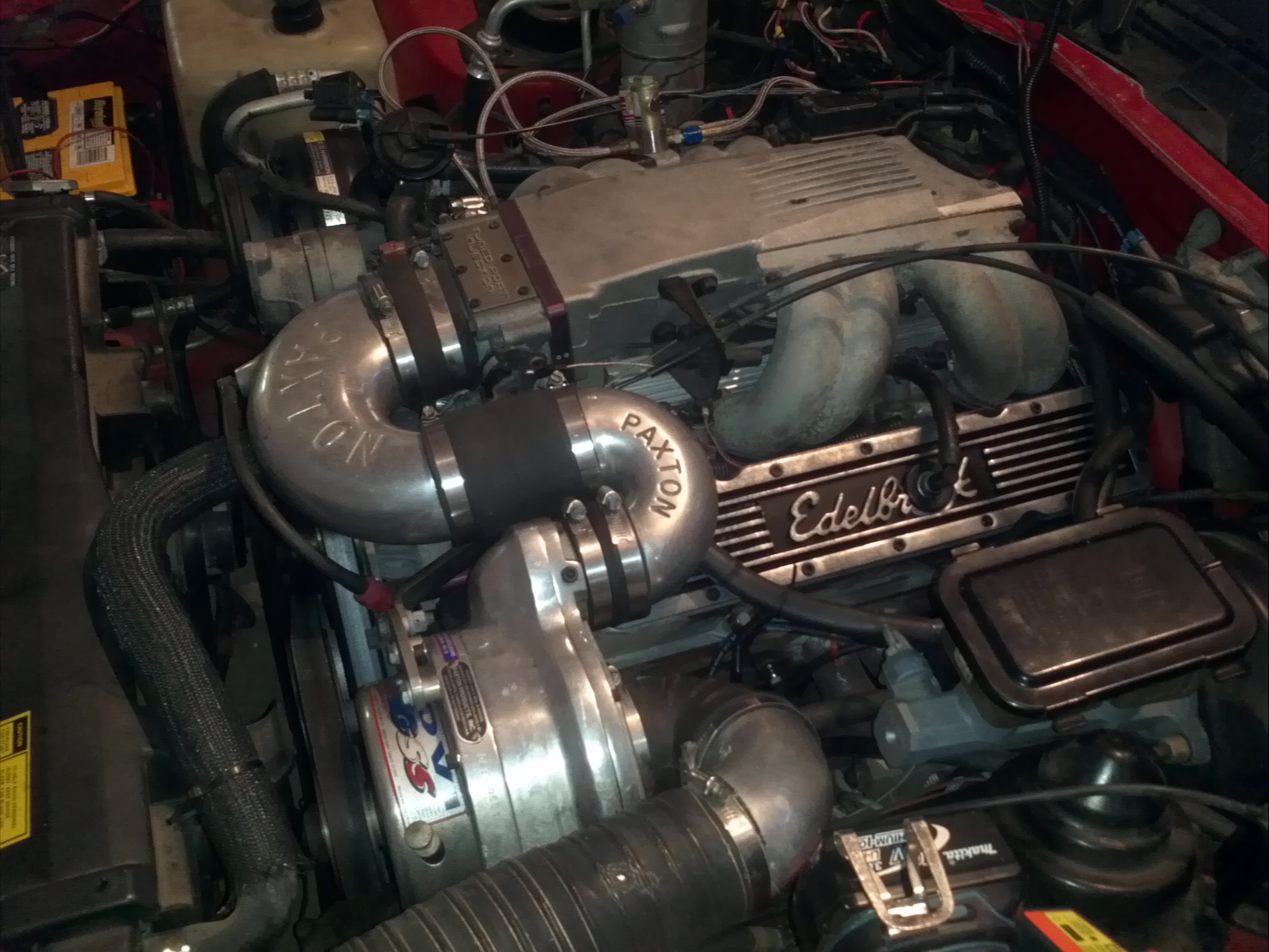

Hey everyone. New to the board and fuel injection so be nice if i ask stupid questions please!!
Here is what I have. Now i just bought this car a couple weeks ago and have been sorting out wiring issues, vacuum setup, oil leaks, header gasket leaks, tune up stuff. You know all the things that Previous Owners dont bother to pay enough attention to and just bandaid everything instead of doing it right the first time. well anyway what I have is a 383 that was built for a supercharger. Aluminum heads nice cam forged bottom end studded everything yada yada yada. Larger TPI runners, larger injectors and aftermarket rails, MSD 6BTM, paxton supercharger and NOS.
Now my question is What should i use for computer tuning? Ive been reading about the aftermarket computer from FAST and Holley and they will do the trick I think but what else is out there for an application like mine. Now keep in mind I have no tuning experience and everything ive read is greek to me but I can do wiring so im comfortable with that. This car is not an everyday driver but at least a weekend driver and maybe a few trips to the strip on test and tune night and what not. Maybe play with a few pony cars as well.
Thanks for any help in advance I appreciate it. Here is a motor pic. Not everything is in its place as im still trying to decide where everything should be and make all the wiring look decent. Sorry Its not as Pretty as yalls. Itll get there someday.

Then new Holley HP stuff is nice.
The cheapest is a stock ECM and some programming software and equipment. An ostrich ($175), memcal adapter ($35), and scan cable ($100) and you can tune with some free software. The big problem with stock stuff is you need 1 cable to program/flash, and 1 cable to scan/log. Which is cumbersome.
A little more expensive you can get a hybrid stock system, being the EBL from dynamicefi. This uses one cable to flash and log. The only down side to the EBL is it's a flash based system, meaning you cannot make minor changes and watch the direct impact of the change. I'm on the fence about this because I think the pro's of the EBL do outweigh this con, however it is still nice to dial things in while someone else is driving.
About the same price as the EBL is Gotech, which is a 100% aftermarket ECM. The software is not quite amazing yet, but the system has promise.
Megasquirt is just absolutely fantastic and in the $500-600 price range. If you pay extra or Tunerstudio, you have a system that is as good or better than the Holley, Fast, AEM setups. The downside to the Megasquirt is the wiring is a little goofy and the relay board is outright strange. Best bet is to tie in a factory wiring harness with relays (fan, fuel pump, etc) to the MS harness.
Then you have your $1500-3000 systems - fast, holley, aem, electromotive, professional products, etc.

What do you think is best for a complete novice when it comes to this tuning stuff?? I mean I can tune an engine with a carb by sound and smell and a few other tricks in my sleep but when it comes to all the values for this and that, that ive been reading about I go to sleep cause none of it makes sense. If i had the program in front of me it might make more sense but still would def take some time. I need to be able to retard the timing under boost and several other things according to some of the answers ive gotten on other posts. WHich right now is all done with seperate components so I have to admit that it all being handled by one controller does sound rather nice.
I read a bunch of dynamicefi stuff and wiring it up and putting it together would be easy. The programming and bin files and what not is what scares me. That and it sounded like it was more for v6's vs v8's. I need to look more into megasquirt and gotech i guess.
Hey here is a question. Can I get one of these programs for my 2012 Yukon so I can see what all is going on with it? Then mybeid have a better understanding of whats going into mine.
#1 Goal listed is easy to tune.
Need other goals:
1) what transmission?
2) what type of radiator fan(s)
3) any emissions (CCP, EGR, etc)
4) any extras (water/alky, N20, etc)
5) what size injectors and how many on what size engine (will drive SEFI sys possibly)
Sorry. Forgot to add this info.
1: TCI 700r4 with 3000 stall.
2: Stock radiator and fans. Relays hooked together to run as dual fans. Pretty much everything is stock except for drivetrain.
3: EGR but thats it.
4: Meth/water injection but needs a new pump at the moment. NOS and supercharger.
5: Not sure of the injector size. Can take a pic if itll help. I know them and the rails have been upgraded. The tpi runners were upgraded too.
6: Already has a MAP sensor so i think im good with the speed density setup portion.
I do have a question though. Do the aftermarket setups also control the speedometer and tach? Dont have a lockup converter so good there.
1990-1992 Camaro ECM with $59 code installed would work. HUGE learning curve violates your #1 goal. I am not a fan of the code. It takes a lot of fiddling to get it to work right, but some people love it.
I would go with the Meqasquirt 2 or even 3 if you wanted. That is lowest cost and easy to tune. All the high end Big3, FAST would also be easy to tune, but is more expensive.
MS 2 & 3, FAST, Big3 all will handle any type of injectors and will do the inj firing you may need.
I am a fan of stock GM ECMs, but I recommend MS 2 or 3, or the high end stuff. GM stuff takes a long time to learn to get right..........and the boost code is the hardest to deal with for most beginners. Just one person's opinion.

Does the car already have ALL the original wiring and 730 ECM still in it?
If so, EBL P4 may be your best choice in terms of ease of installation and tuning.
