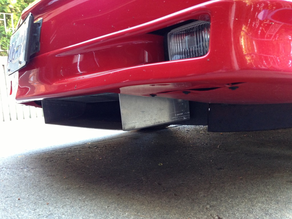

For the people that don't know what it looks like
I have a much bigger scoop on it now but this gives you a idea

Yeah I can't imagine sucking air up from the top of the header is helping. With my temps being at what they are do you believe there is much to be gained with lower temps? I've never really came across any good articles or what not on this topic.

With your intercooler mounted that way its not going to be as efficient. Mine is open to 140 mph air so it gets great flow.
But intercooler quality makes a huge difference to. Have you measured pressure drop? Local import shop tested a super high quality expensive air to air cooler on a 600 awhp evo againsts a cheap ebay cooler of same dimensions. Ebay one saw 60 deg or so temp rise on a dyno pull while the high quality one saw less than 6 deg rise! It was a drastic difference. Car with ebay cooler needed to dial back timing which ate up power.

Quite possible, that idea was running through my head though you think it would make much of a difference?
I'll have to taka a picture of my bigger air scoop, you would think it would be enough to direct more air in...

That does seem to fit in there nice... Though you have a formula and the nose doesn't sit as low as the T/A, you probably get better air through. Have you logged any temps at full boost with it yet?

I think you could use more airflow across the cooler but also curious what others are seeing for temps with coolers laying flat

It depends on the airflow. Straighter shot thats exposed to the most air should cool best. These cars are known as bottom feeders for the radiator air. That factory airdam brings flow up into that space between rad and nose and it works its way back thru via the fans. 4th gens even better with their laid back rads. With an intercooler in front that hurts air flow to rad because now fans have to pull thru that thickness. If cooler is to close to rad it will get heatsoaked even tho it gets better shot at fan pulled air.
So i think the best method is front mount vertical with direct flow from nose. This is easily done on camaros. Not so much a bird.
With the birds sideways could work with proper air dam/scoops, but i think a small fan mounted on backside would go a long way to help cool the cooler. If there is enough room to mount vertically, maybe try an air dam under the cooler as well as the factory one for the rad, and still try to place a small fan on backside of cooler to pass air back to rad since it may not get as much flow from the air dam area with the intercooler having its own airdam

I also did some measuring of my intercooler and space that I have available, my intercooler currently has a core dimensions of 6"x26.5"x3", overall about 11"x26.5"x3" if you don't count the weird shape of the feed and exit port. I have the space to fit 11.5"x33.5"x3.5" and could probably squeeze 12" wide if need be. Honestly the one I linked before that does 1000hp is not much bigger in dimensions though it is thicker, maybe something that draws the air crossways would be a better setup?
Have some more pics of my intercooler scoop setup

i just looked at tony's car domain page, i'm loving that pic of how that front end came up, looks like you were running slicks? what was your 60' time? have you dyno'd that combo yet?
Thanks man, I used to get 1.7 average and sometimes dip little lower, but no dyno results.
