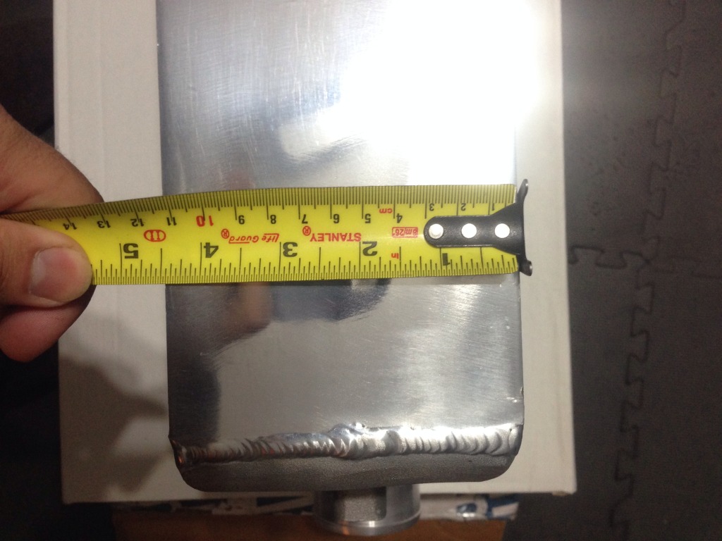

My new intercooler came the other day after a long back order and I must say this thing looks pretty good. I'll be updating this tread as time goes with the install and final testing. For now though I have some pics of the unit itself. I'll be trying to mount this thing straight up compared to my procharger intercooler that's mounted horizontal. I already removed the front triangle support bar that would get in my way when I did my cam change, hopefully it will fit right in.
Link to the intercooler http://www.treadstoneperformance.com...rcooler++860HP I got it from Modern Automotive Performance, and had it priced matched for $315 or so plus international shipping.
